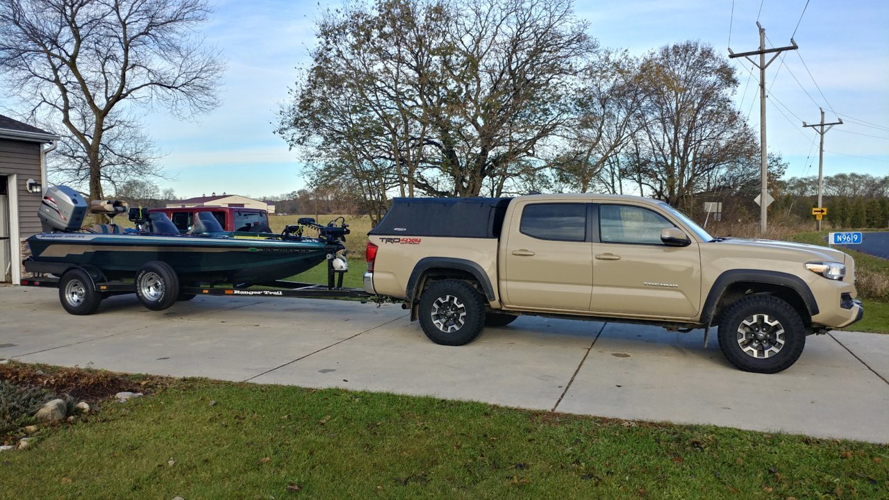

    Side to side, that is the constant feeling I have when driving over anything remotely bumpy. I understand as a truck it won't drive like a sports car but my '17 TRD off road with 80k on it feels like it's constantly in a state of body roll. I don't have much extra weight on it. Current setup is soft topper with a Uptop soft top truss rack over it. Going to be adding a up top Bravo rack on cab for carrying a RTT.
    I'm looking for a suggestions for my suspension. I do tow a boat and have no desire to raise my vehicle with a lift. I am considering adding airbags for towing but at this point really need to get the road manners better. Help?
