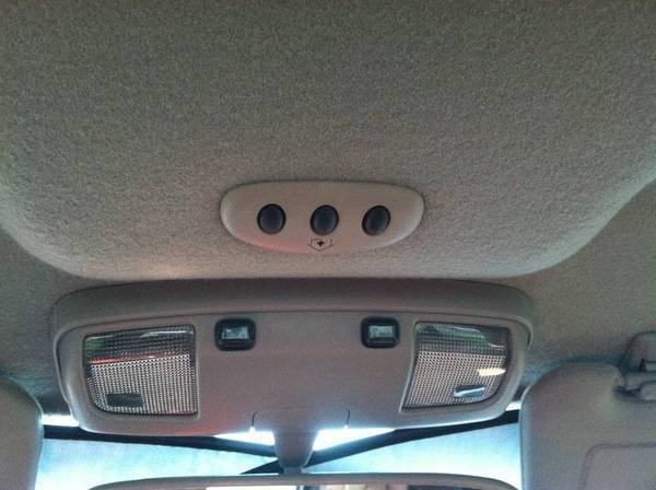

    I did what you want to do in my bike, it works really well, I hide the opener under the seat to protect it from water and have access to replace the battery.
    I don't think that a regular opener will work with 12v.
    That's why I used a homelink for my truck.
    Good luck

    I did the Homelink mod. There is a write up here somewhere. I'll be honest I was scared about this mod as it involves cutting the headliner. If you don't have steady hands I wouldn't go this route.

    X2. I've done this mod on two trucks now, my truck and my dad's 2013 tacoma. It is an AWESOME mod. costs about $30 and takes about an hour and a half (going slow).
    My only suggestion is to hook the homelink module up to the battery with some test leads before beginning installation to make sure it functions and is compatible with your garage door opener.

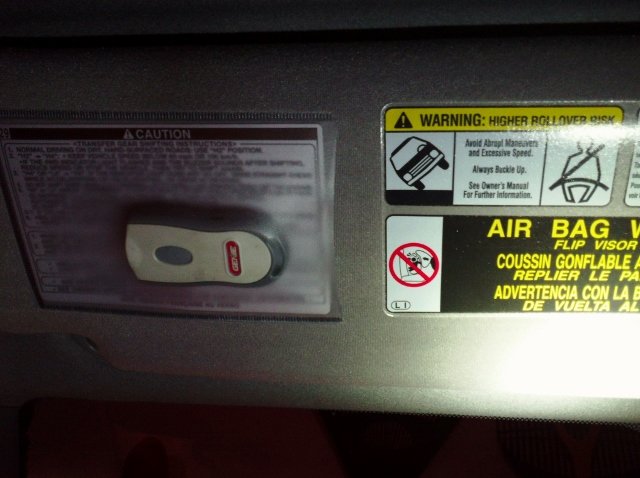

    I considered different ways to wire it up, velcro it up or otherwise hide it. Settled on this method and, although not sexy, works pretty well.

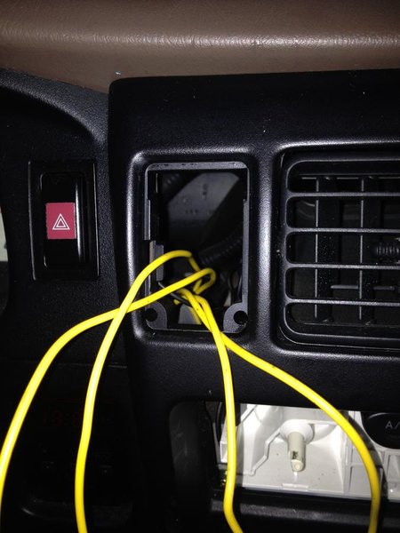

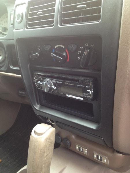

    ok so here is what i did....
  12. Mar 25, 2014 at 6:34 AM
    cadman33619
    cadman33619 [OP] Well-Known Member
    Dec 27, 2011
    #69432
    191

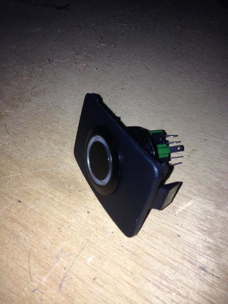

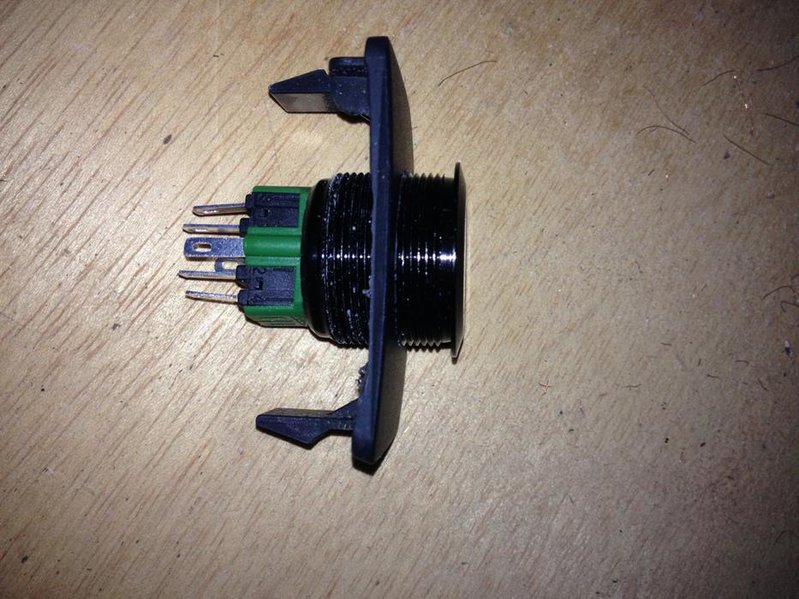

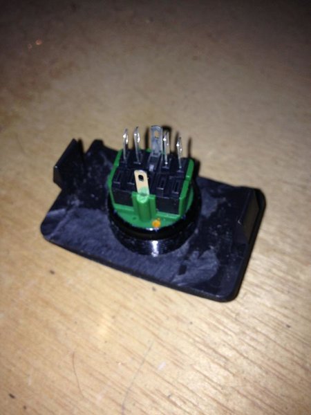

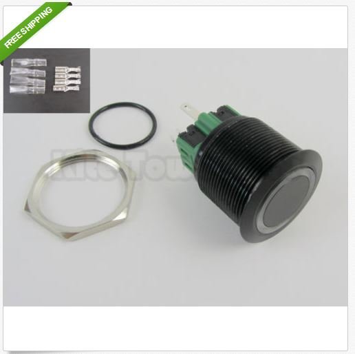

    i got this "momentary button" from ebay and installed it into the factory blank.
    its a little brighter than i expected but it matches perfectly.

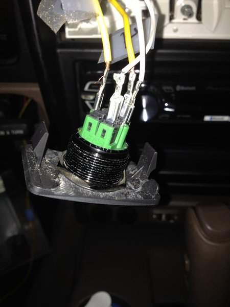

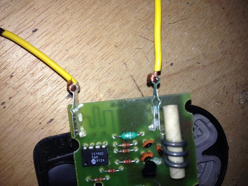

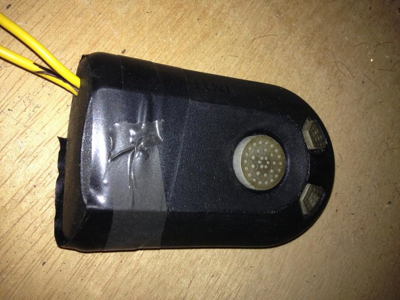

    i used an old garage door opener i had laying around. added a jumper to the 2 leads from the main open/close button (my soldering job is a bit sloppy)
    then attached wires from the pos/neg terminals and ran them to the button and fuse box (with an add-a-fuse) and to a ground point
    then i fished the wires thru the dash and connected them to the button and tossed the opener behind the dash so its hidden.

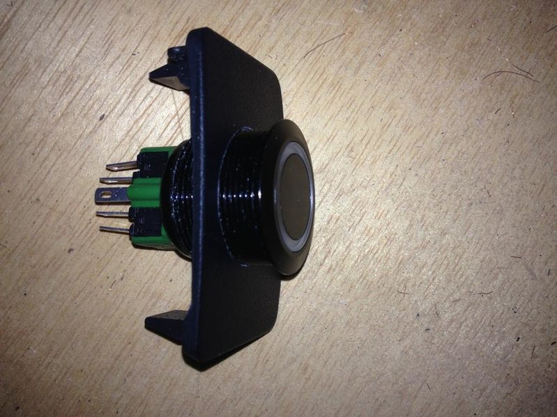

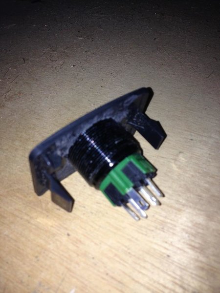

    i forgot to mention...I used a dremmel on the back of the factory blank to shave off the tabs so they would not be in the way when I drilled the hole.
  14. Mar 25, 2014 at 6:48 AM
    cadman33619
    Dec 27, 2011
    #69432
    191

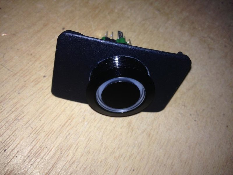

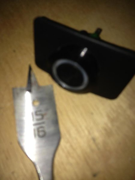

    the button size i chose is 25mm...which is just about the same as 15/16". and just happened to have a spade bit that same size. I used it to drill the hole in the factory blank (making sure to keep it centered). it was a little too snug so i used the spade bit again (by hand this time) to scrape the hole and make it a little wider so that the button easily twisted into the hole.

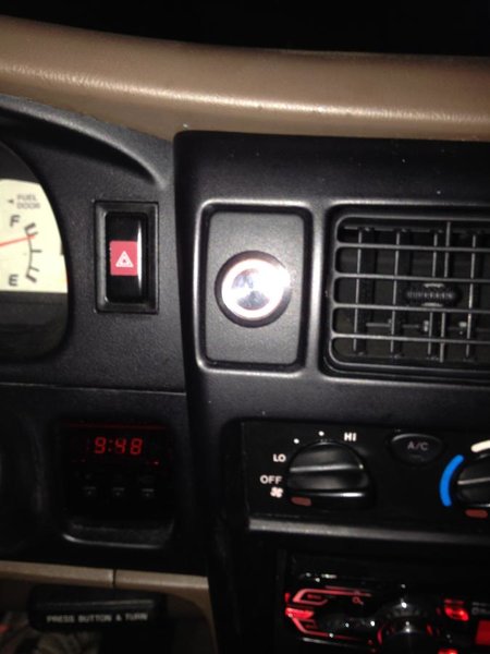

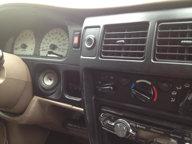

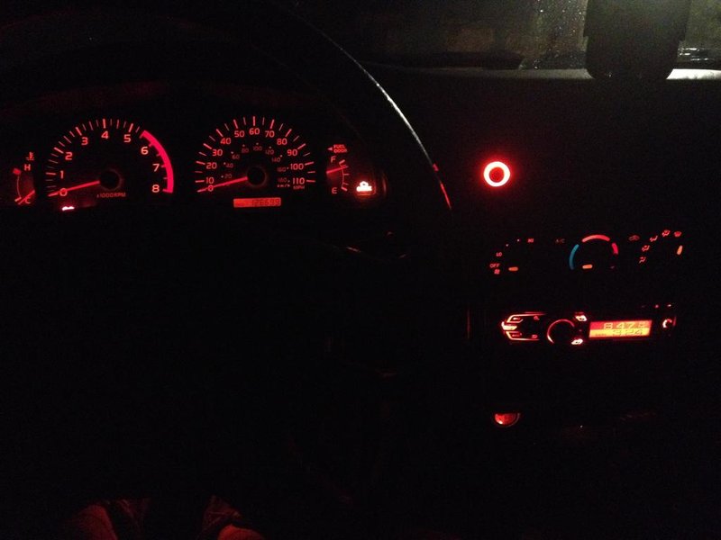

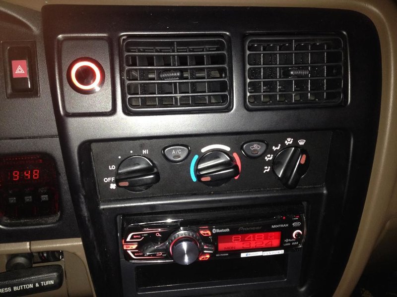

    it fit perfectly and works great.

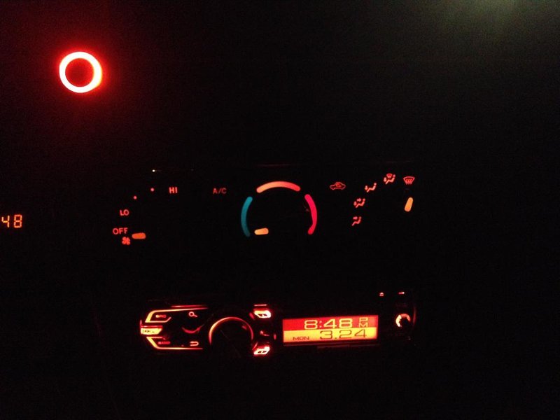

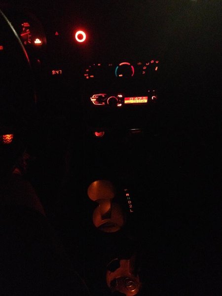

    the button comes in different LED colors...but like i said...its a little brighter then i expected and will take a little getting used to.

    i dont remember which circuit i used for the add-a-fuse, but its one that gets power only when you turn the key. then it lights up and can be used. I selected that one for security reasons....because i didnt want to be worried about someone being able to get into the house just by getting into the truck and pressing the button and walking right into the garage (although no one will even know what the button is for).
    hopefully this will give others ideas. i love the homelink install by El Tano and Zork above...but i had my heart set on a kool LED button in that very spot.
    heres a couple of daytime pics
