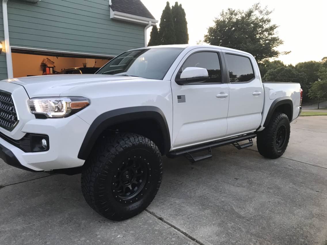

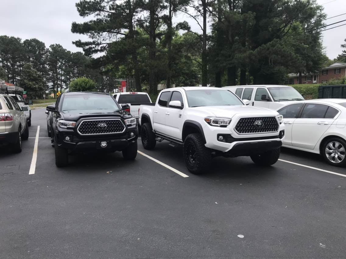

    wk4r2c_258c7d1055a5bb0d665ae6a123c09ab88368db37.jpg 106nblg_e2d32554591925cb3d116fb98b0799ee5b342a7f.jpg
    5100s w 887s and AAL, SPC UCAs, pic next to buddies Stock Taco for sh!t$ & giggles

    Best size tires to run w this setup? Using 17” wheels
  13. May 16, 2019 at 4:50 PM
    #73
    Caboyd79
    Caboyd79 Member
    Feb 17, 2019
    #283435
    24
    Jefferson, Ga
    19 DC TRD OR
    I’m running 285/70R17, I melted and cut plastic but still rub in reverse at full lock
    SoCali_Guy likes this.
  14. May 16, 2019 at 4:52 PM
    #74
    SoCali_Guy
    SoCali_Guy Well-Known Member
    May 20, 2018
    #254074
    802
    California
    TRD OFF ROAD
    Is it safer to go 275/70 17 w the Bilstein setup
  15. May 16, 2019 at 8:01 PM
    #75
    Caboyd79
    Caboyd79 Member
    Feb 17, 2019
    #283435
    24
    Jefferson, Ga
    19 DC TRD OR
    Prob would help but 265 is safest, I just love the look of the 285, I’m trying to find solutions, I may cnc and I’m looking into adding 1/4 or 1/2 spacer but don’t know that it will fix
