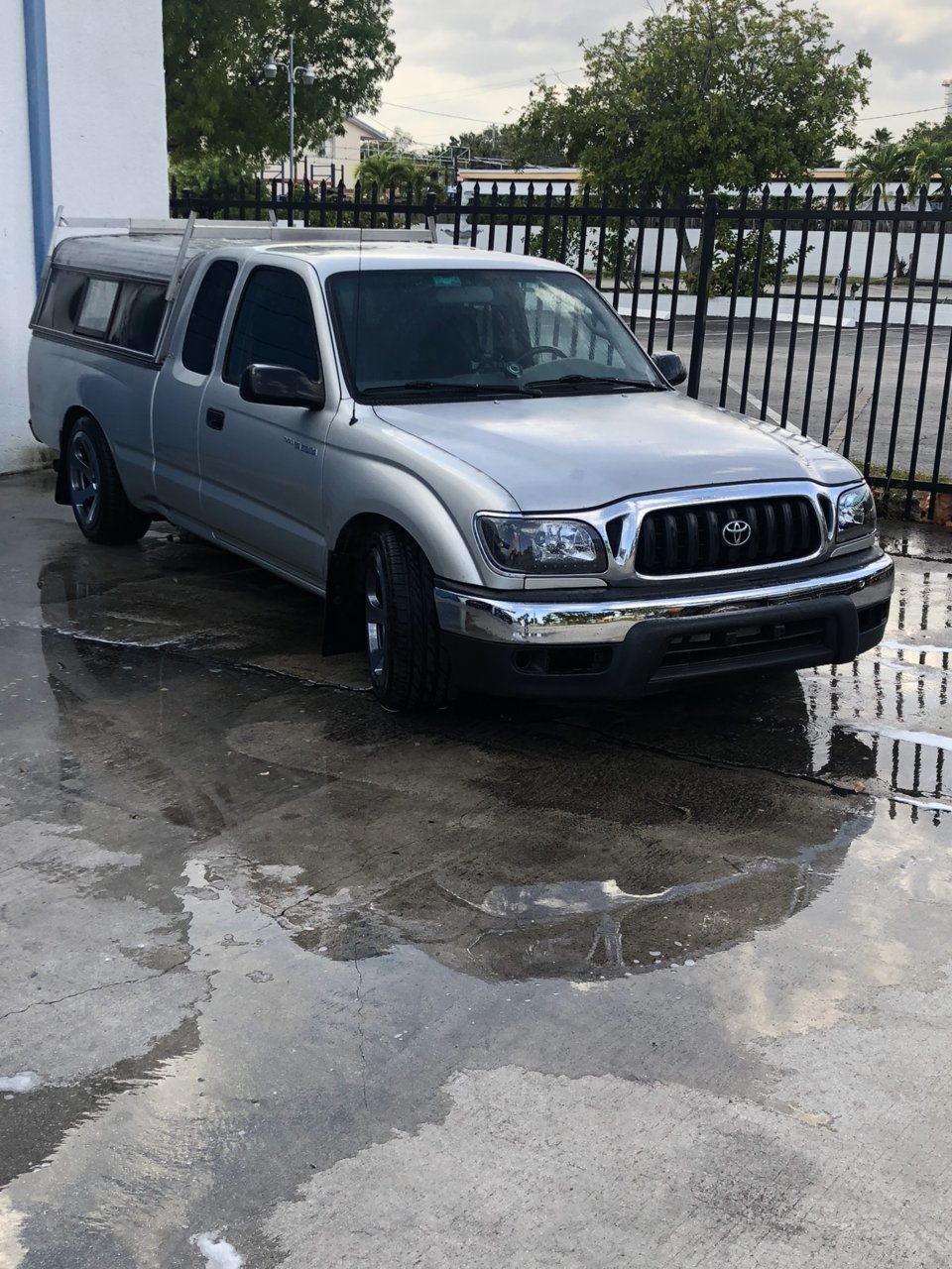

    Yes it’s a direct fit and no it doesn’t stick out like that on the 02 taco like on the old tacoDE77901A-7AF8-402C-B8FF-CA18D0E9302E.jpg

    On the old taco the bumper stuck out more because of the front end design fits just right for me and it bolted on with the original brackets

    Nice photo. What year is the bumper from? If I can score one not in chrome, this may be my direction.

    Bundle 99-02 4Runner Front Bumper Blk Face Bar Valance Signal Light W/Flare Hole https://www.amazon.com/dp/B014EUM6MQ/ref=cm_sw_r_cp_tai_qmsVCbSFVB9AX
    I bought mine in parts some from rock auto and some from Amazon. But here is the full black if you want but the chrome is a better deal on rock auto. And you don’t need to buy brackets your original brackets will work by just drilling two holes

    Wow! I do believe this is the route I'm taking very very soon! Will the two necessary holes I need to drilldbe pretty obvious and will I need some bolts for those holes?
    Thanks in advance! I really like this. Subtle and different. Just what I wanted .

    It will be kind of obvious,but when you remove your brackets from your original bumper it has a total of 4 nuts two on each side you going to reuse all of this the only difference is that on the 4Runner bumper the mount points for the bracket to the bumper are about a 1/2” wider so you can line up the bracket with the top hole and mark where the bottom hole needs to be and Drill! It’s pretty easy if you need any help at all just let me know!
