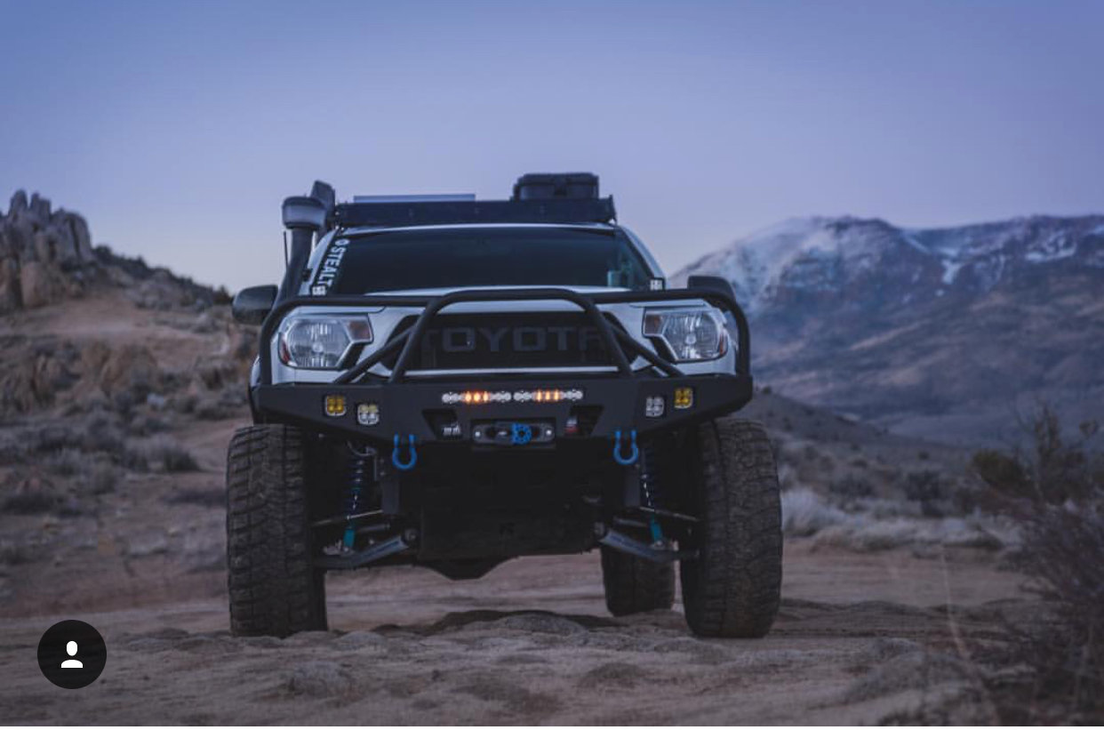

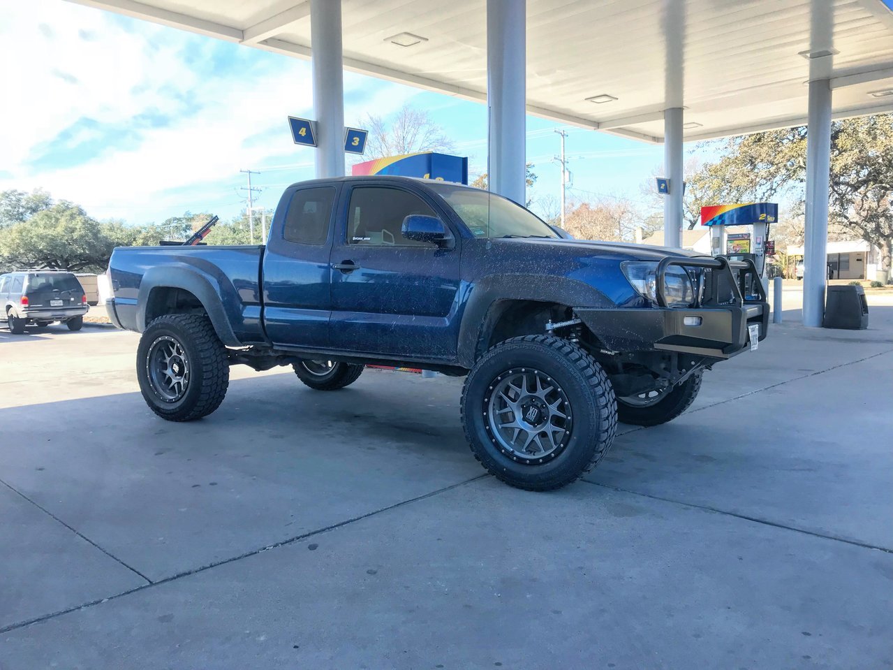

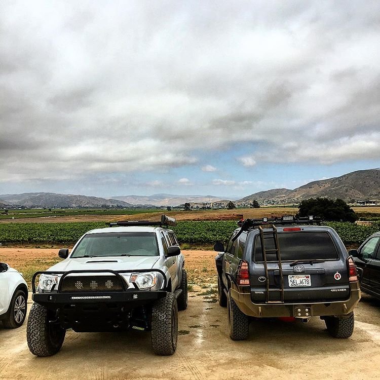

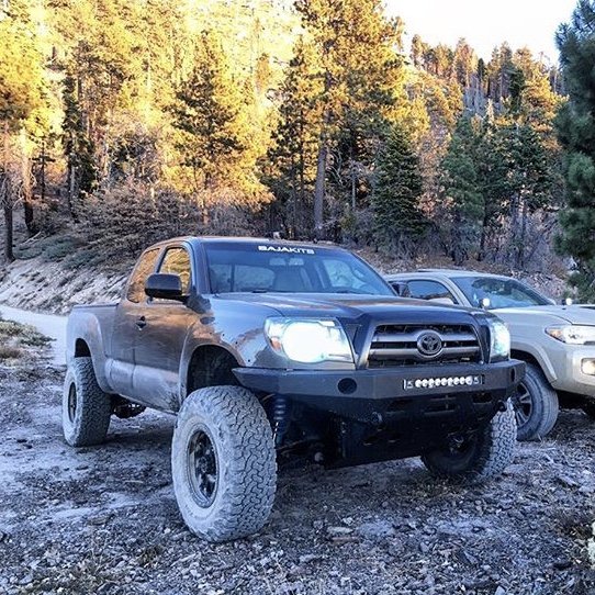

    There are plenty of people running +2 and no glass. Here’s a few examples and they are all running 35s...D4A2B321-0108-483A-B77D-0051A1592DD2.jpgE52983F8-5FB9-4593-93E3-4E5FE769C74A.jpg51D90384-4614-470F-9E21-74C776E427A2.jpg4FE8330D-168F-493B-B2A5-C402F2190884.jpg

    Look at the silver truck......that’s what a fender trim looks like. Mine are cut 2.5 inches
