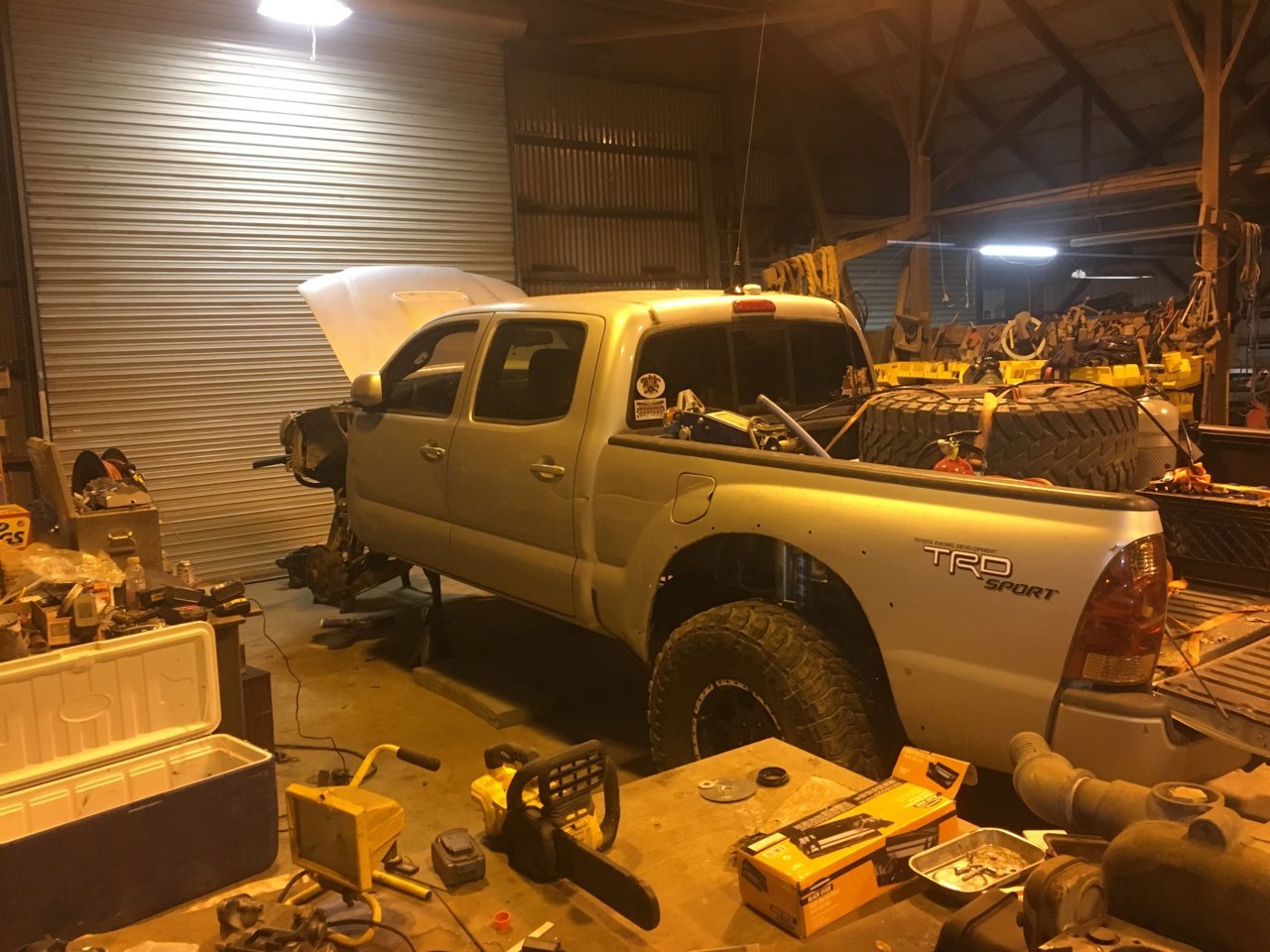

    They give discounts for build pics?

    How?
  11. Jan 27, 2019 at 3:58 PM
    #31
    taco_tallua
    taco_tallua MEGA-Known Member
    Nov 20, 2017
    #236530
    577
    Anaheim, CA
    2016 MEGA Toyota Tacoma
    I'm here for the memes
    Who is the silver truck?
    anthony250f[QUOTED] likes this.

    Yup that’s my mall crawler

    I like how you have the chainsaw ready and waiting just in case there's a need lol...
    Epic looking place to work on your rig!
