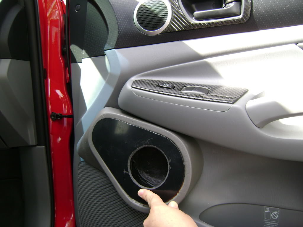

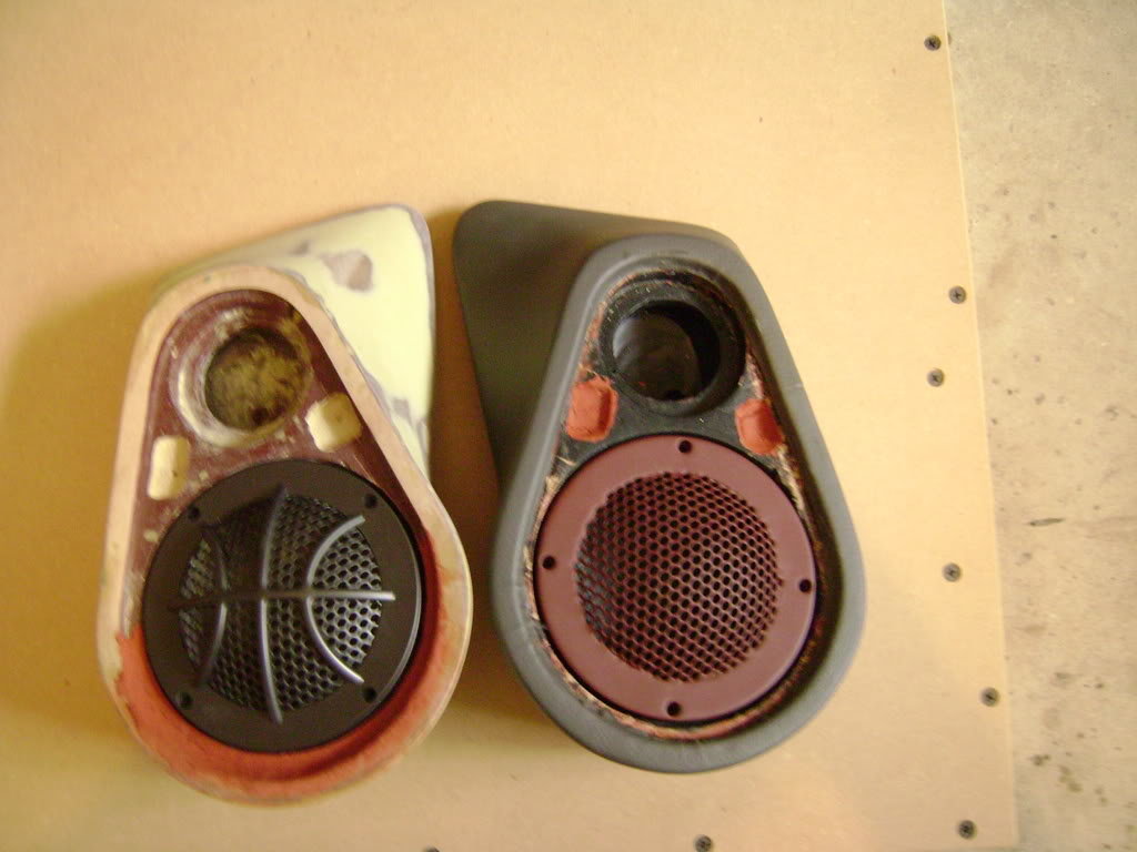

    Hey Marv,
    I still havent finished these yet (as I've been working on relocating my hazard/clock to the lower cubby, and installing my Audio Control three.1 in its place), but these are the pics I took last. Again, the finished face-plate will fit nicely, and wil be covered with the same carbon-fiber material that my X-SP was from the port. Superior Dash out of Daytona Beach is the company that provides the dash kits to Southeast Toyota. The pics dont do them justice, Ill take better ones after their mounted.
    There are others that have done similar style pods, although I went a litle further my building mine almost solid. I found a nice tutorial somewhere on TN (after mine were almost complete:() , Ill look later and see if I can find it.

    It took along time to align the speaker baffles so the speakers where aimed properly, and I believe with some RTA tuning will be able to achieve the sound Im looking for.
    I have a set of Q-forms kick-panels, as I originally planned on installing my mids & tweets in the kick, with the woofer in the door.
    I decided to go with the pods as I prefer the speakers closer together. Its easier to tune IMO, and everything blends better. Too much separation can sometimes lead to time-alignment issues etc. Just depends on your taste, as everyone is different.
    I also use my dead-pedal while driving, and didnt want to loose it for the kick.
    At 1 time, Marv and I were discussing the possibility of a baffle that could house the woofer & mid in the stock door location. Minor cutting of the door sheet metal would be required, but nothing severe. I liked the idea of everything hidden, but that left the tweeter up high in the stock location, which was too much separation for me.
    For the rear-fill, I have some Morel 6.5" coaxial (bi-ampable), as I didnt want to cut tweeter holes in the rear.
    Many people dont like rear-fill, but i had the extra 2-channels available on my 2nd Tru amp, and with the volume control knob on the three.1, adjustments can be made easily. They are nice to have with passengers, or at the drive-in, and I have no intentions on ever competing, so why not...lol... If I dont like them, a simple turn of an in-dash knob will silence them.

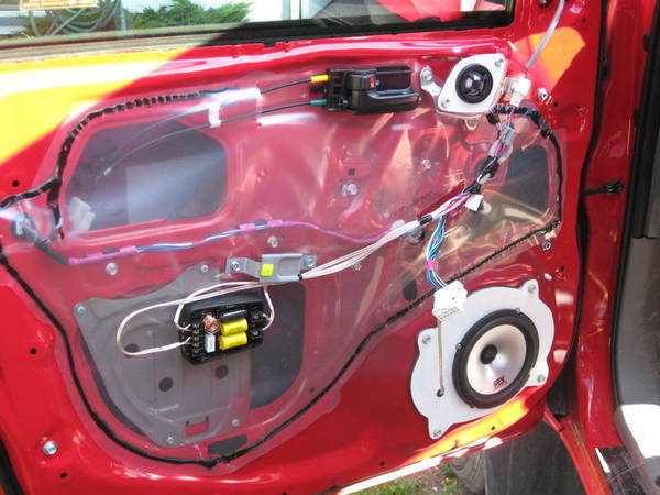

    I used this stuff to mount my speakers. It's called dibond It is like two sheets of really thick aluminum foil, with plastic squeezed between. works perfect for this application, you'd be able to find scraps at most sign shops. I like to keep everything looking nice and as stock as possible.
