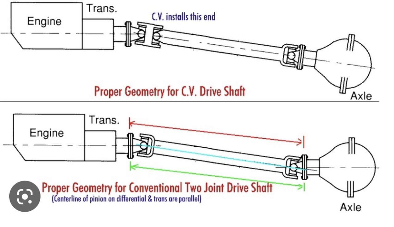

    It doesn't necessarily have to be straight for a 2-piece double cardan; which isn't ideal anyway. You got to have a little angle to spin the needle bearings.
    The front and rear angles just need to match and they will cancel each other.
    That's why I said 1-2 degrees on those... It would not require doing much, if anything with the carrier bearing position. To get zero working angle at the front u-joint would require a carrier bearing lift and make the working angles at the double cardan greater.

    the minute you make it a two piece and add that double cardan joint that is not true, the pinion angle required relates to that shaft going from the carrier bearing to the rear axle so if you have a double cardan on that section then the pinion must be lined up the shaft
  13. Mar 16, 2023 at 2:28 PM
    #33
    splitbolt
    splitbolt Voodoo Witch Doctor
    Mar 7, 2010
    #32761
    7,858
    NW Arkansas
    2016 TRD OFFROAD DCSB MGM

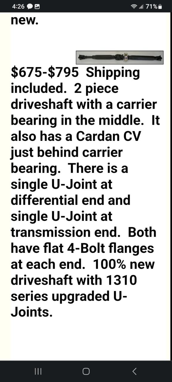

    If the double cardan is self-cancelling, what cancels the first working angle?
    Maybe, I'm wrong... Do you have any technical reference backing that up? I can trust what you're saying; I just need confirmation.
    BTW- here's a link to a place that does a 2 piece double cardan
    http://driveshaftspecialist.com/Import html/Toyota.html
