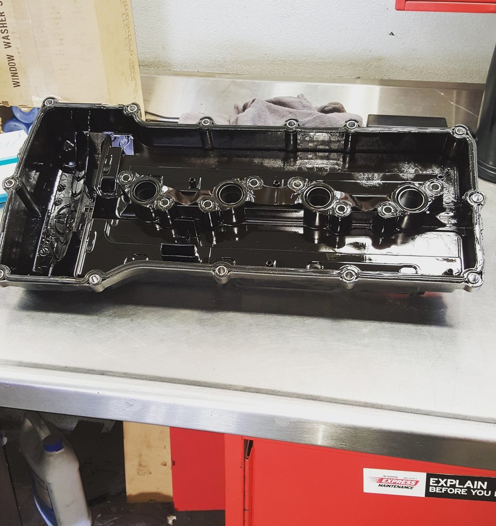

    136,500 miles. i get my oil changes at the local dealer and run whatever they put in. it's not as clean as it looks. i had a little short drive gunk build up on the oil cap and on the underside of the cover. a nice hot shower cleaned them up. hopefully long sat drives will keep it from coming back. 3 miles to the train station in sub single digit temps isn't the best thing for it.

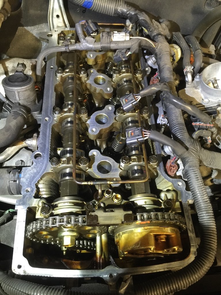

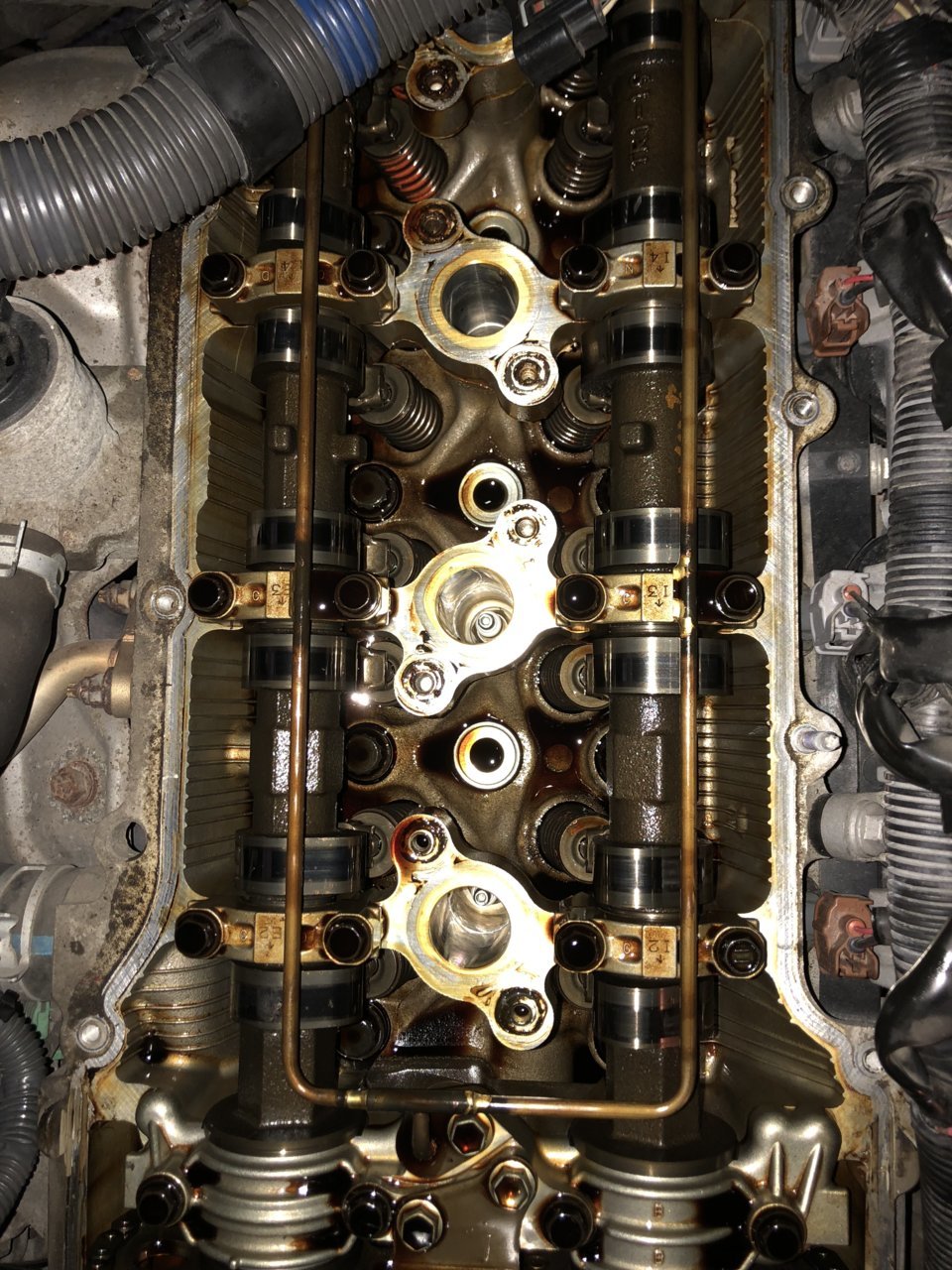

    0C3E8B07-B214-490C-90A8-E9DB4F973011.jpg Lol and here is mine
    Pretty happy with the lack of sludge!!!!
    Seems they could have spared some extra wire on the looms shit that’s tight.
    Time to clean and put this back together I’m about 40 minutes deep as of now. But I’m not rushing. Been along winter.
    Took me about 2-3 hrs. But I didn’t rush and ran around the bolts a good 3 times. Lol also used the kitchen sink and the wife’s scrubby thing to clean oil from outside of cover.
