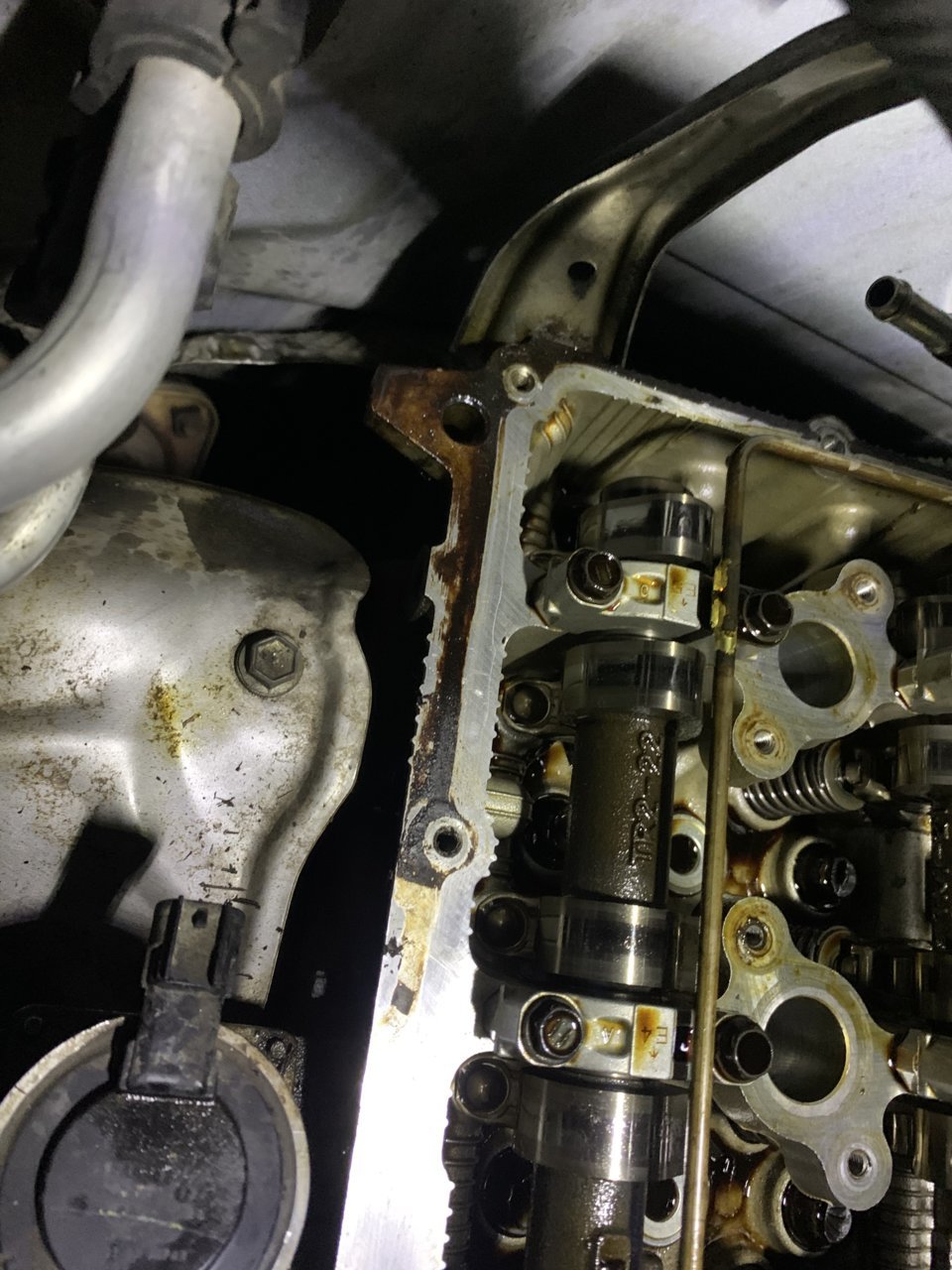

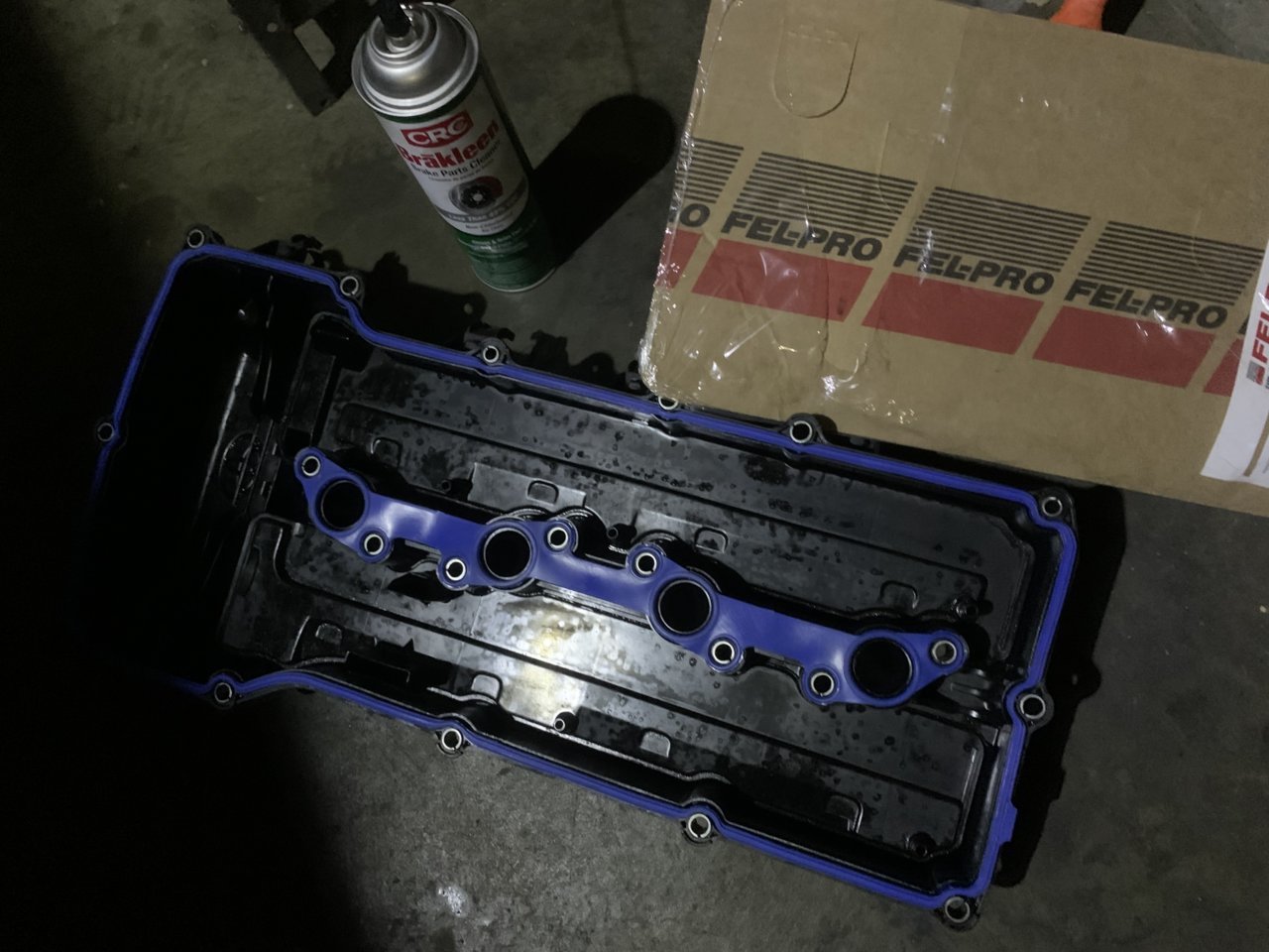

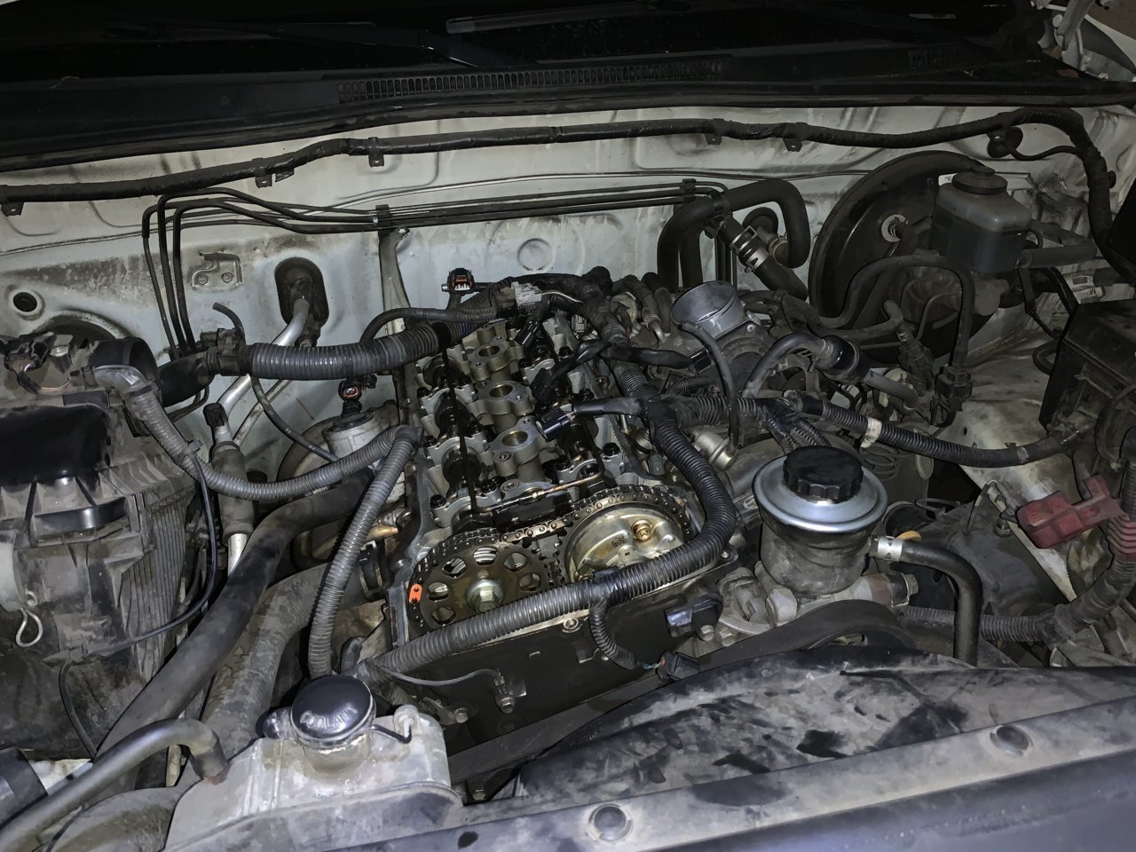

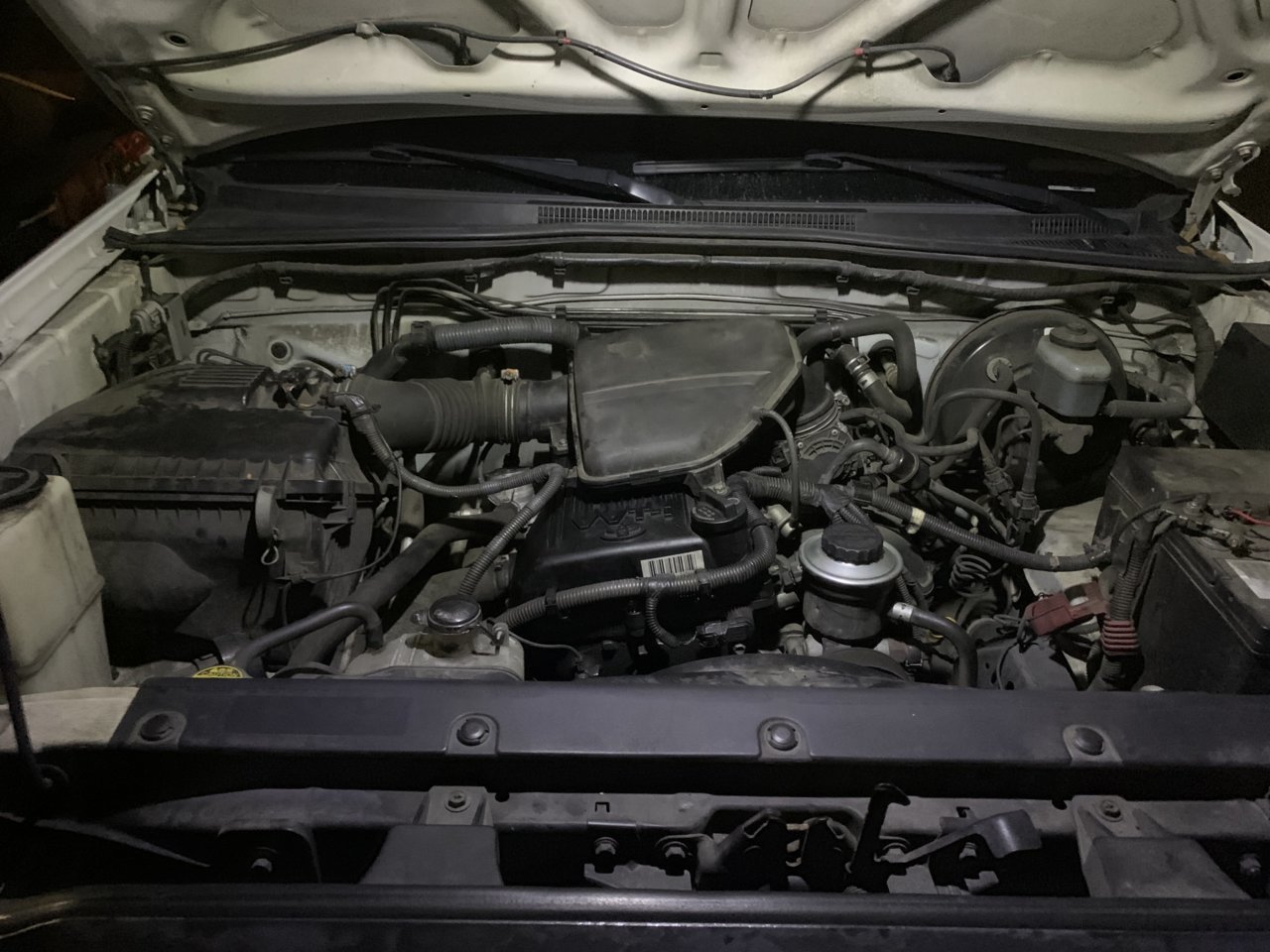

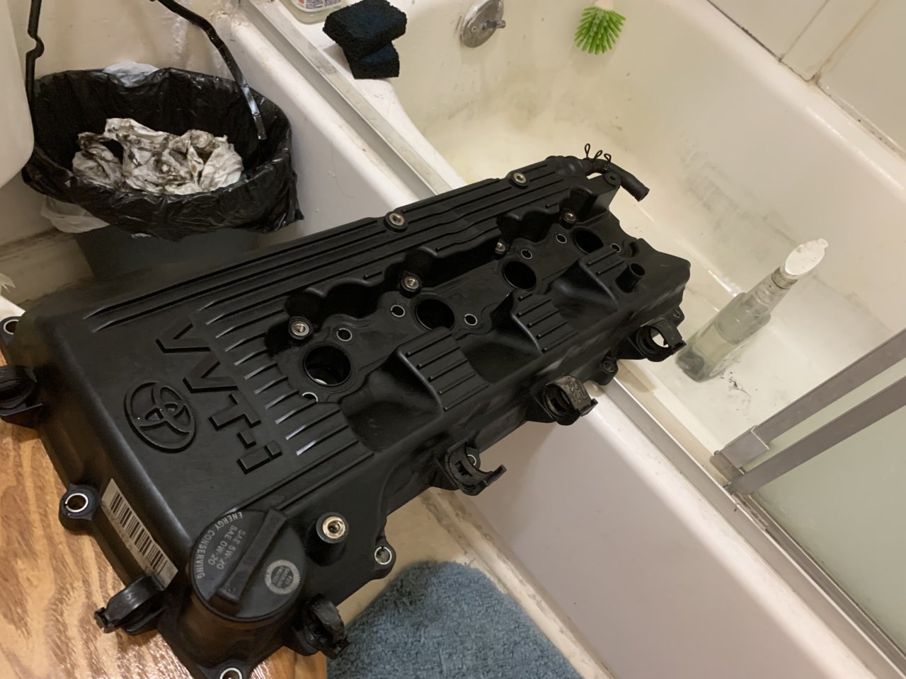

    For my go at it, I pretty much followed this video:
    https://m.youtube.com/watch?v=Fzm_W5PUCbI
    I did his “get the bolts to snug, then 1/4 turn” but maybe went a touch less than 1/4 on them. Resistance felt good and saved a bit of time on busting out the torque wrench.
    How to make your wife mad:
    Felpro Set worked nice:
    The scene of the crime:
    Look at that valve cover stand out from all the dirt:
    I heard a pop on the first bolt I snugged down near the spark plug tubes and I know what it is - there’s little parts around the spark plug bolt tube holes that hug the outside of the metal flange. I believe it’s just the plastic valve cover being pulled off of the top of the flange to the outside where it wants to be positioned. Didn’t do the PCV since I don’t know where it was after waiting to do this job for 2 years (and 30k miles later lol). Nice you can do it without removing them even if it takes some time. I blew through mine and it was ok at 180k miles. I also didn’t unbolt the metal tube that goes to the PCV and could sneak a wobble tip extension between it and the valve cover.
    Edit:
    So I got a leak the next day from not cleaning the head surface enough. I went to town and got it all shiny and so far so good. You can see the difference from the cleaner portion to the not so clean portion:
