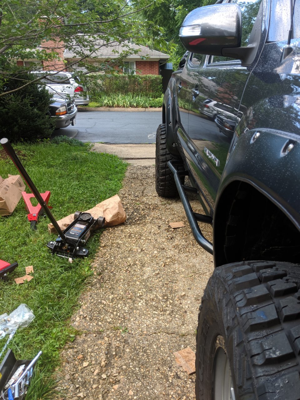

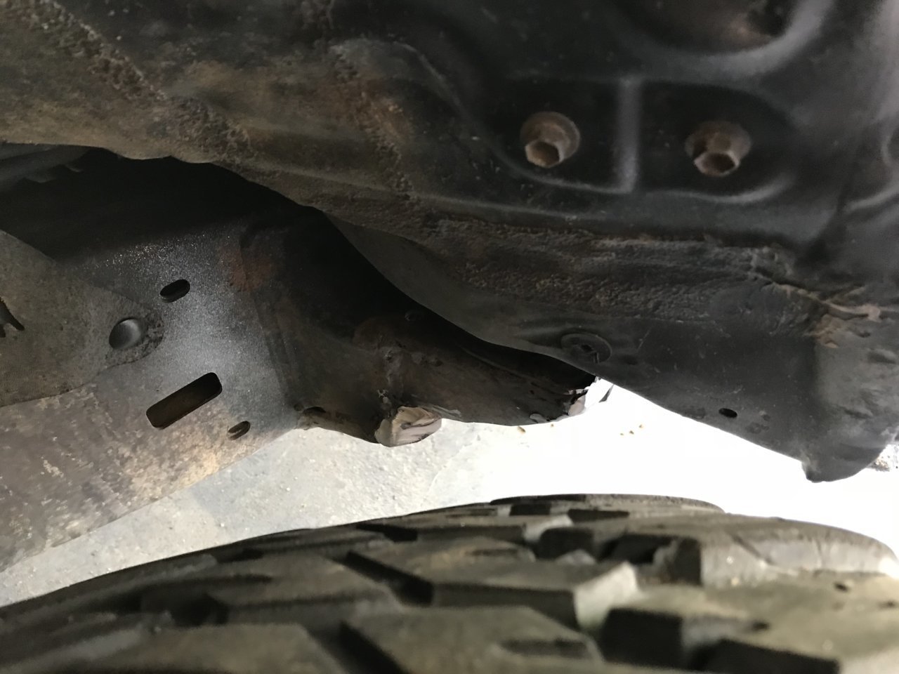

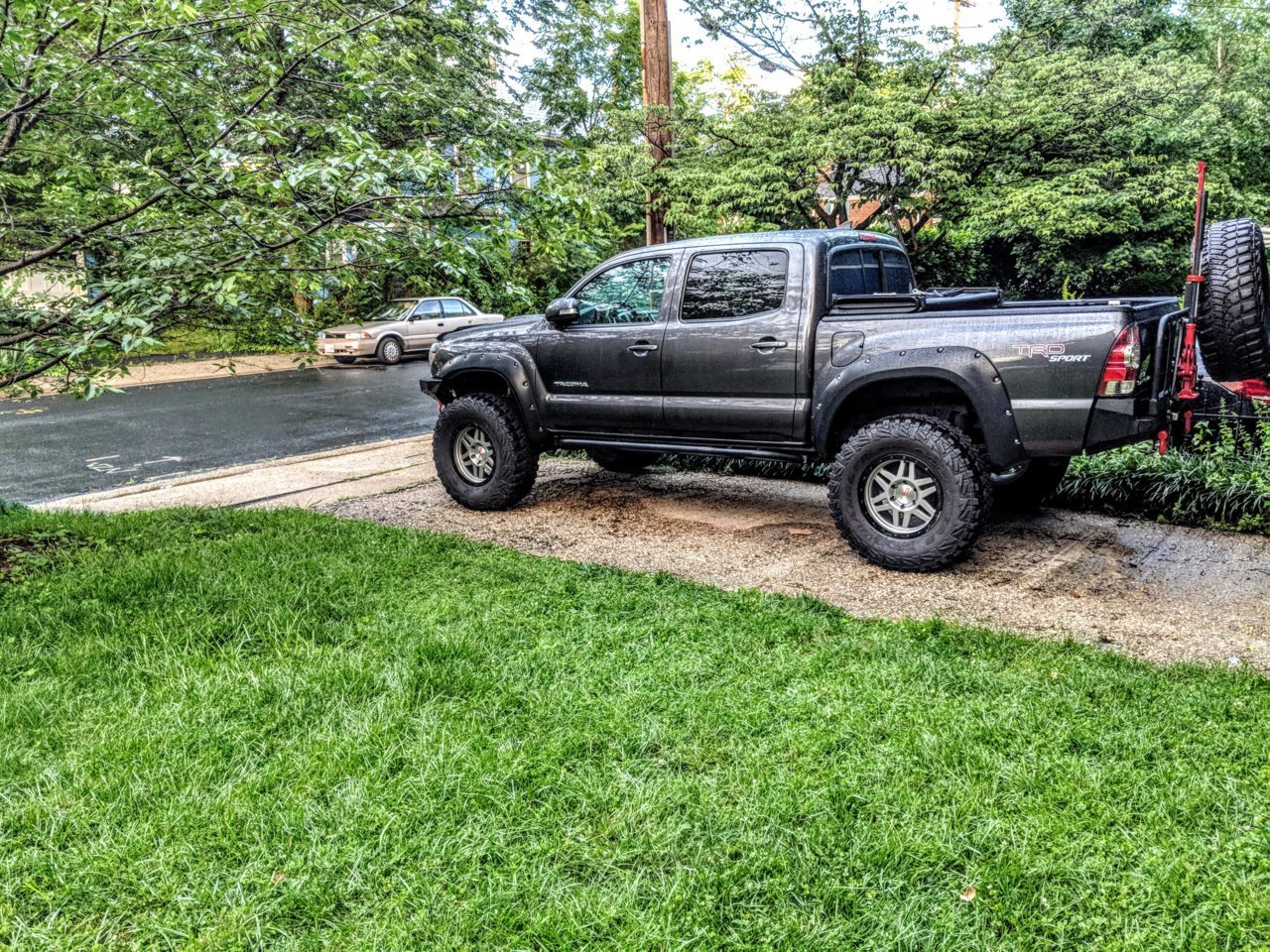

    I did all that except regearing. I have a v6 auto, and it runs ok for me. I commute 95% on a bike, so it's not a big deal for me. If you drive a lot people consider it pretty important. For the trimming I did about 1.5 inches on the front fenders, trimmed a big chunk of the flare in the front of the rear wheel well (but not the fender at all) and hammer pinch weld for days. I'm also running a 1-inch body lift (toytec) which made a HUGE difference. Some don't like body lifts; but I've had it for 1.5 years and no problems so far. BUT, you'll need to modify any armour you already have, or it will sit 1 inch too low (since).
    It looks like you have stock wheels, which is probably fine, but some advise you use a wider wheel with a much more aggressive offset. I ran stock TRD sport wheels with 35s for a while and it was fine. I had 2.5-inch spacers back then. Again, something people frown on. Now I'm running 17X8.5 -10 offset, approx. 4.30 BS (VTX Vipers) and 1.5 inch spacers (spidertrax). Without the spacers they rubbed bad on my JBA UCAs and cab mount. With the spacers, it's only slightly on the cab mount, and that's with a pretty aggressive chop (chopped, plated, then hammered inward - it's so ugly I'm almost embarrassed to show it) and 3.0 caster. It's going to be a squeeze no matter what unless you go with a cab mount relocate.
    For the lift - Front: Icon extended travel at 2.75 and JBA UCA, Rear: TSB leaf, toytec AAL, 1.5 inch block, Bilstein 5125s for 3-4 inch lift.
    Pics are below. Ignore the mess, I was installing sliders. I hope that helps.
