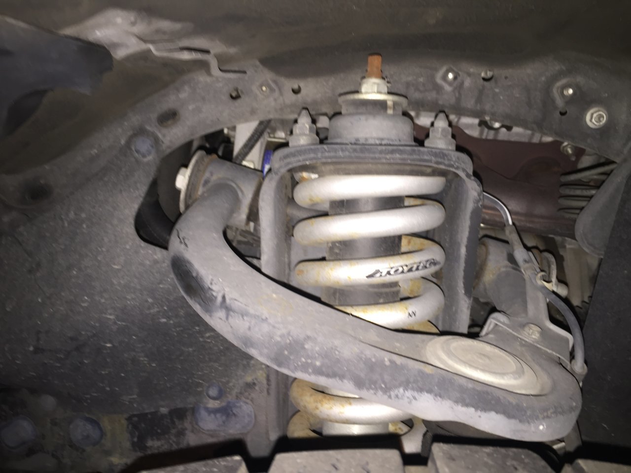

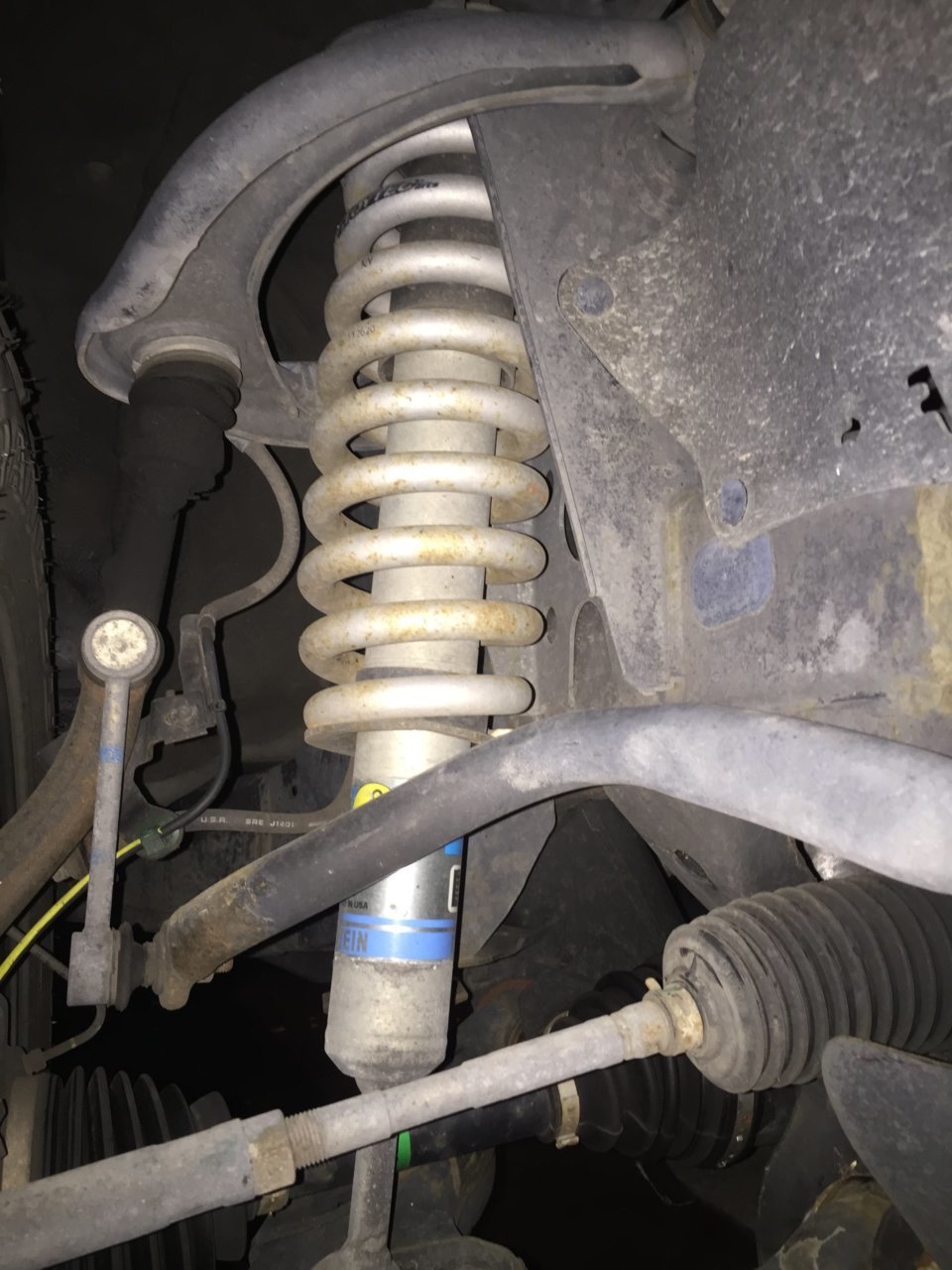

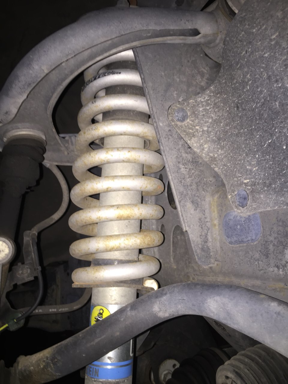

    are these the 5100’s? I cant imagine this is set to 1.75”. Looks more like 2.5” to me but it also looks like theres another notch right above the spring perch/ seat maybe? Possibly 5100 with a stiffer spring?

    Thats what they look like. I believe the Toytec coil set at zero on the 5100 gives 2.5-3” of lift.

    Those are the 620 springs! Because you have an AC, maybe its set on the first C clip 1.5"? :notsure: Hope this helps!
    From Toytec's BK0510 Kit:
    BK0510 - Bilstein Adjustable lift kit with 5100 shocks
    1.5" or 3" lift kit with Toytec/Eibach front coils
    Front:
    24-239370/C477 - Bilstein 5100 series front shocks
    TP14 spacer for correction of drivers side lean
    112-620 Toytec/Eibach front coil springs 620lb spring rate
    Fitment Notes:
    Standard cab and 4cyl models should use the Lowest C Clip setting - DO NOT EXCEED THIS SETTING OR DAMAGE CAN OCCUR
    Double cab models may require top plate spacers for full 3" lift
    Double Cab/Access Cab: 3" average lift is achieved with coils and setting the shock adjustment on the second C clip setting from the bottom
