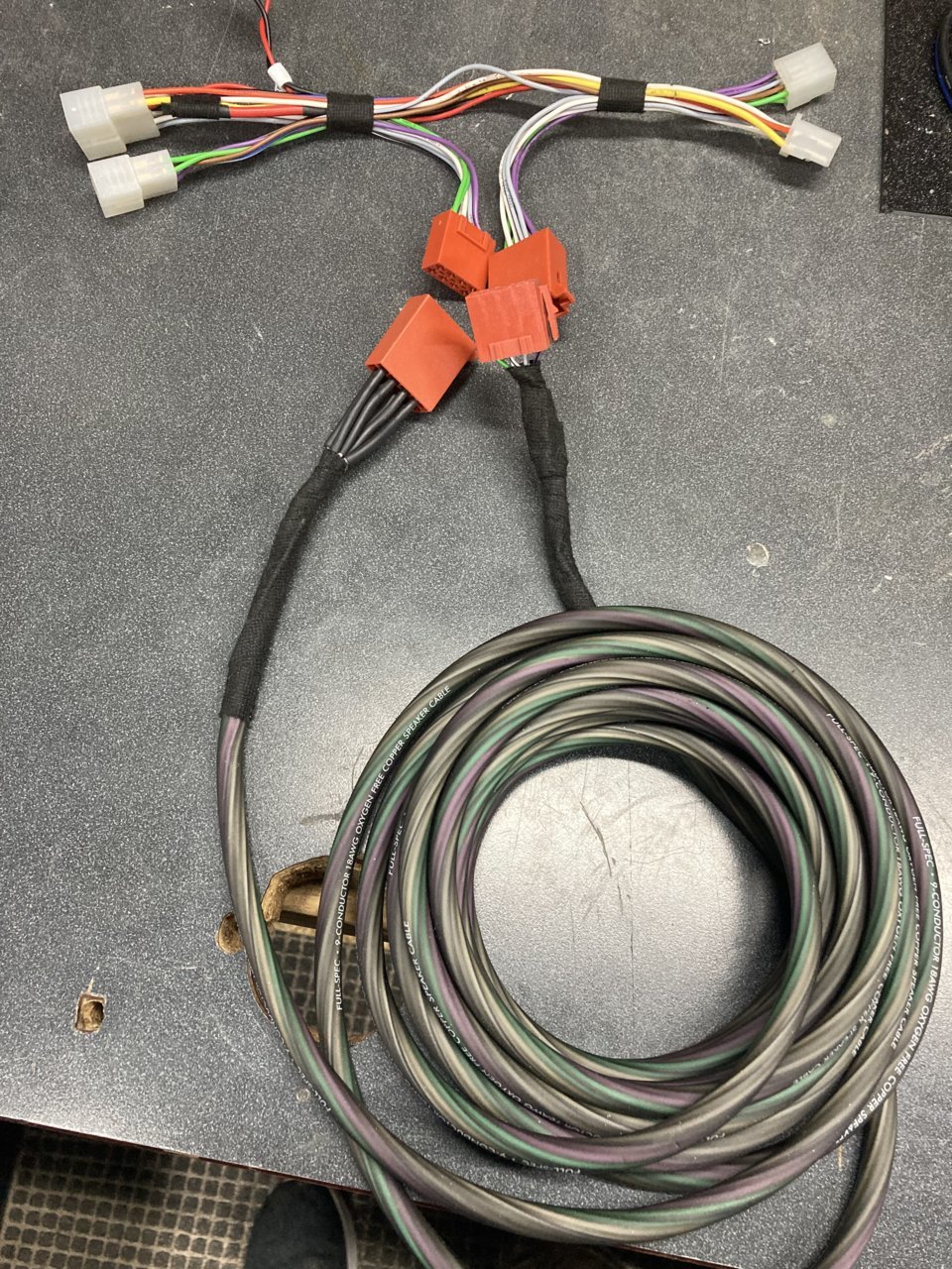

    You are going to make one of these. You won’t use T-Taps and you don’t need an LOC.
    The Alpine manual explains that you either remove the RCA connectors, or adapt your harness to plug into the RCA connectors on their harness if you are using speaker level inputs.
    The manual also states that you need to run minimum 12AWG power and ground, with a 20A fuse on the positive battery connection.

    Yes, this is a harness I made for a 2017 4Runner that I have not had the chance to install yet. The connections on 4Runners and Tacomas are the same generally. Obviously I added quick disconnects on the 9-Wire running to and from the amplifier, just so it would be more easily run, and I haven't cut the wire to length on the amplifier termination side yet. I also added a 12VDC +/- pair to power a DSP which I'm running outside of the 9-Wire.
    The pigtails you bought should work but you can't be sure until you have your radio out. Yes, that's 9-Wire, probably the best/easiest solution for running wires to a remote location amplifier while still utilizing the factory harness back to the speakers. None of these components came with the truck originally, it's mostly comprised of a Toyota integration harness I got from Audison for another project.
