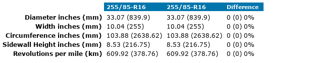

    255/85/16 or 255/80/17 ;)

    I can't remember what thread it was in, but the bfg km2 (which I have on my 1st gen) in 255/85/16 are really @ 34.5 inches tall. With ome 883 coils in a 4cyl std cab I rub the frame at full lock. This is with stock rim offset. uploadfromtaptalk1370982175157.jpg
