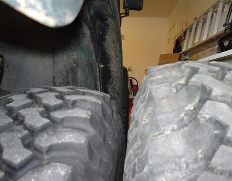

    I was going off of a picture I saw on one of the forums that had a 33" tire next to one of these. I just had the wife take a picture since I am out of town. It looks like it actually measures 32".

    Is that a 255/85/16 km2 though?

    Here is the link I was referring to about the large tire size. I misinterpreted the description but read the "words of caution" section.
    http://www.expeditionswest.com/equipment/tacoma/bfg_mt_km.html
    Here it is:
    Words of caution: I will start by saying the 255/85 is a large tire for the Tacoma with IFS and and full travel (no lowering of bumpstops, etc.), and is not a bolt-on endeavor. These tires measure 33.4" tall, and are much taller than the typical 33. The picture on the right shows the BFG 255/85 R16 next to a BFG 33x10.5 R15. There is a 1.3" difference in height between the two tires.

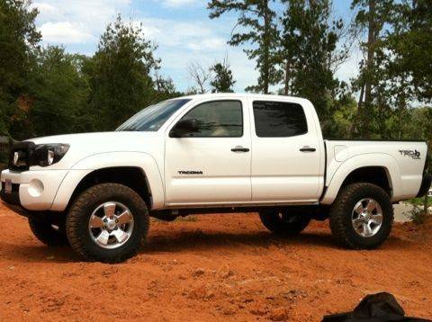

    Here is mine when i had my coilovers at 2.25 with 285's
    i had them on stock sport 17's with 1.25 inch spidertrax wheel spacers

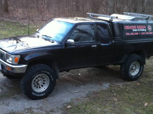

    Good price, good Hwy driving, good wear, not that much noise, just a nice little hum and haven't got stuck yet. sweet tires. Just make sure to rotate every 5000.
