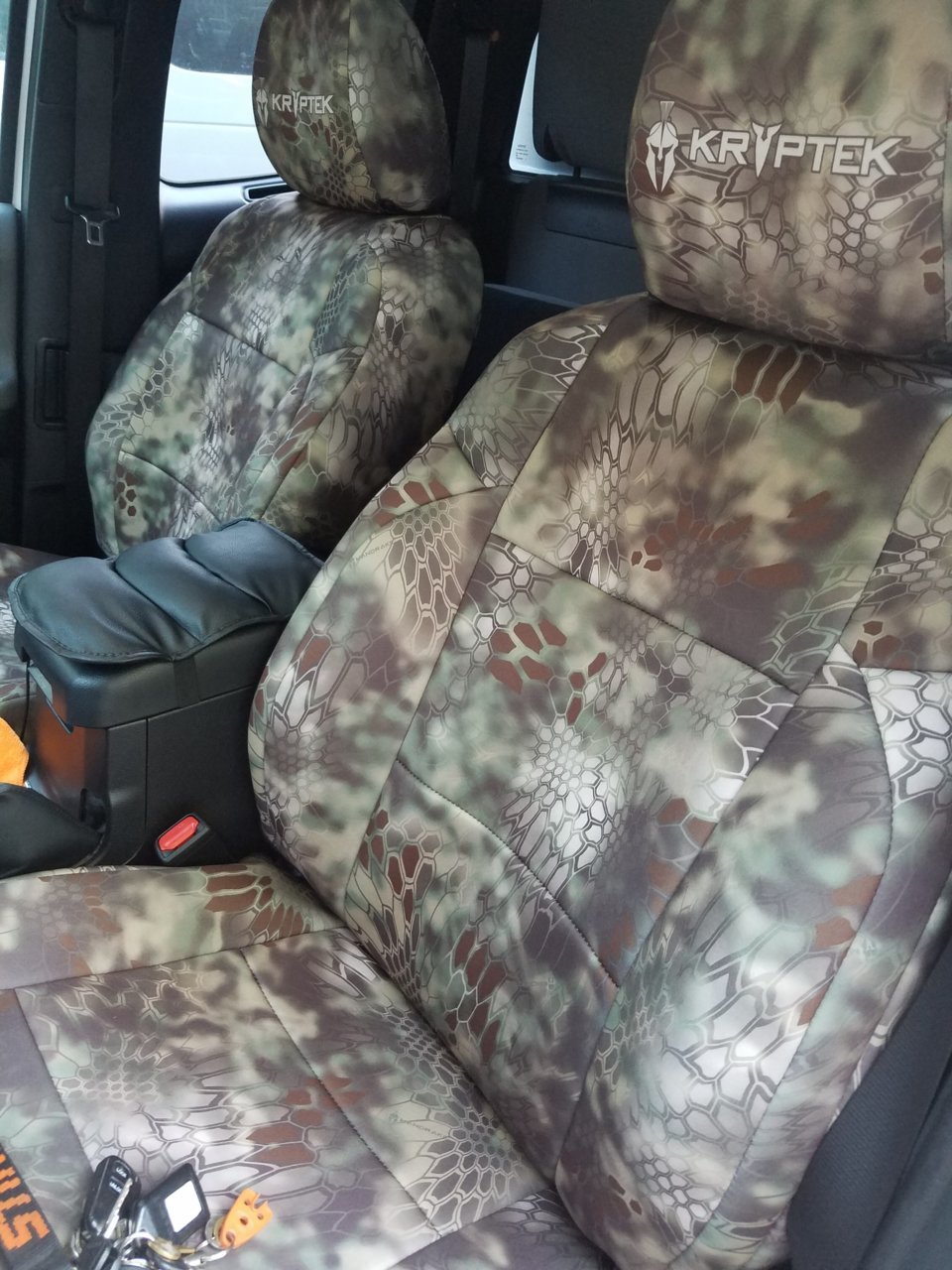

    Can' remember but I got them on ebay. Only thing that sucks is it takes 2 weeks to get these bastards it was torture. Think they were 319 but they fit like a glove. Cover king full mandrake is the name of these. They have about 10 other colors in this design. Here is a slightly better picture but in person they look even better20180523_070547.jpg

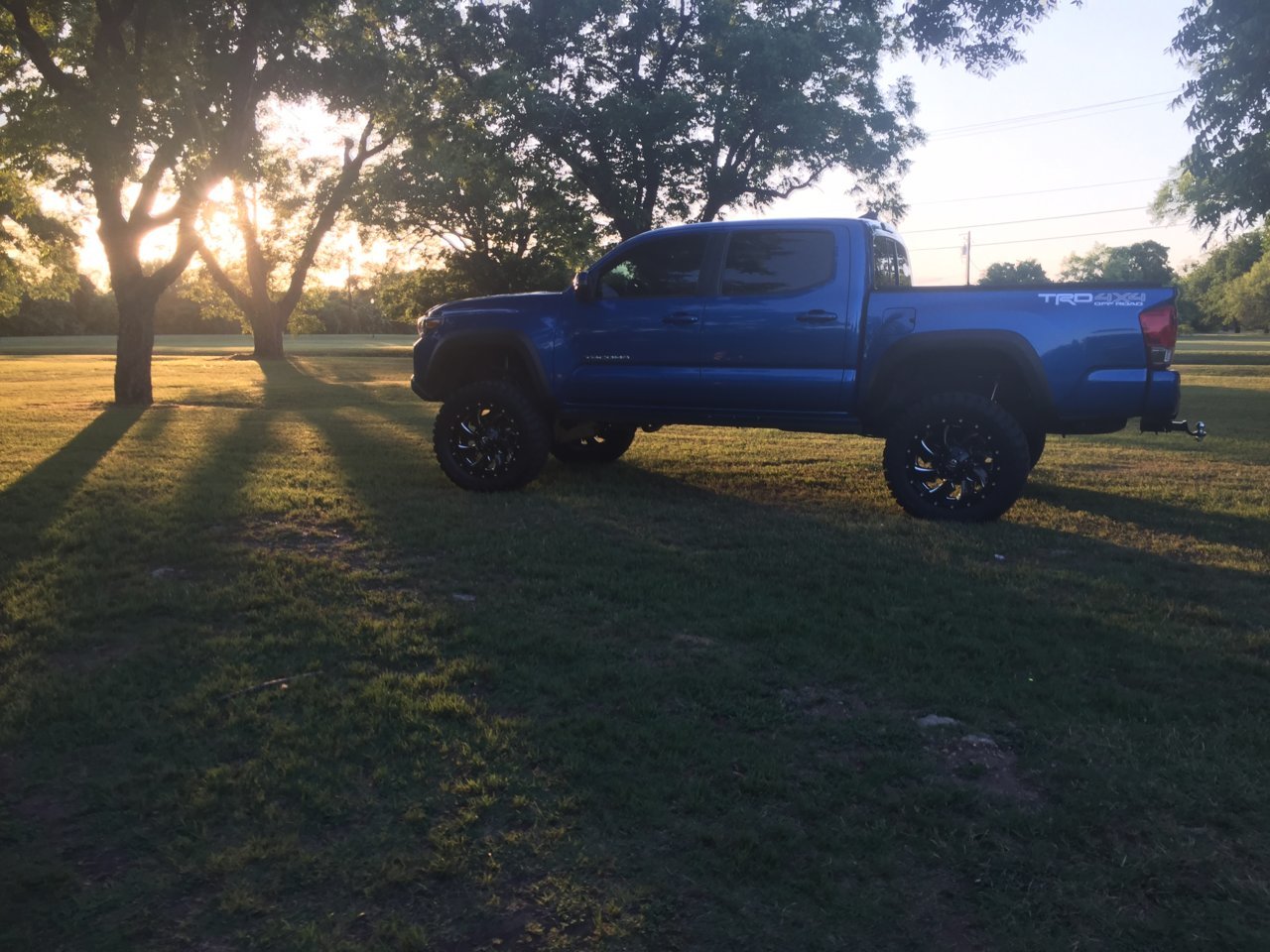

    Pro Comp 6 inch lift, Toyo MT 33 12.50 R20 on Fuel Cleavers
    I love my 6inch procomp lift!

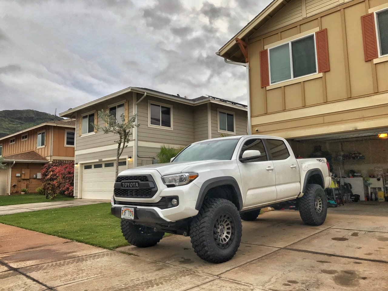

    6” BDS coilovers w/ dsc Black Rhino Madness wheels 18x9 -12 Firestone Destination MT2 35x12.50 CMC Flowmaster 40 series muffler TRD Pro grille Softopper
    6” BDS coils on 35’s.
