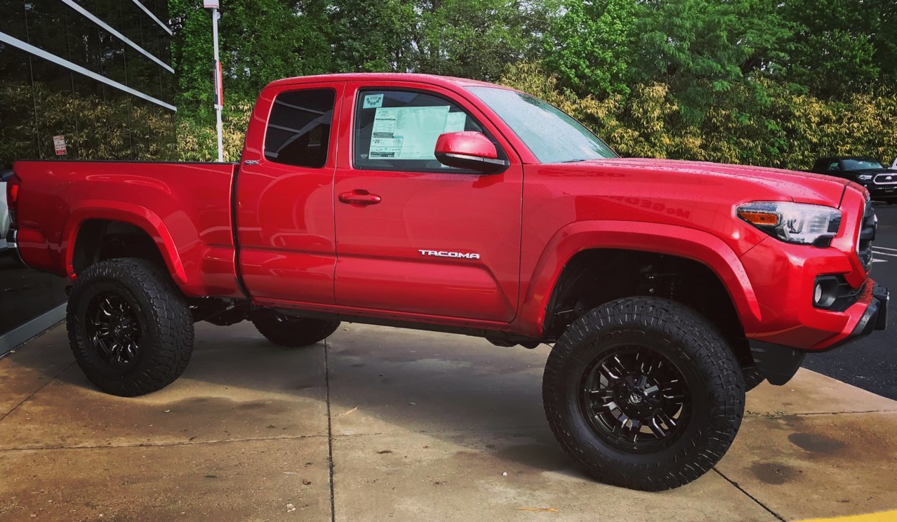

    6” BDS lifted Access Cab at the local dealer.
    This is the Stage 1 BDS lift which does use a 6” spacer ontop of the factory coilover assembly to bridge the gap the drop bracket and the new longer knuckle provide. 18x9” wheels and a true 35/12.5/18 Toyo OC AT2.
    As an owner of a truck that went from BDS Stage 1 to Stage 2, I can say that the ride is great but likely not 100% necessary if you’re not constantly bombing on it. The Stage 1 kit is identical to the Stage 2 aside from the coilovers.
