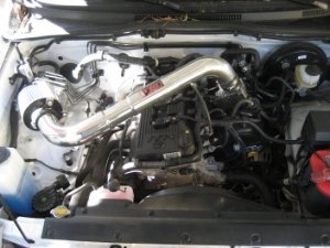

    Although I have a 2.7 and not a 4.0, I do run a warm intake for better gas mileage...
    8a098052-48fe-43ec-a082-e93bd8aaf3e0_zps_432e7fed9e245571ffee1f2620ac3b05b5e88170.jpg
    ...and am pleased with the 23 mpg average even with a fully loaded service truck and a lot of third gear driving on rural roads. I'm not concerned with heat soak. Injectors mixing fuel into nice hot intake air is just fine with me. :)

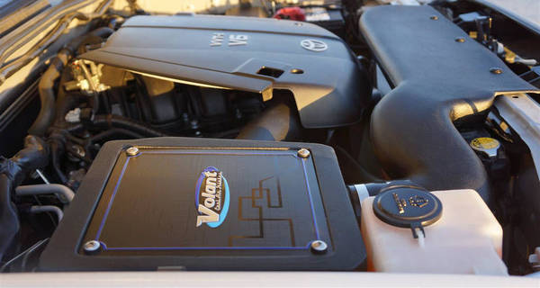

    I did a Volant CAI + scoop and URD MAF Sensor. Didn't notice any increase in MPG, maybe slightly better performance when stomping on the pedal, but overall 'noise' was increased. If you want a great look under the hood, go for it. If you want want throw away $$ (mine install was about $500) install a CAI. And, I wouldn't waste your money on the URD MAF.

    That's a really neato looking intake. :)
    I'll bet it sounds awesome. Sometimes we do things just for the cool factor, and that's ok. Is that little box a URD MAF sensor or is it their MAF controller? How was it to install?

    Hey Greg...it's the MAF sensor calibrator: http://urdusa.com/p1260198051/URD-MAF-Sensor-Calibrator/product_info.html
    Installation was easy - just soldered the leads to the wires on the ECU just under the passenger kick panel. I just keep the black box in the glove compartment.
    Yah, intake does look great and definitely more 'throaty'....helps along with the Borla catback too in terms of great sound.
