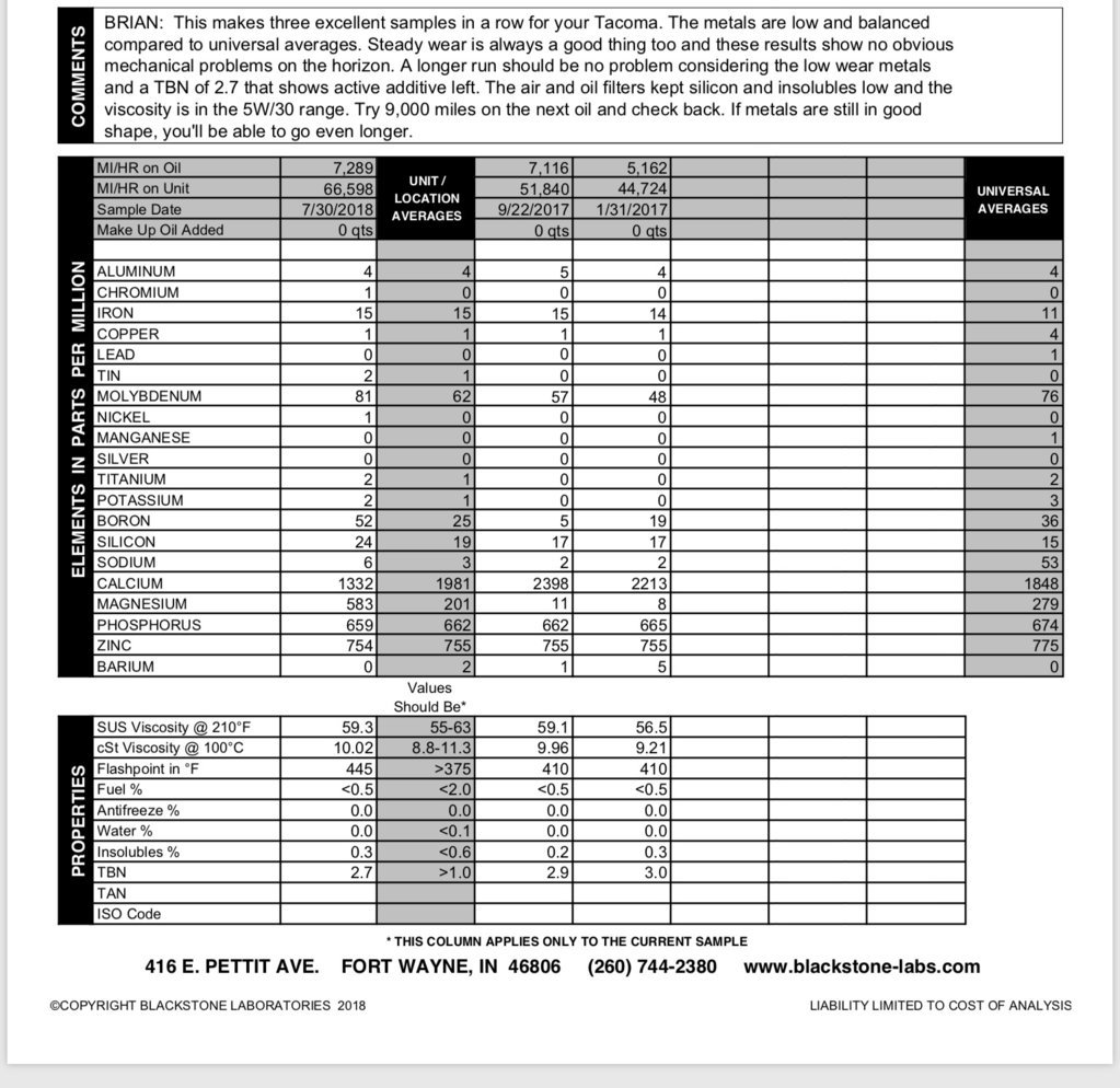

    Used oil testing of my second gen showed no problems with fuel or crap in my oil. These oil change intervals covered use between -60°F and 100°F with plenty of idle time in the winters.

    It looks like you drive a pretty fair number of miles; that will burn/boil off any impurities held in suspension by the oil, so in your case you can get away with long idle times, but that doesn't mean it is good for the engine. Folks who routinely do long idle warm-ups and then drive to the grocery store and back are the ones who will show all kinds of impurities in the oil.
