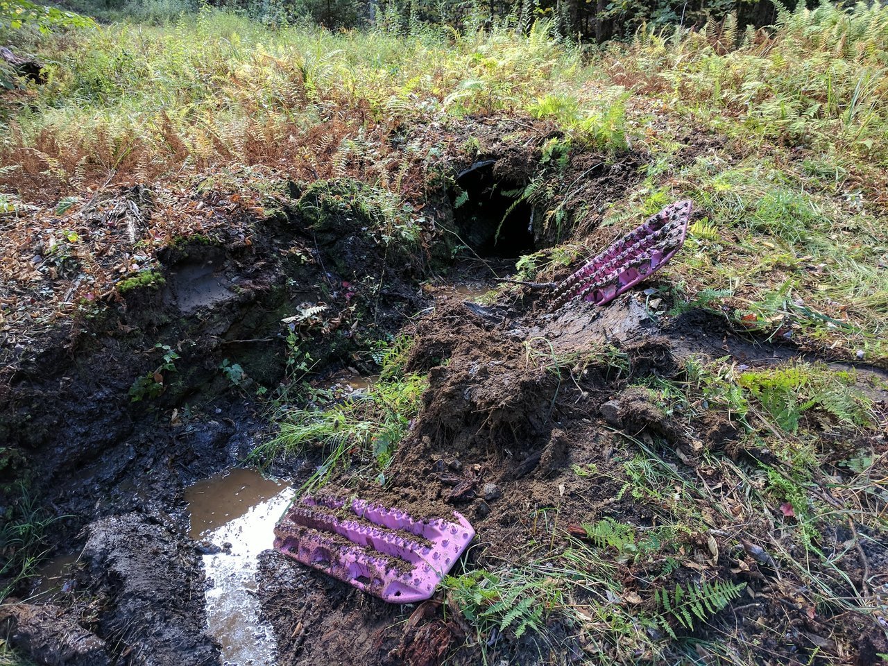

    A couple of weeks ago I was up in Vermont, and due to some landowners who illegally redirected some Class 4 roads, we ended up stuck on a hill on someone's vast property. We winched out twice, but on the 3rd pull (straight, about 70ft away from the anchor point) I heard a loud clunk and the winch stopped responding, and any attempt to use it would drop the battery voltage down to 6-7 volts. We were able to get winched out by a Jeep (damn it all) and a series of maxtrax and mud flinging sprints up the hill.
    This was only my second time using the winch since I installed it last year, the first was using it to clear a tree from a maintained trail the dray prior. I plan to send it in to Warn for warranty repair, but I'm curious what could have caused this? When it failed I was making forward progress, not just winching from a stuck position in park or neutral.
    Thanks for any help or opinions. Pic for attention from earlier in the day.
