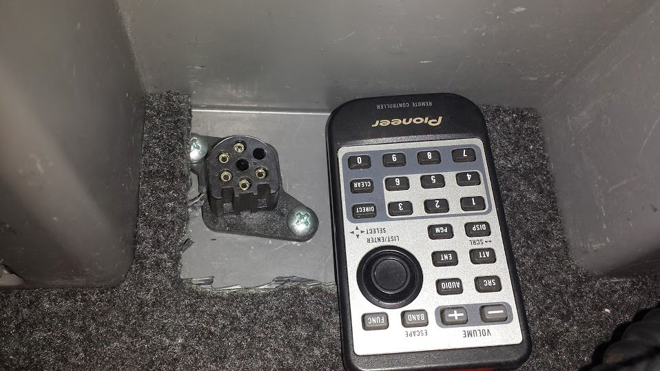

    From the dead! Is this a 3-pin extension? I'm looking for one to use with my Superwinch,
  6. Dec 25, 2013 at 1:30 PM
    Manwithoutaplan
    Manwithoutaplan the full Monty
    Jan 30, 2008
    #4500
    53,839
    ID
    I used trailer wire and routed it in the cab in the center console.

    Nice! I'm assuming I could find a 3-pin socket?
