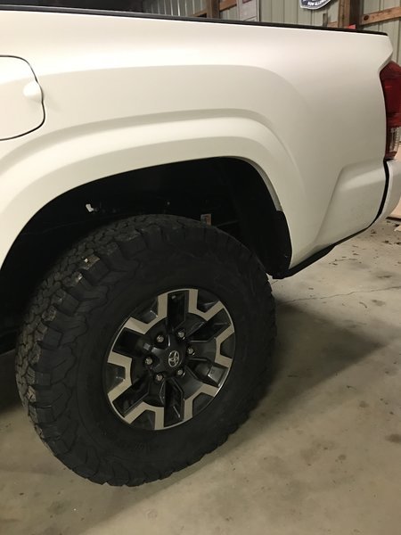

    I purchased some Second hand wheels from an OR Taco yesterday and had them installed last night. When I came out this morning 3 of them were flat. Come to find out the TPMS sensors are different for aluminum wheels.
    New sensors could be a deal breaker. Proceed with caution.
