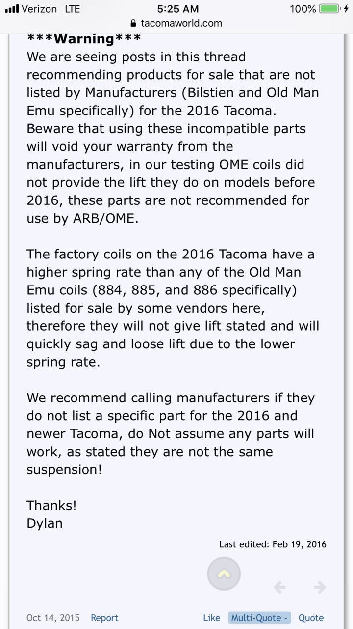

    I searched other forums and found the contact information for the Bilstein Warranty Supervisor, Lisa Ciacci. I sent her an email and she initially offered to replace the one strut under warranty, however, all of the 3rd generation struts were spoken for, so she offered me a 2nd generation. I countered by asking for a 3rd gen, when they come available, and I'd buy a second at cost. She said that was not possible because that facility does not sell to the public.
    To get what I wanted I had to change my approach and let her know that this was not a warranty issue, but rather about customer service and correcting what went wrong. After laying out my case, I told her I wanted both the struts and the shocks replaced with the correct ones. She finally agreed to replace both struts with the current model. She said the 2nd generation rears are the correct ones for the 3rd generation, so they were not replaced.

    June 16th: the "official" release from Bilstein came out that the Gen 2 5100's were the correct model for the 2016 Tacoma….
    June 17th: I purchased the struts and shocks.
    June 22: Bilstein website changed and the page that listed the 24-239370 (front) as the correct fitment for the 2016 Tacoma was no longer available.
    So the manufacturer puts out bad information that I acted on, and now it is my mistake? :confused:

    When the 2016 went out the 2015- (070) p/n were the one listed by Bilstein until they decided to upgrade for a specific model. You can actually drop a 3rd gen suspension with a 2nd gen strut on the lower notch because 3rd are running 1" higher than 2nd gen. That is why the Bilstein third gen is listed +2" instead of +2.5" lift. Also, because 3rd gen have higher spring rate than 2nd they might have change the valving a bit but maybe not really. My opinion is they just shift grooves position a bit on the body.
    OP, your 2nd gen shock failed because there was a problem with it, probably a defective seal, not because you used in on a third gen. It just make sense they decided to replace it under warranty.
