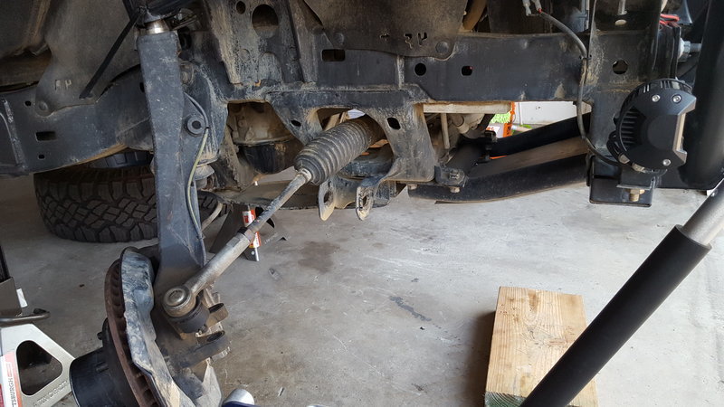

    Just ordered one from napa, should have it on tomorrow afternoon.

    Is there any "how to" on how to replace the LCA?

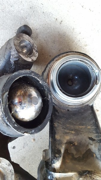

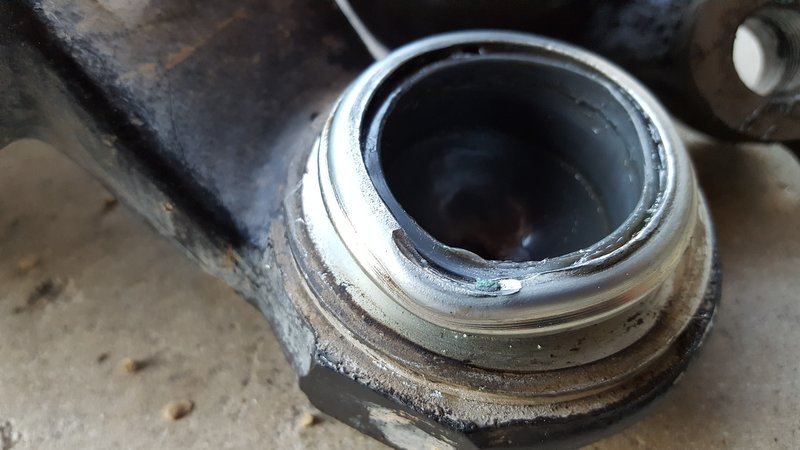

  7. Sep 30, 2016 at 8:22 AM
    #27
    nd4spdbh
    nd4spdbh Well-Known Member
    Oct 7, 2013
    #114055
    14,604
    SoCal
    13 DCSB TRD OR v6 Auto
    DAMN that ball cub was FUKKKKED.
    In the case of the OP he just beats on his truck and wheels like a mad man wearing out the ball joint like a sumbitch. Those referening the 1st gen taco / 3rd gen 4 runner / 1st gen tundra lower ball joint problems... those were 100% different. On those rigs the LBJ is in a configuration that the ball joint is always wanting to be pulled apart by the weight of the truck (in tension), some would fail / crack and fall apart if they were abused or had the defective one.
    Our 2nd gen tacos / 4th n 5th gen 4 runners have flipped the lca to spindle config so that the ball joint is in compression (A MUCH better design) and because of the the OP didnt have catastrophic failure as the ball joint was always being pushed up into the cup.

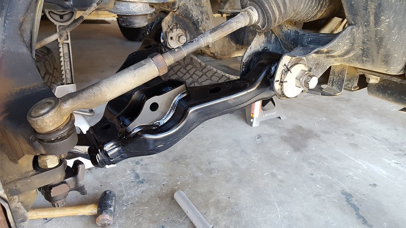

    Done!

    Nice, how much did the new LCA's run you?
    Been looking at some 'performance' ones but they're $1700 :( Crazy considering the best UCA's are almost half that

    $150 ish from Napa autoparts
