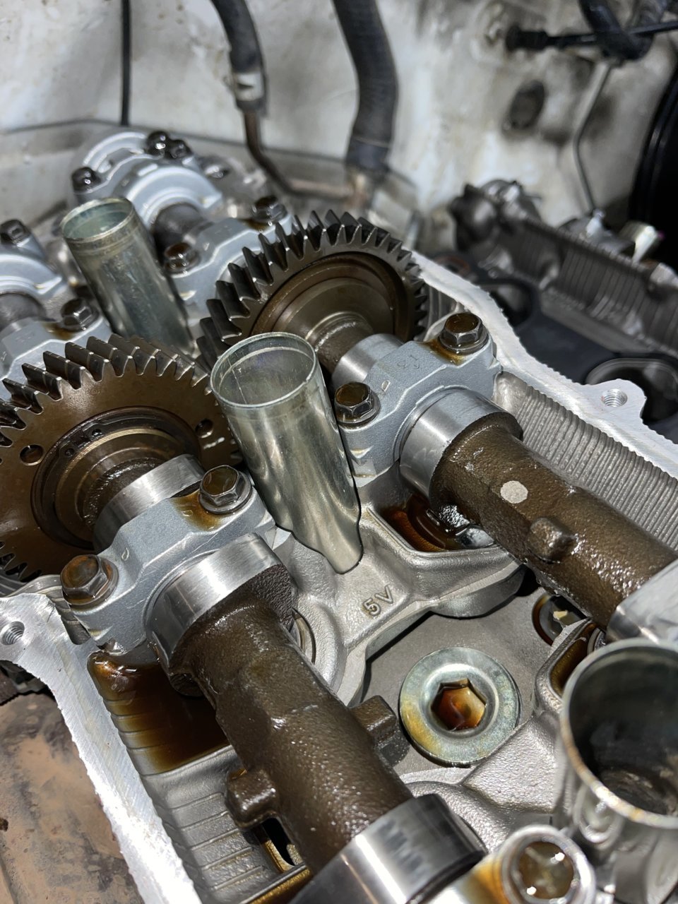

    Are these lobes suppose to be pointing straight down compressing the shim while at TDC??

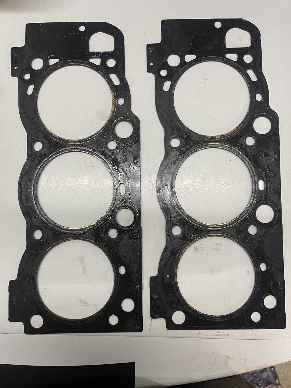

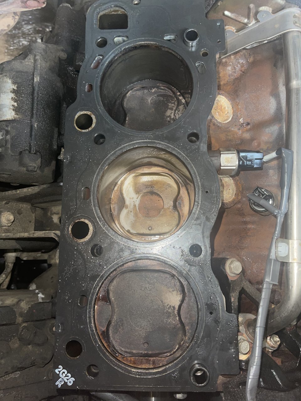

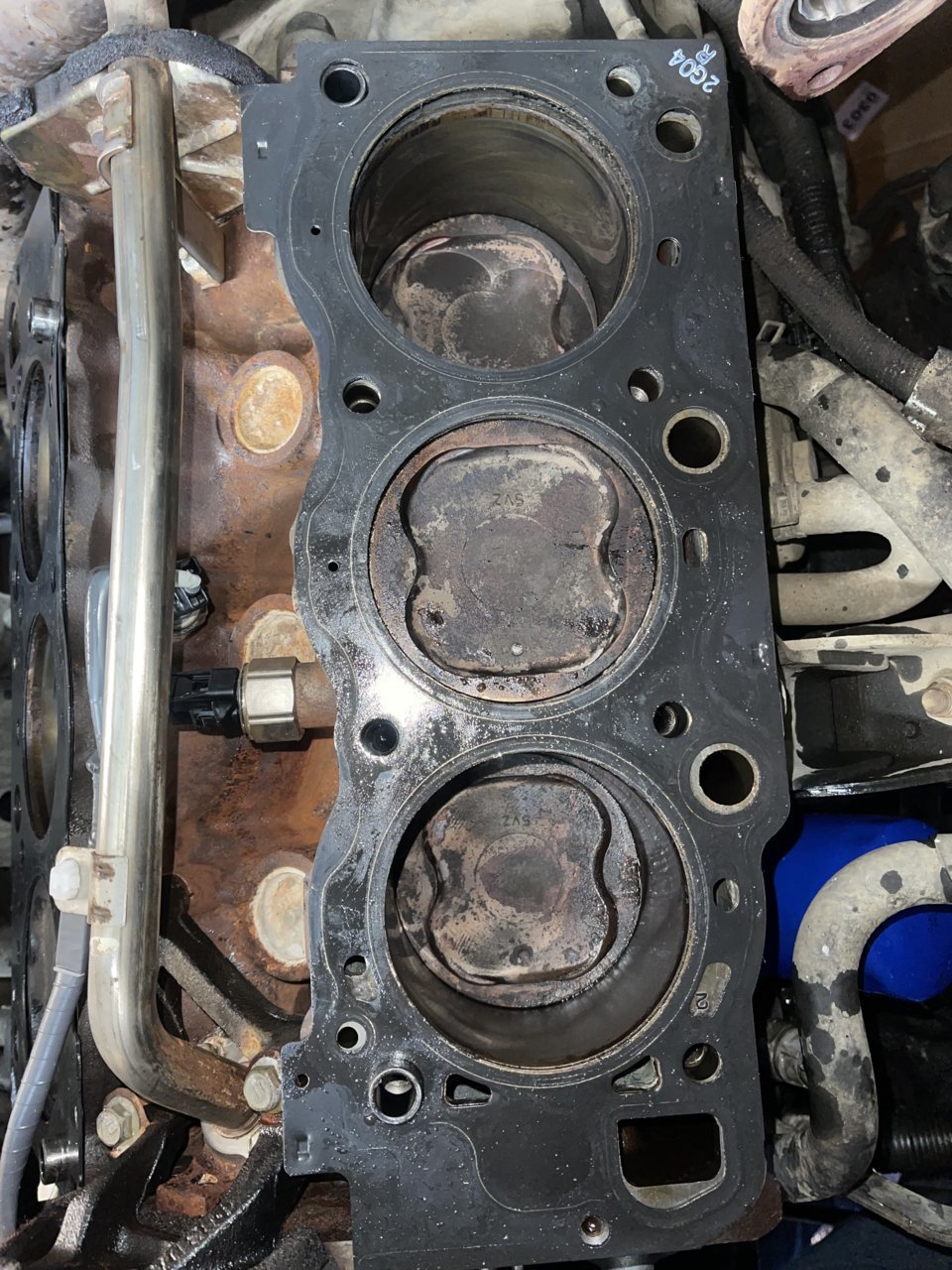

    And btw, turns out I possibly might’ve installed the HGs incorrectly. so here we are again.

    Driver and passenger gaskets are different correct?

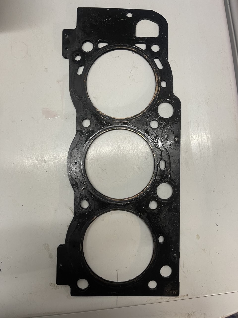

    2001 v6 4WD auto
    Did I install two rights

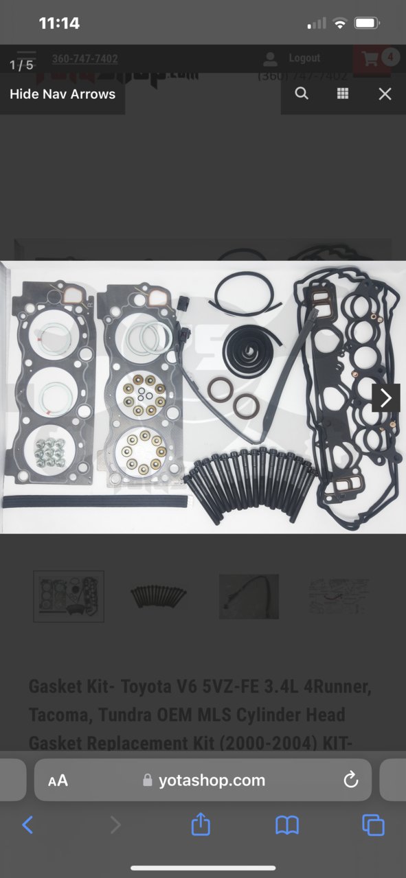

    I have them stacked on top of each other in one pic. This is what the website shows and one of them indeed does look different.
    User error.

    Your not going to like what I say, but DO NOT reuse the gaskets.. get new ones..
    shitty. But you don’t want to do this a 3rd time. Hit the dealer up and see what they can get them for oem. Probably not bad and less wait time

    i had a kid come into the dealer admitting defeat with his engine rebuild. he installed the gasket wrong once.. figured it out, pulled it apart, reassembled it with the old gasket.. had issues still.. pulled it apart again, use high temp RTV on the gasket... yea it was a mess. it happens.
    sadly i had to replace his engine completely.. the removal of the head multiple times lead to the threads pulling out of the block.. and the head had enough warpage to say "probably not worth surfacing vs replacing the whole thing with a new motor.
