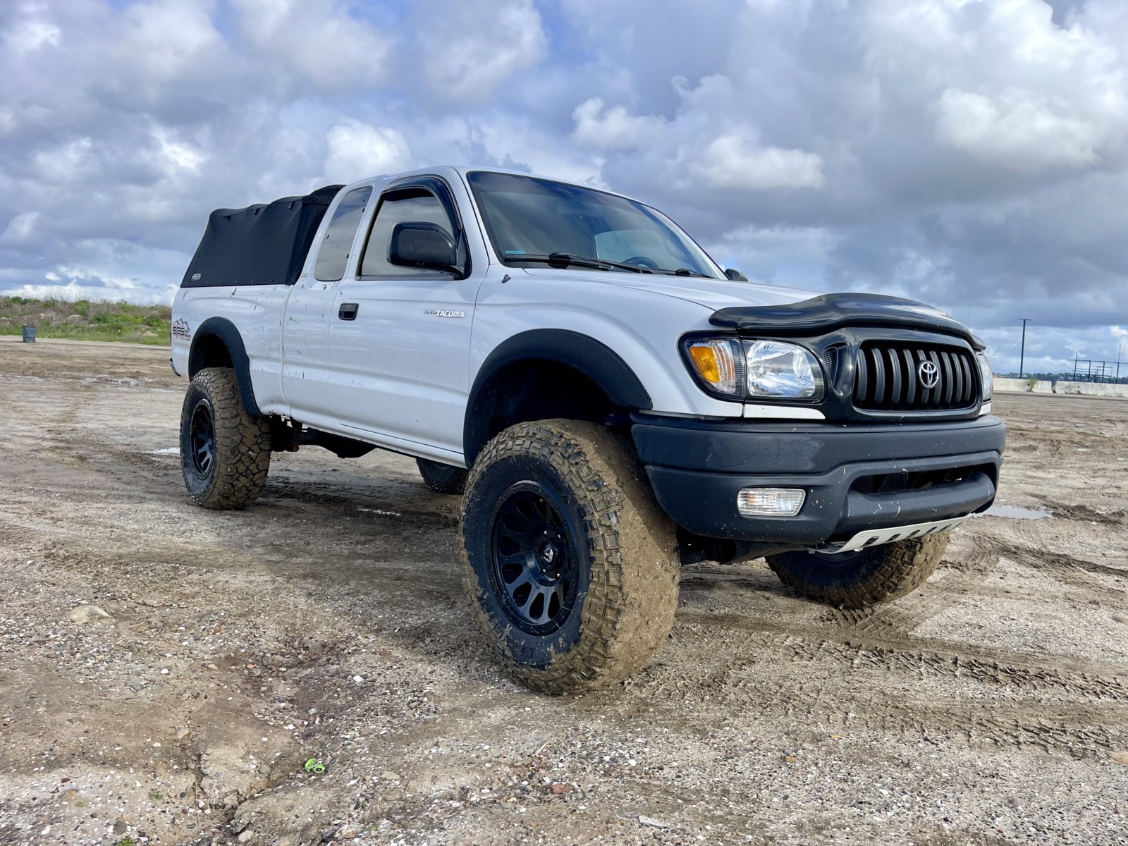

    1 year update:
    So far so good with these Felpro head gaskets and reman heads. Runs strong with 309k on it. Hoping these will last me at least until I have my own garage/area to do the job again. Now just gotta get rid of this damn p0420.
