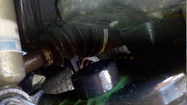

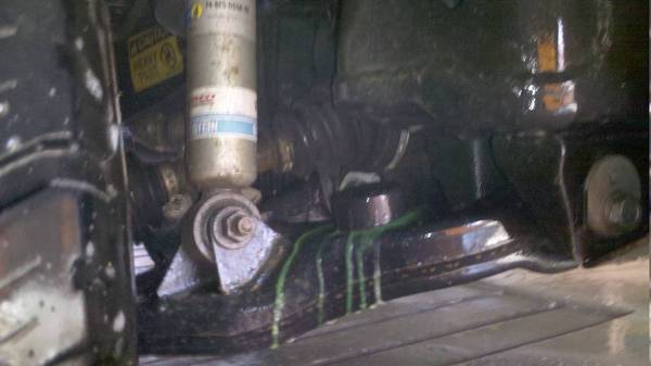

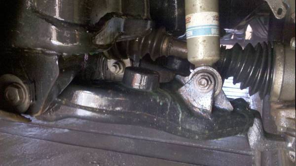

    What is it and where might it be coming from?
    Also, are my cv angles ok?

    looks to me like anti-freeze.

    Looks like antifreeze to me. Not sure on cv's thou

    cv angles are fine

    green fluid = Antifreeze. You've got a leak in your cooling system somewhere....
    And CVs look great. No angle issues there.

    I know everyone said antifreeze, but don't some of the 1st gens have the pink/orange coolant?
    Maybe someone filled it with the green coolant at some point. I agree it looks like antifreeze but.......

    I just checked Mitchell On Demand.com and according to the section on fluids for a 2001 Tacoma it should have Toyota Long-Life coolant which is pink/red in color. So it might be something else. I like the A/C idea, but the dye from that is usually a neon green color.
    My vote goes for CV boot grease.

    In the radiator, rust may give it a reddish hue, even if the coolant is green.
    From the leak, get a little on your fingers. Does it feel watery? Does it rinse off easily with a tiny bit of water? That would indicate anti-freeze. Smell it. Dip your finger into the radiator and smell that. Smell the same? Probably anti-freeze.
    In the pic, I see what looks like rain drops of the stuff all over. that's also suggestive of coolant leak. First place I'd look is water pump/water pump gasket. Then hoses. Then hose fittings.
    If, on the other hand, you find it's greasy on your fingers, and doesn't rinse off easily, then I'd tend to think CV grease. In that case, I'd give a close inspection to those CV boots and find if one of em's cracked.

    Neon green is pretty consistent with what those pics are showing.
    But, but, but... whenever I've had an AC leak before, it didn't leak a liquid. The cooleant was freon and it vaporized at room temperature. Has AC technology changed, and that's no longer true??
