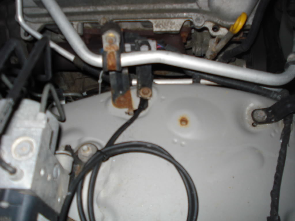

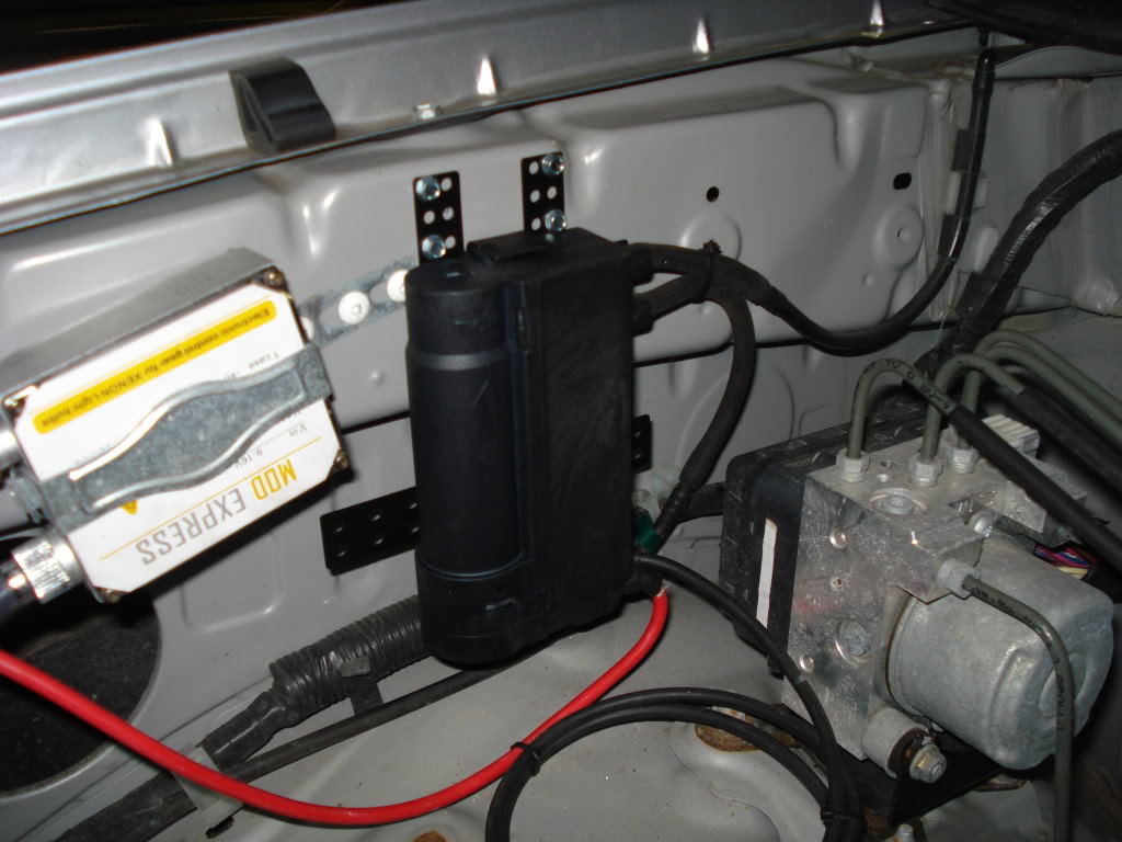

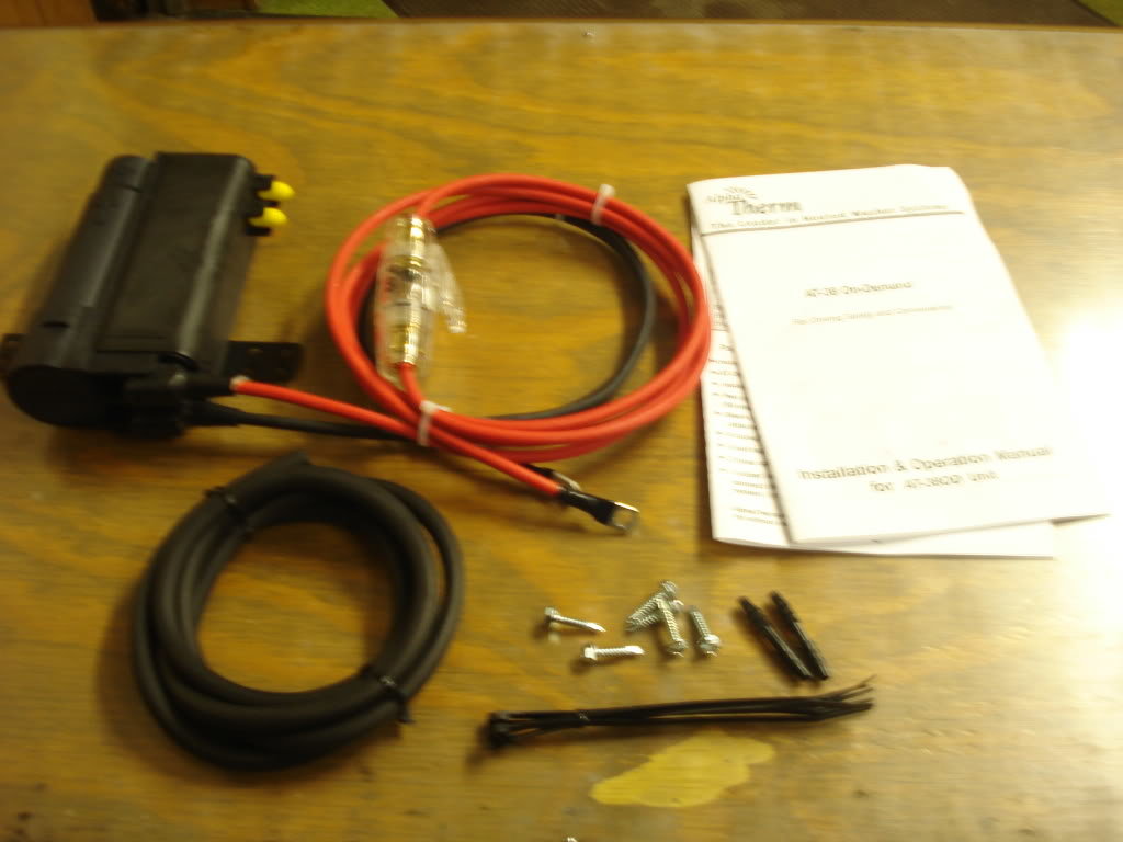

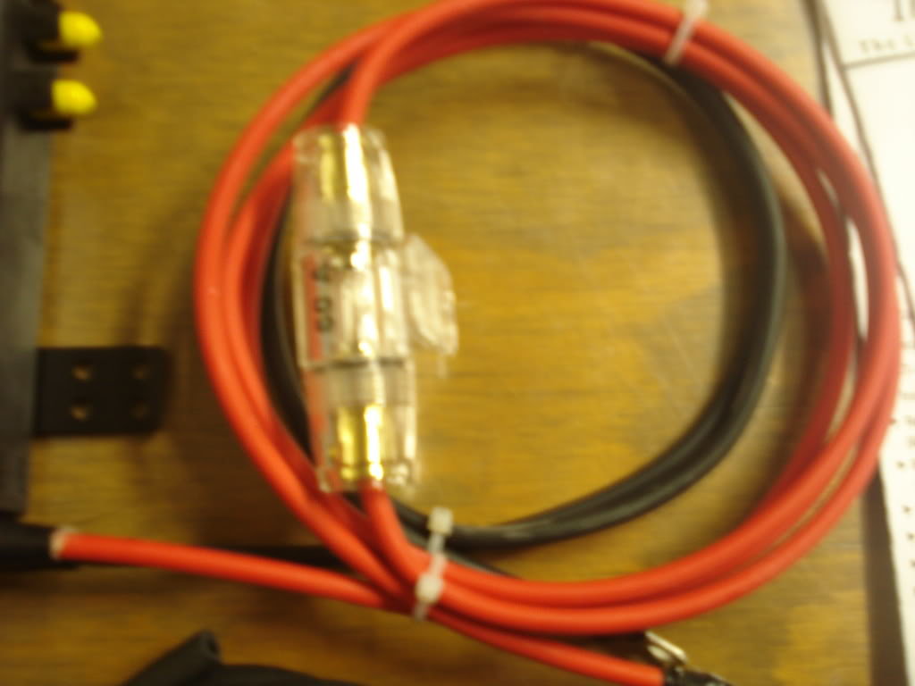

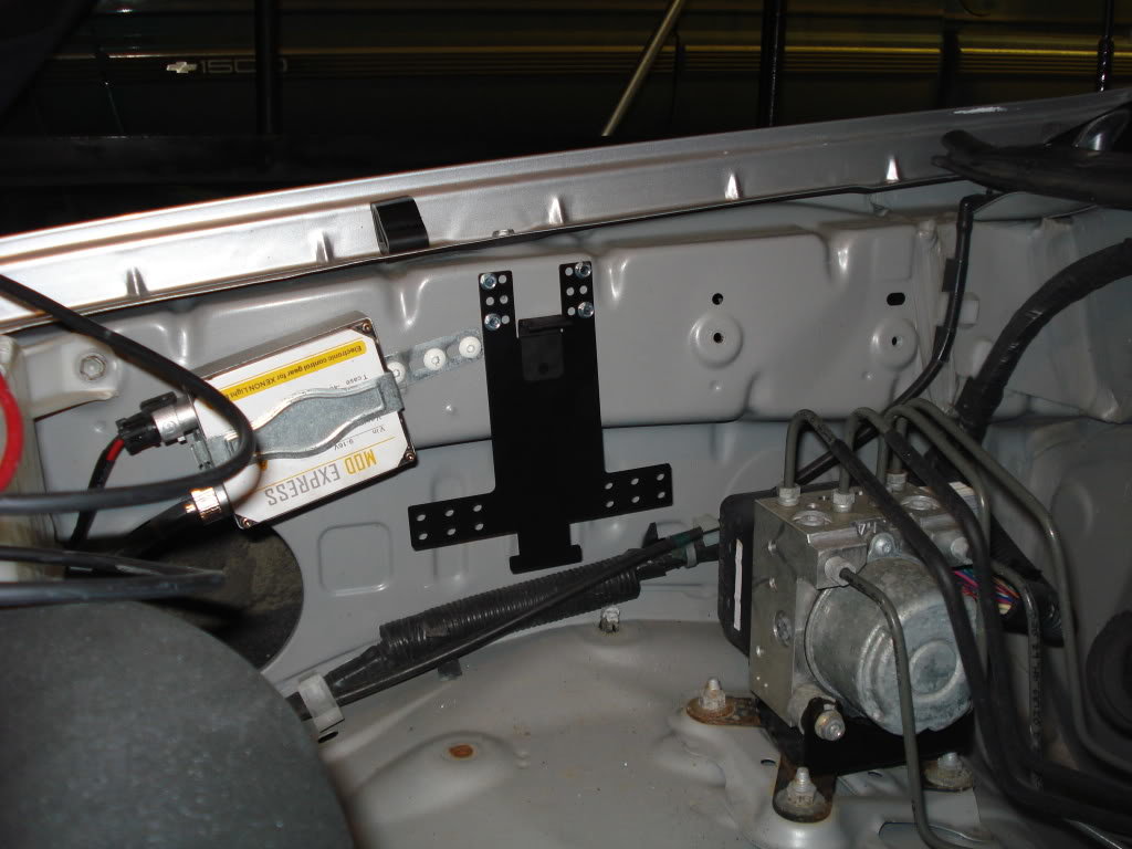

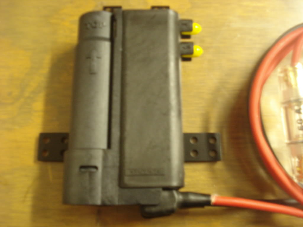

    i purchased the one you listed first. i absolutely loved it. i used it all year round. in the summer it helped temporarily clean bugs and such. in the winter it helped clear frost, salt, dirt, and mud a lot easier than regular ol' washer fluid. i even used it in below zero weather, multiple times, with absolutely no problems. i used it for 2 years before i sold the truck. my father took it out and installed it on his silverado. he has used it for the last 2 years with no problems either. he was skeptical of it when i bought it (a 40+ year mechanic), but stole it from me because he loved how it performed. i have install pics. give me a few minutes and i'll see if i can find them.

    i remember reading somewhere years ago that several gm models had units similar, but the wiring was more in-depth.... and would catch on fire.
    the model i posted is only a positive and a ground. if i remember correctly, yes it's hooked to the battery at all times, but only activated (turned on) when the vehicle was running and the voltage was higher than 13.4 volts or something like that. i ran it for 2 years and now my father has for an additional 2. no problems at all

    what unit did you have? the one i had gave about 4-6 secs of hot fluid, then you had to not use the washer fluid for about 10-12 secs. this allowed the fluid in the unit to heat up, then you could activate the fluid again for another 4-6 secs of hot fluid. repeat as necessary. i though it worked great for everything i wanted it to do. mine also kept the wipers free and clear.

    the one pictured just above this post is the one I had. Maybe mine was just a bad unit, it happens...It's a cool idea, but I wasnt impressed with the performance... I was thinking of the blades more to prevent the icing on the wipers than to keep the frost off the windshield, since the defroster does a damn good job in these trucks...
