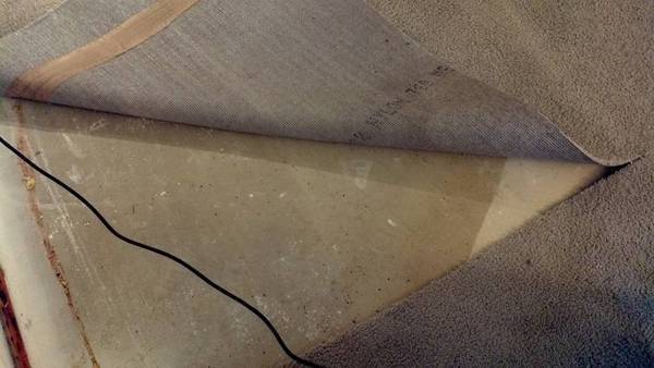

    Carpet ripped up, sort of:
    They took out all of the padding above the wet concrete, then put the carpet back down on the concrete. They plan to get an air handler in here in 1.5 hours. It's a carpet cleaning guy that's handling this, not sure how I feel about that.

    1,884
    Sacramento
    18 PreRunner TRD OffRoad DCSB
    Air handler is now blowing air under the carpet, it looks like little waves. Do you guys think this being taken care of properly? I believe the carpet will be fine, only concern now is the drywall behind the base boards, but the carpet guy says i shouldnt worry because the water did not travel up the drywall. All you can see is water damage on the bottom half of the base board. Ive got windows open and bathroom exhaust fans on.

    Did they tear the pad up or just put those fans under the carpet?

    They removed the pad that was on top of wet concrete, the rest of the pad remains, but I hope that portion of the pad did not get wet.

    Just make sure they removed any pad that got wet. Carpet padding is cheap enough where you can over do it and just replace a little extra if needed.
