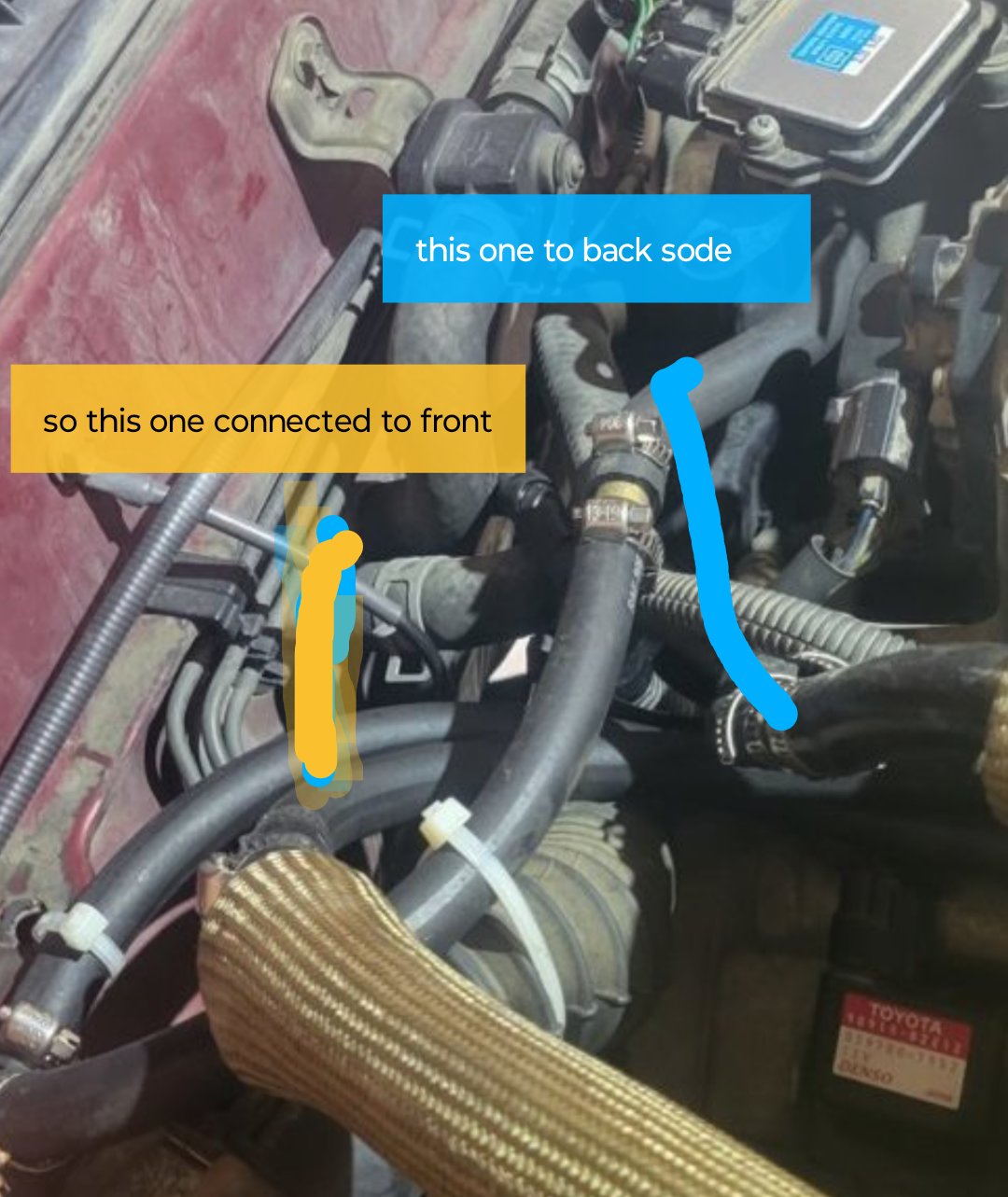

    Throttle body is what I used, and just looped into the turbo and the output of the turbo goes into the TB inlet. I got a picture somewhere here let me try and find and revert.

    Right side is the original inlet to the TB, left is outlet from turbo that then hooks back into the inlet to TB

    So I lent connect to part going to the front tb outlet to side

    Yea, so I only disconnected the original hose/port on the front side of the TB. I then connected that into the blue line to my turbo, the yellow line then connects back into the front port of the TB to complete the loop. I left the other TB port unchanged.
    Hopefully that helps.
