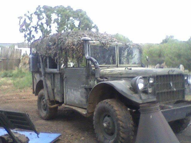

    You cant do much worse than mine:
    Exhaust is home made, as is much of the intake. :eek:

    What are the dimensions on that thing?

    LMAO!!!! It does. I was going thru some 6-7 foot deep water (going down the middle of a river), and I just folded the windshield forward, and locked the throttle and sat on the seat back. A buddy of mine took my picture from the top of a small cliff he was on. Looks pretty cool. From the angle he took the photo, you just see my head and shoulders and the snorkle sticking out of the water. In front of me about 8 feet you see the wake from the front of the truck. I had the top off at the time. I take the top off when doing serious off roading.
