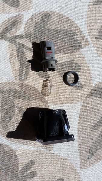

    Mine looked like this, almost half-full of water.
    I'm thinking this is not collected rain, but water ingress under pressure, perhaps from a car wash a couple weeks ago.
    It was pretty brown... I think not dirt, but corrosion.
    The second pic is after I cleaned it up and was letting all dry in the sun for a bit. There is a soft o-ring seal around where the bulb base / connector plug in.
    It's back together now and the light still works (tested).
    I wouldn't expect much from just replacing the assembly until the part is revised to resist ingress, unless this is one of a bad batch of them out in the wild. A tighter seal doesn't always win because it makes it easier to trap moisture over time and get condensation and corrosion inside.
    Also wondering if maybe the ingress was around where the clear and black plastic meet on the bezel/diffuser. If I have to remove it again I'll look at that more closely.
