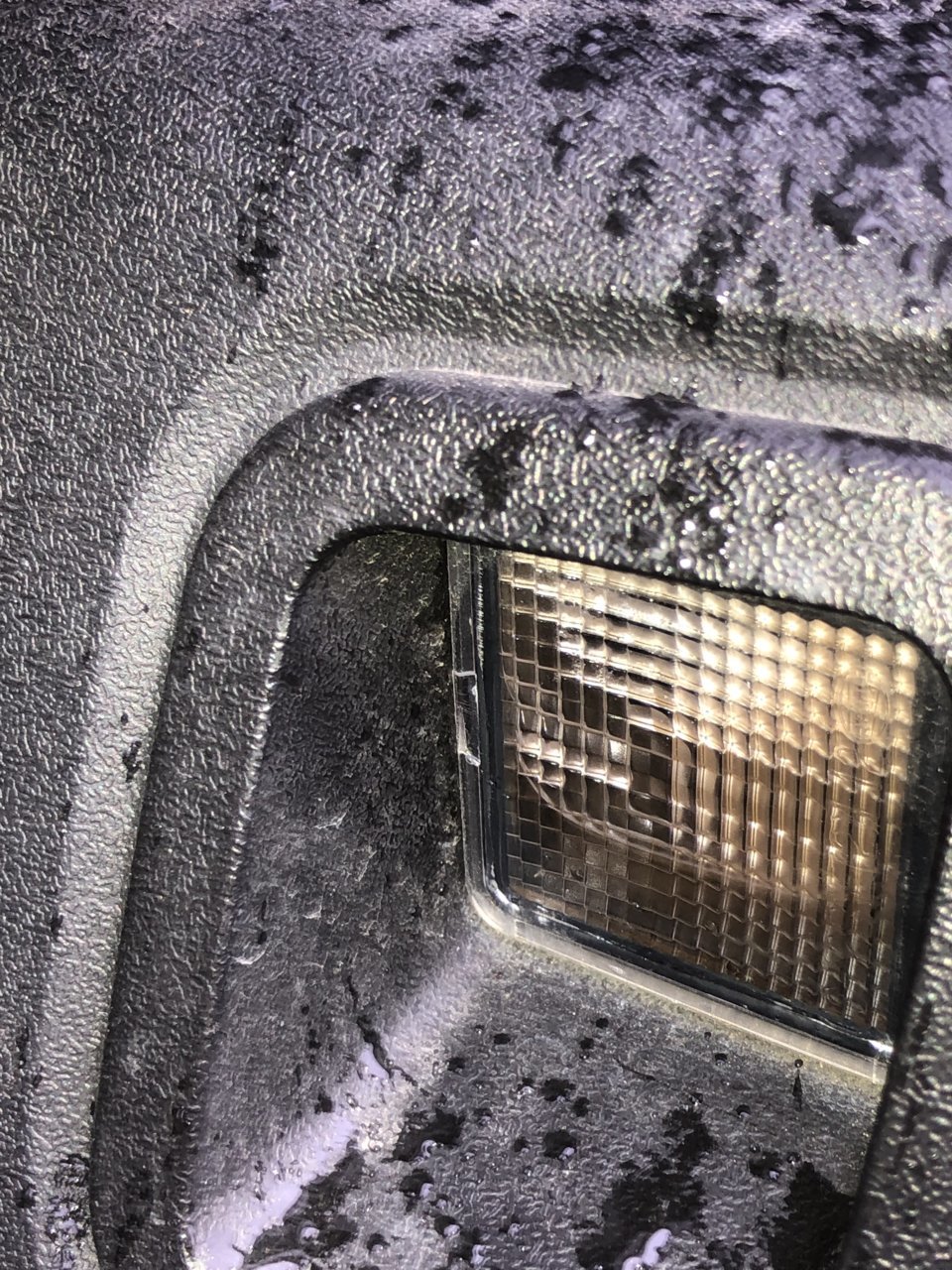

    Mine keeps filling up too. Think I might put a small goldfish in there just for aesthetics....

    My passengers side plate light is fubar. Looks like a frog pond.

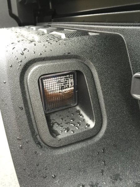

    Dealership said it was because I changed my bulbs to LED's. Ha! it was already doing before the swap that because the OEM bulb was wet and rust all over it from the terminals on the connector and the bulb. Told this info to Toyota Corporate as well so I'm going to see if they help with my cause. I'm not too concerned about it right now, but the housing will get replaced down the road.

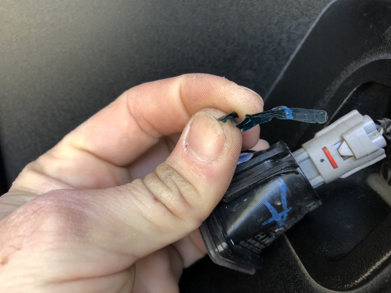

    Hey so I thought I’d touch on this topic I had the same problem with my license plate light full of water so I took it all apart and figured out what’s wrong. If you look at the pictures below you will see this green tag looking thing that Toyota decided was a good idea to leave in between the seal for some reason. They are on both sides so I suggest you remove the both of these. It’s easier to pop the assembly out as a whole and leave the light connector plugged in until it’s out and you can remove it easier. Once I pulled these both out and cleaned the surface area where the seal sits in the light housing I re tested for leaks with a pressure washer on both sides and nothing. No leaks. No added seals or rtv just need to remove these green tags

    There is a tsb out on this. Don't break it! Cost $41

    They gave me the same BS line. I talked to the service manager and mentioned the Magnuson Moss Act in a not-too-friendly manner. They fixed it. I still swapped out the LEDs with the original bulbs the next time it happened to avoid the BS. It hasn't leaked after the 2nd fix.

    I just loaded up the o ring with some dielectric grease and so far no leaks.

    The TSB has them replace the wire harness. It is not a quick/simple operation, but it worked for me.
