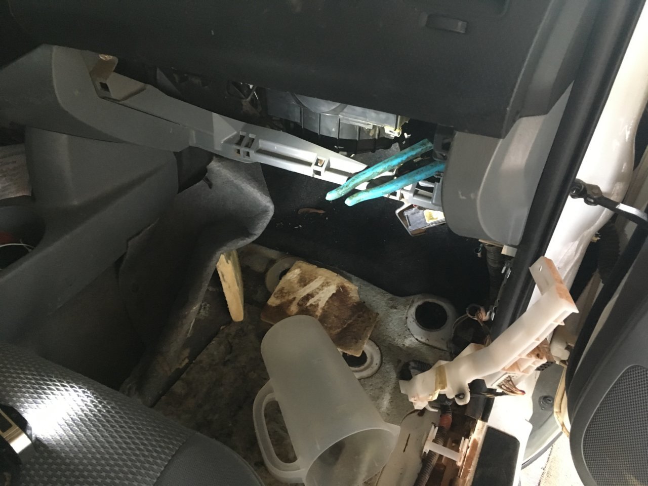

    Hi y'all. Thought I'd share some troubleshooting of a water leak I had. The leak would only happen during heavy rain storms. This got be a problem living in southern Louisiana. Passenger side floorboard would be soaking wet. Search TW and found the usual suspects (windshield, cabin air intake, roof, rear window) were not the culprit.
    In trying to find the leak, I pulled the carpet and glovebox out, and moved the computer out of the way to get access to where I thought the leak was.
    Used a pitcher to simulate a heavy rain and was able to narrow down where the leak was. It was coming from the meeting of two body panels. The black line is a plastic straw used in later steps.

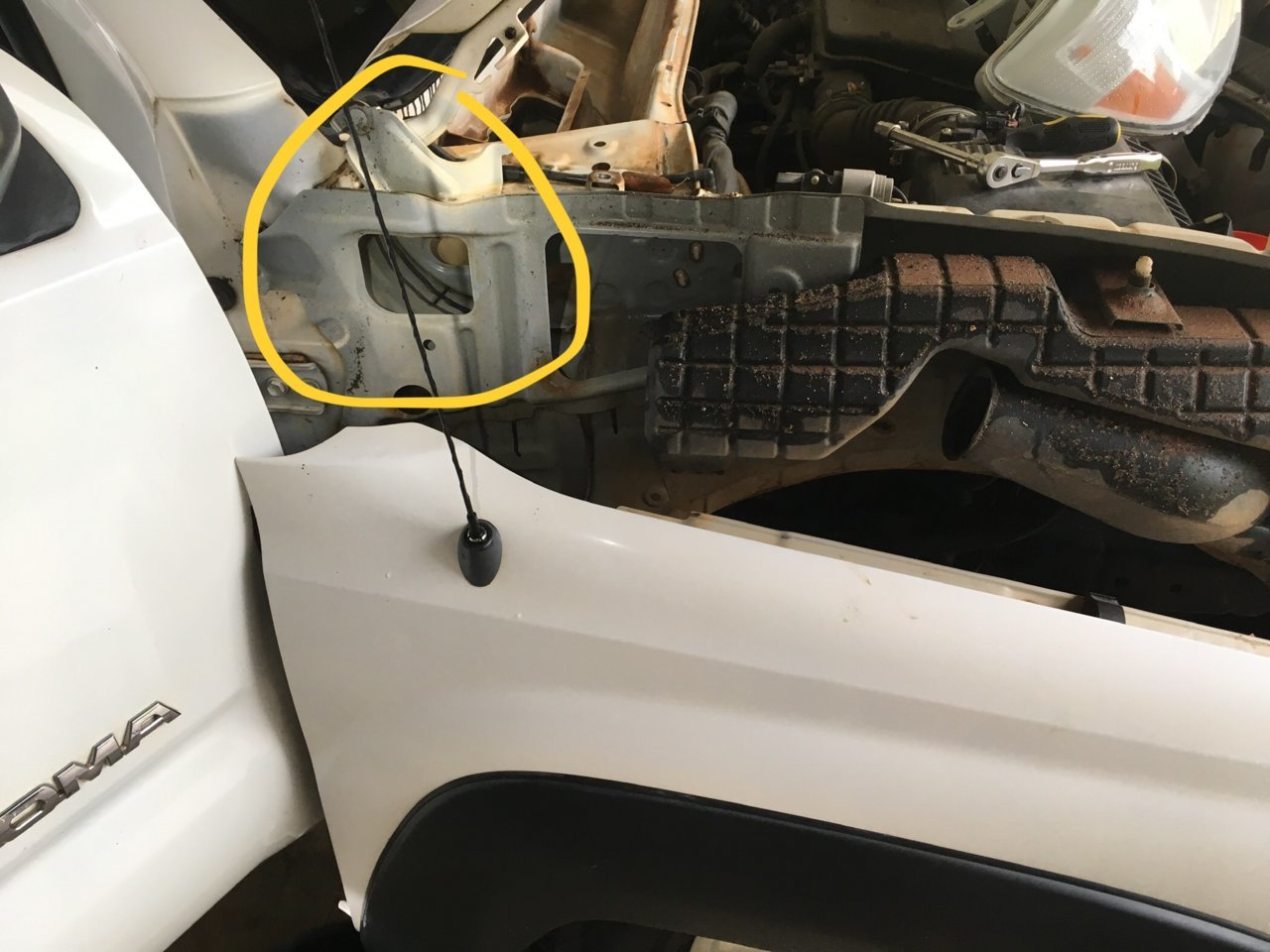

    Couldn't access the leaking joint through the cowl. So, to get access to the leak from the outside of the truck, I had to remove the passenger side quarter panel/fender. Yes, I know the inside of my fender is particularly dirty...

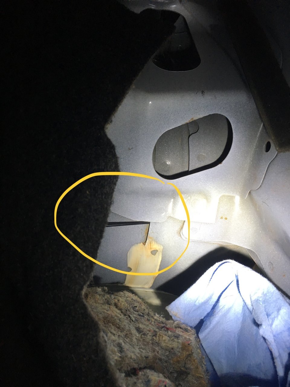

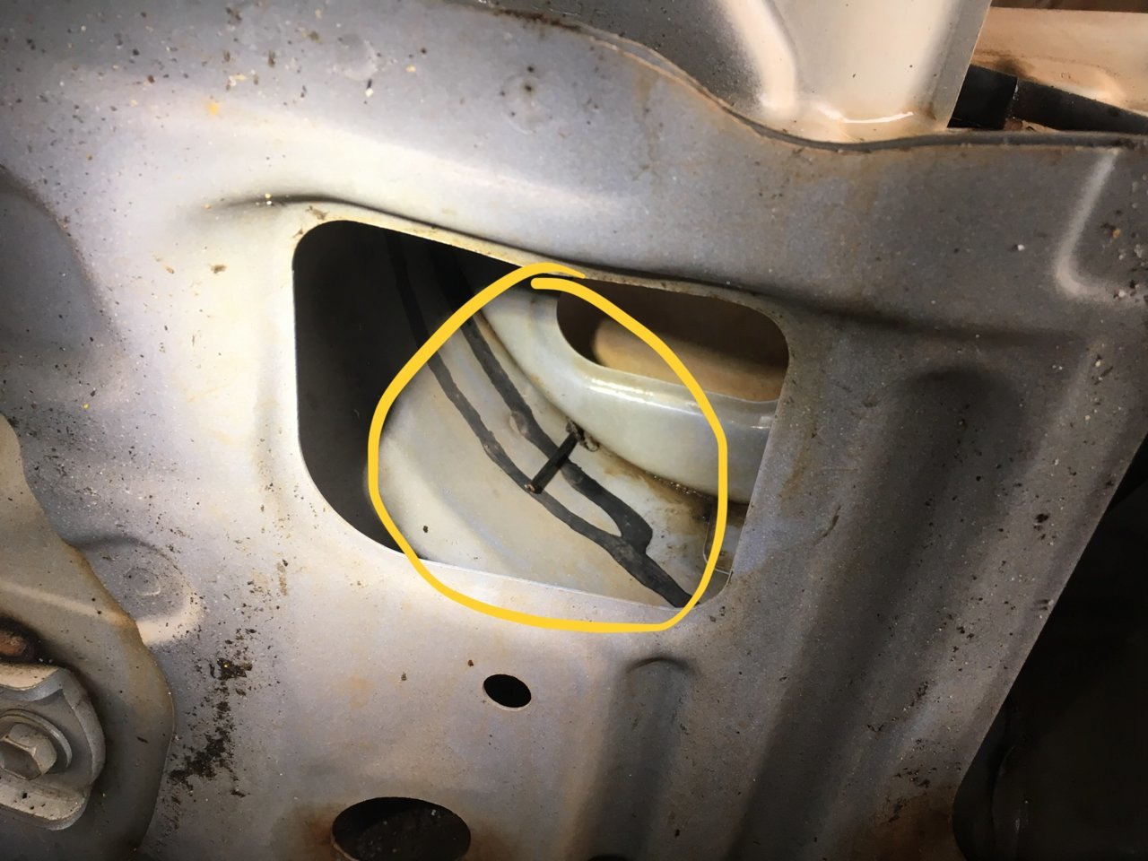

    The sealant between the two panels was beginning to crumble. Where the sealant was really degraded, I was able to pass the straw that comes on a can of brake cleaner through the joint entirely. (Can be seen in the second picture from the inside and the following picture from the outside).
    I roughed the metal up from the inside and the outside. Cleaned it with some brake cleaner, and used the pressure from the can of brake cleaner to force out any sealant that was dry-rotted in the seam. Applied gasket material from the inside and outside and forced it into the joint with my tried and trued finger.
