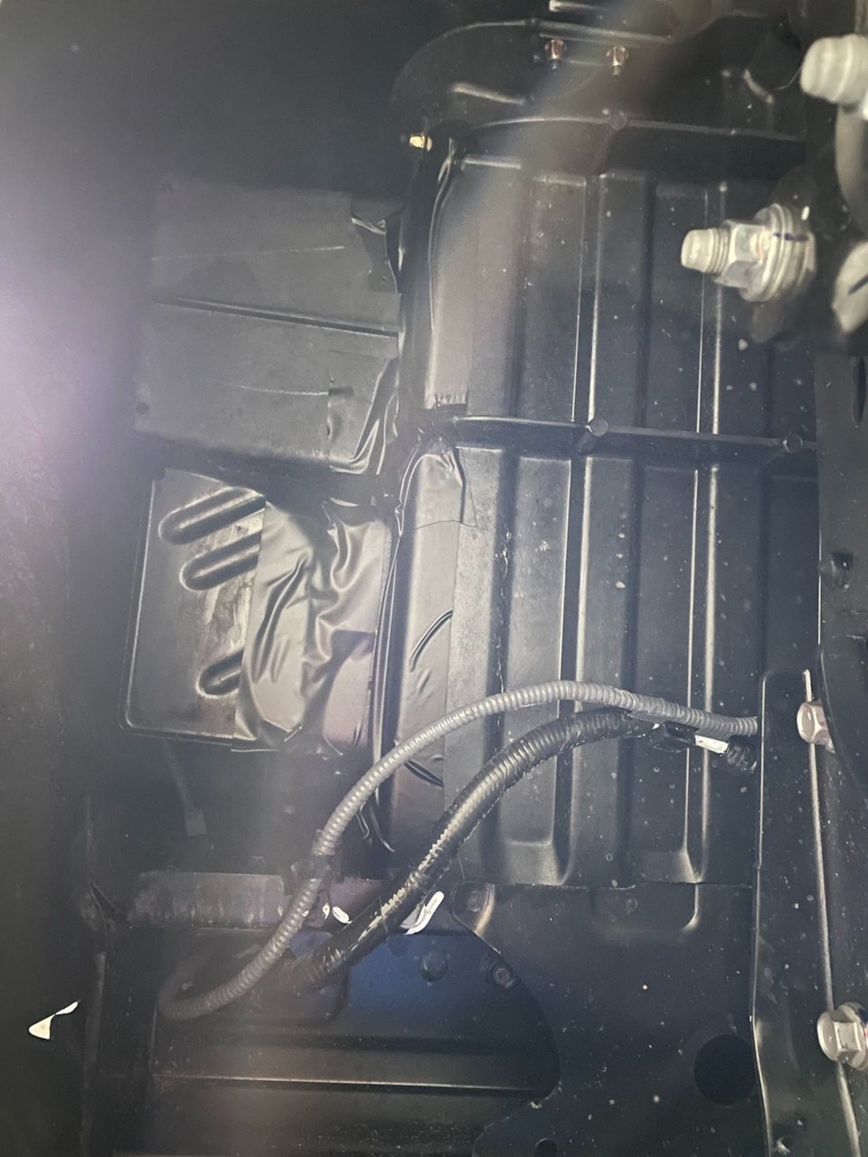

    Here are pictures of the Flex-Taping on the under-side of the bed rails. The strange wiring you see was my abuse of an aftermarket bed-lighting kit to connect my Alu-Cab dome lights to the same circuit as the standard bed light. I eventually plan to transition the lights to a separate battery so that I can have them on all night without the timer kicking in and also not worry about being able to start the truck the next day.

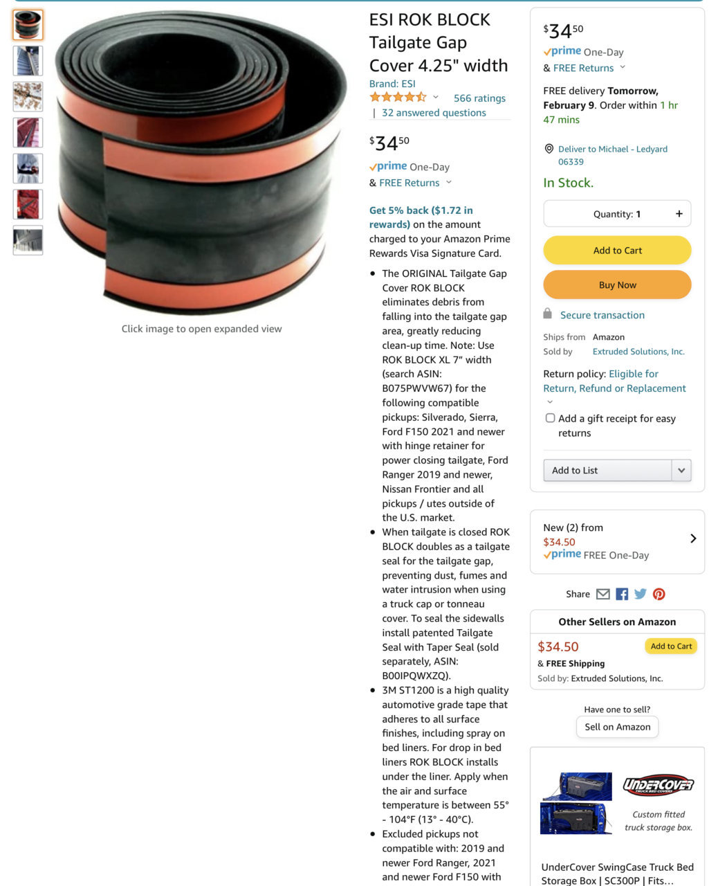

    Here’s how I handled the tailgate.
