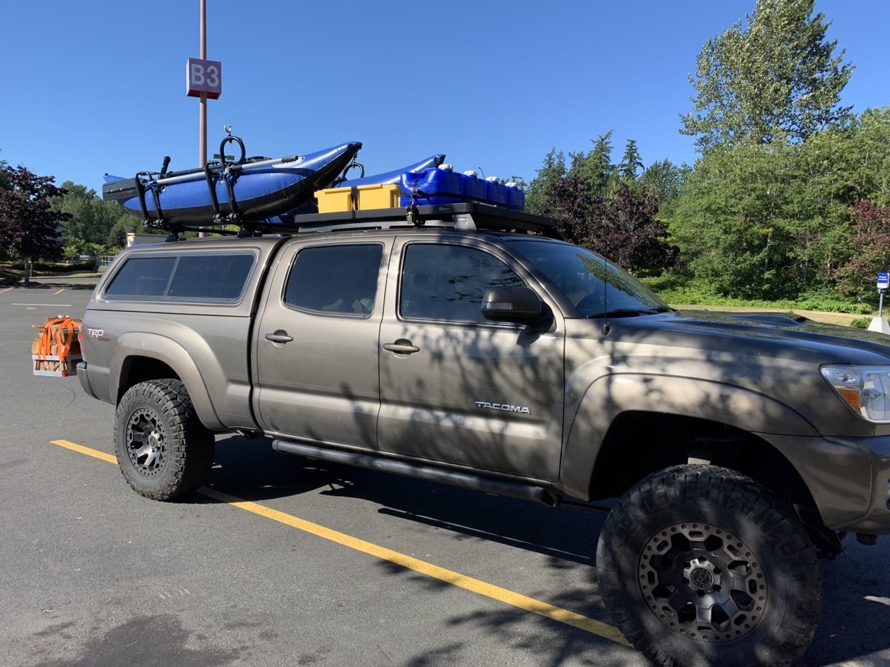

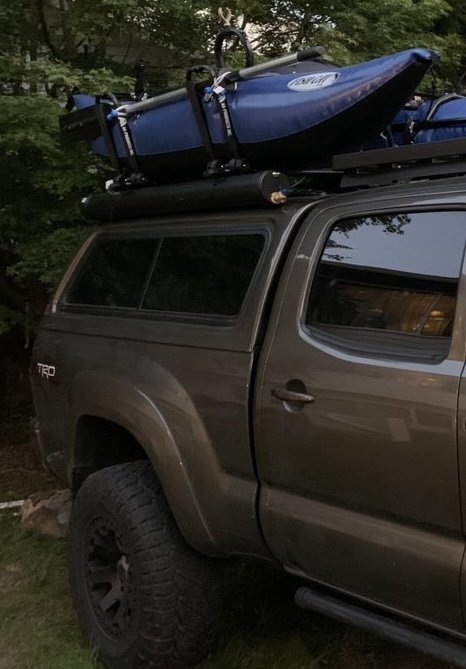

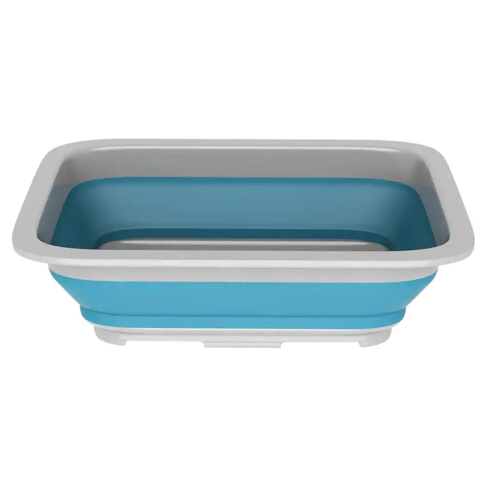

    I have 2 (one on each side) home built pressure tanks 4.5 gallons each. They attach under my crossbars.
    I also carry 16 (4x4 gallons) gallons of potable water on my cab rack. (Pressure tanks not in this pic because I built them on this trip)

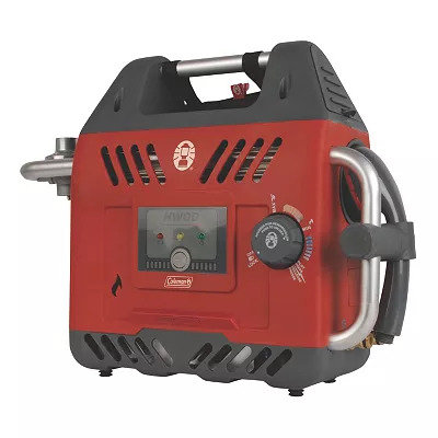

    I have a Coleman H2oasis instant hot water heater that I use as a pump and water heater. I have learned to recycle to hot water in a 5 gallon bucket by putting both the pump and sprayer in the bucket of cold water until it heats to maximum. Then I use just the pump to draw the hot water into a collapsible bucket

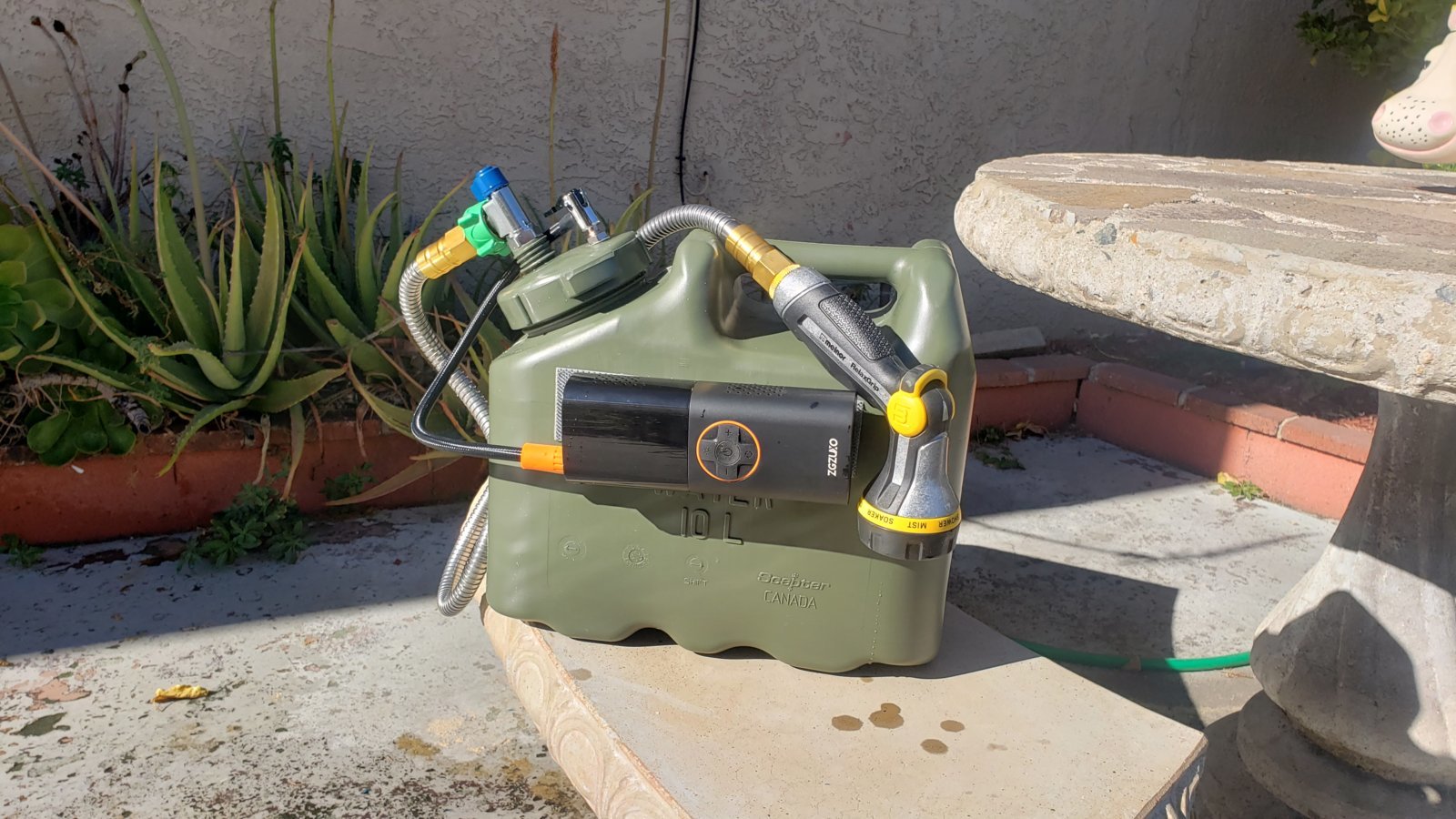

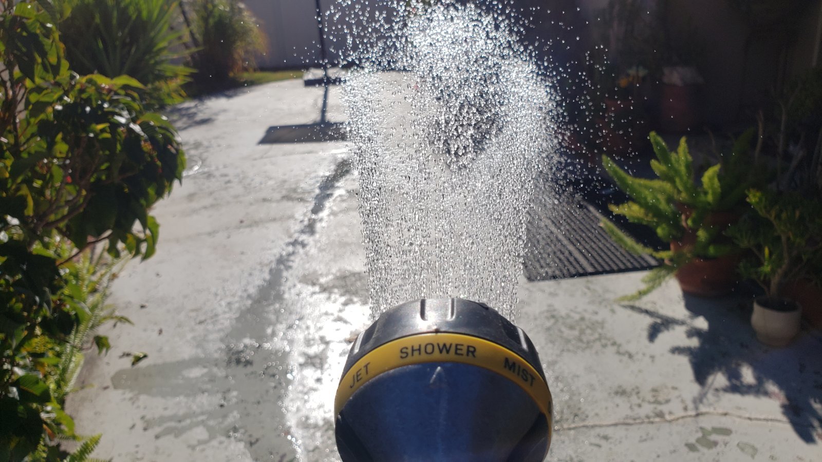

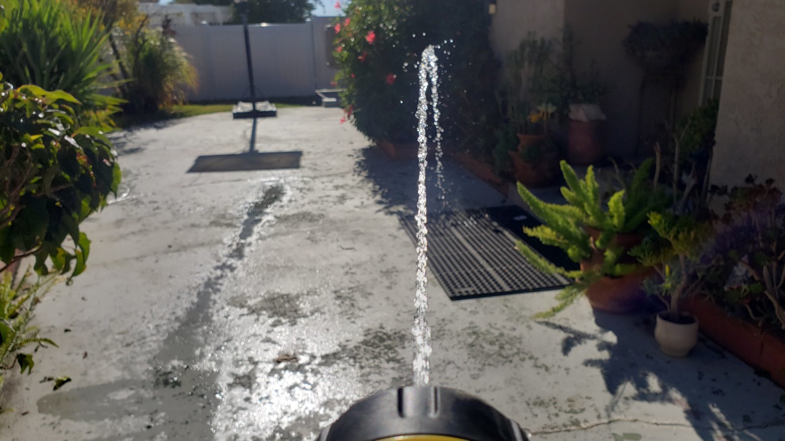

    Here's mine . With the rechargeable pump, set at 17psi its perfect .
