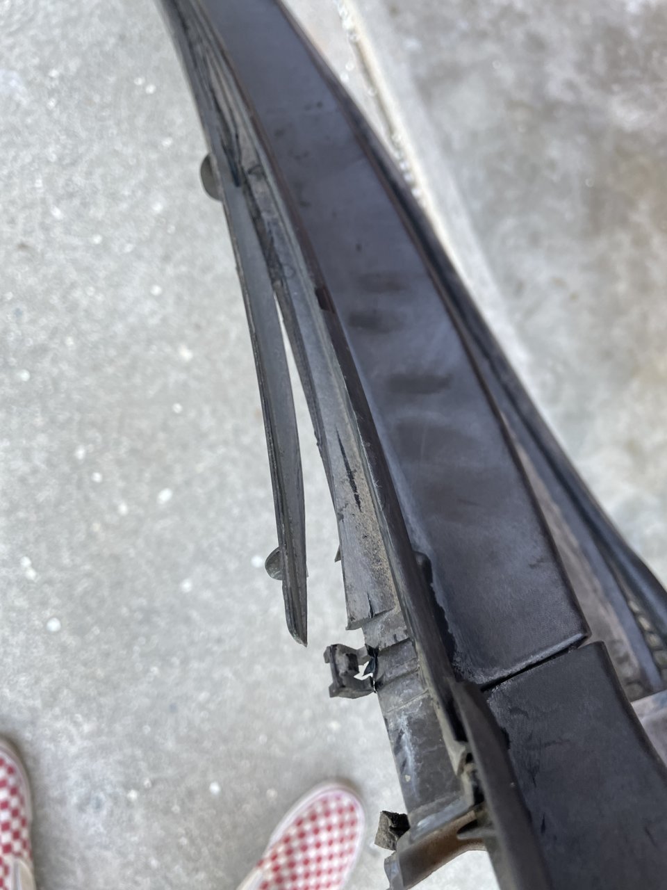

    Just got the windshield replaced on my 2015 and now I have this issue on the passenger side. Happens when I go through car washes.
    I think I’m going to try this fix before I get a new cowl.
    My question is- if the water is just being redirected, where is it being redirected to? Is there a drain for it to exit near the firewall?
    I haven’t popped it off an inspected yet, I’m just trying to get a full understanding before i get in there and fix it.

    Okay- got it all figured out.
    Took it apart this morning and checked things out. Found the cause of the leak…
    The tech who replaced my windshield destroyed the cowl…
    I see how the dam/shield fix works now. I decided to hit the Toyota auto recycler for a cowl. $60 as opposed to $300 from Toyota…
    Installed, and works like a charm. Ran it through a car wash and got no leaking!
    If you’re in the Sacramento area- DO NOT get work done at Tigris Auto Glass.
    They’re total assholes. Refused to take responsibility for their error. Totally stone walled me with zero remorse. Said it wasn’t their fault and that the windshield isn’t leaking so it’s not their problem. They literally destroyed the cowl and and are claiming that it’s “not their problem”. Unreal…
