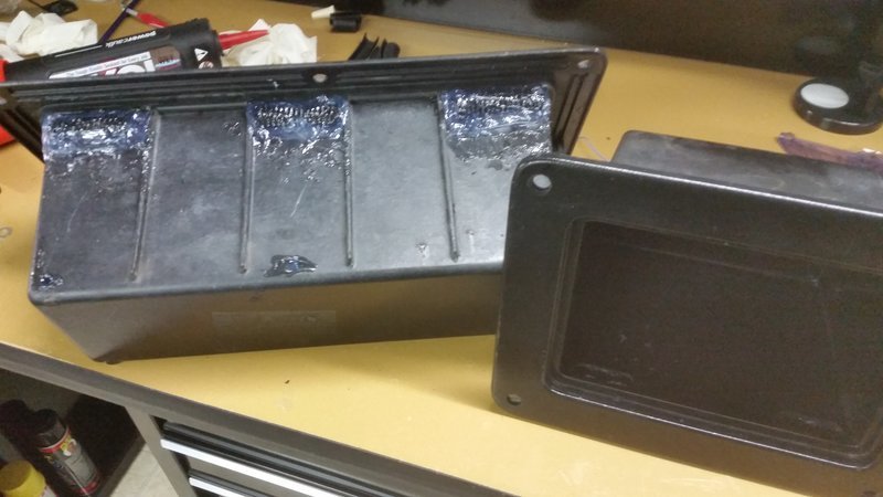

    I just finished fabricating inserts to silicon in the storage boxes on the top in the bottom to alleviate that point of entry. Ironically, at that time I also noticed that the electical outlet leaks water.... so I siliconed that.

    Interested on what you fabricated for the storage boxes.. do you have pics?

    Thanks all! I came up with a pretty elegant solution for the cubbies. I cut corregated cable management hoses in half (purchased from Radio Shack for $6.00) and siliconed them in. The 2 leaks in the front I wasn't able to get with silicon, the leaks are still happening. A friend recommended Flex-Seal, but I have to wait for it to get warmer.
