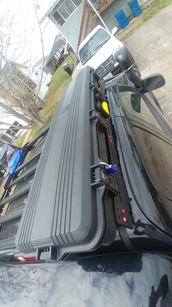

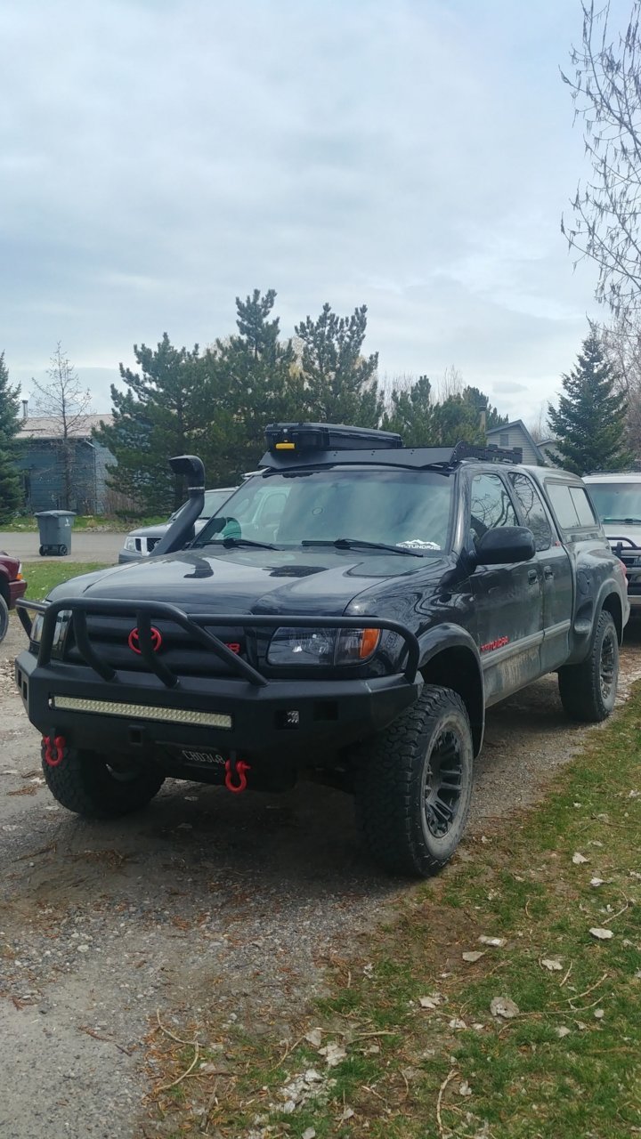

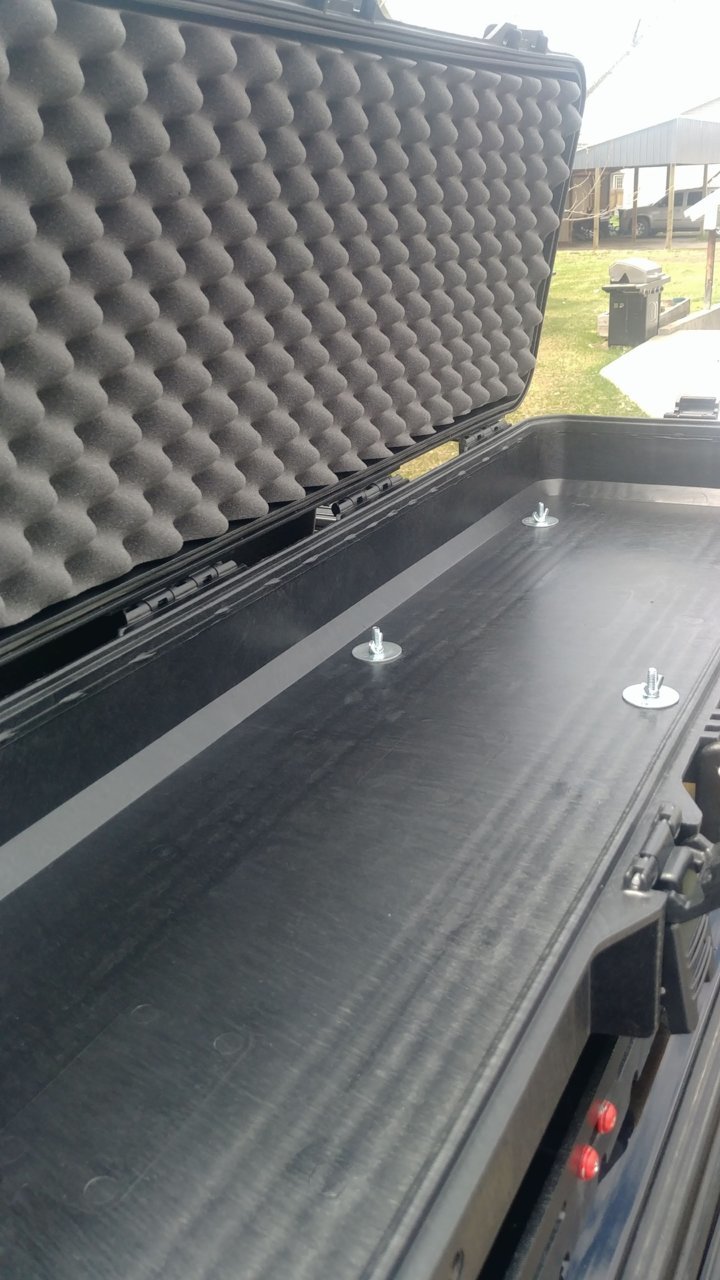

    Before I sold my Tundra and got into the Taco, I had a one-off roof rack based off the Prinsu rack. Mounted a 42" Plano case for tools and recovery gear. Buried the rear end one time :facepalm:and couldn't open the tailgate or topper so I'm glad I moved all that stuff up top when I did.
    1/4 20 carriage bolts fit perfectly into the 80/20 aluminum cross bar slots. I just drilled holes in the bottom of the case, threw down a fender washer, and used wing nuts for easier removal. Didn't do any kind of waterproofing as the holes were on the bottom and I never had any issues with it.

    I would worry that those bolts would tear apart anything soft packed in that box.
    If it were me I would use nylock nuts and cut the bolts flush to the top.

    They just look cool that's all. Ruining a perfectly good pelican case by driling holes in them.

    I kept the lower foam layer in place. Trimmed holes so it would still sit flush and the bolt heads never came through.
