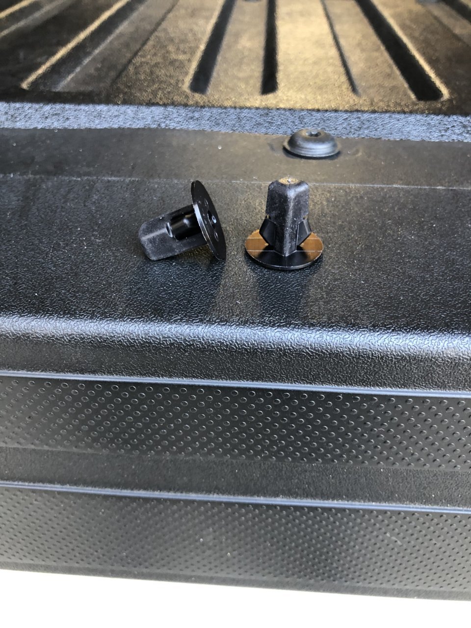

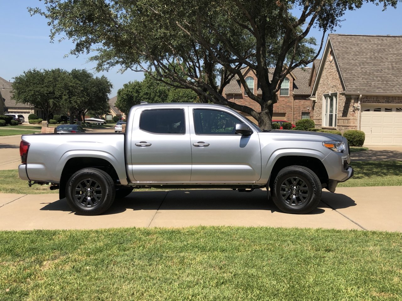

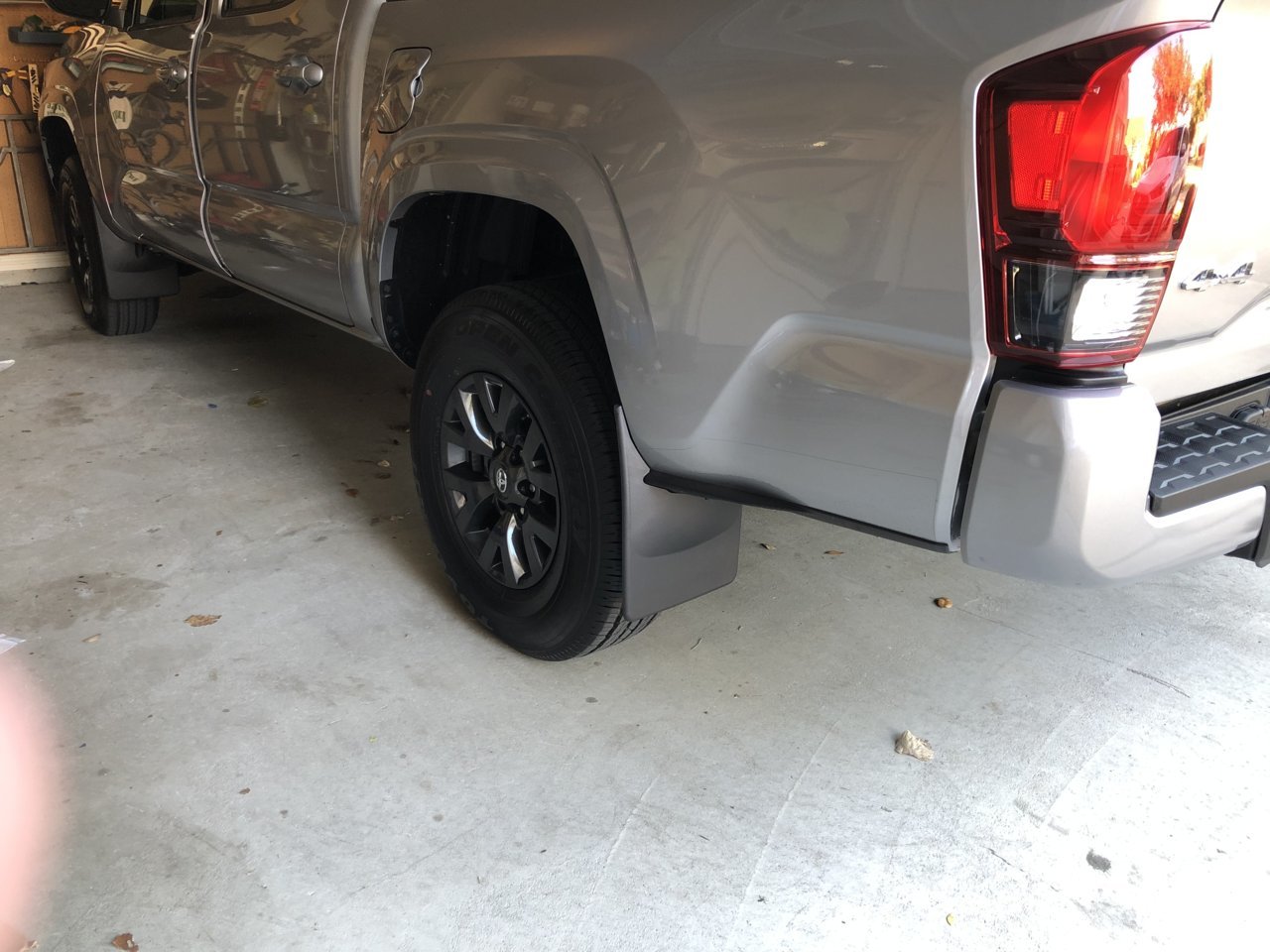

    Just a heads up....
    The front set of WeatherTech mud flaps, for SR Tacomas with no fender flares, does not include two needed grommets.
    WeatherTech told me that all hardware is included, it is not.
    You’ll need two $1.29 grommets,
    Toyota part number 90189-06236.
    The grommets insert at the bottom of wheel wells, in line with the indentations on the front mud flaps.7562FBBA-32B0-40FA-877E-DE18E3A2107F.jpg11F0796C-55AF-4D19-87FC-EADF071F8107.jpgF1D42FD3-ACA2-4A2C-8E0A-F7319C8AE380.jpg73B01B9E-CAF7-46E2-97E5-4C01A161F578.jpg
