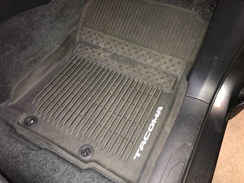

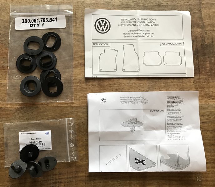

    Just as the title suggests, got my VW parts in. Completed project posted later.

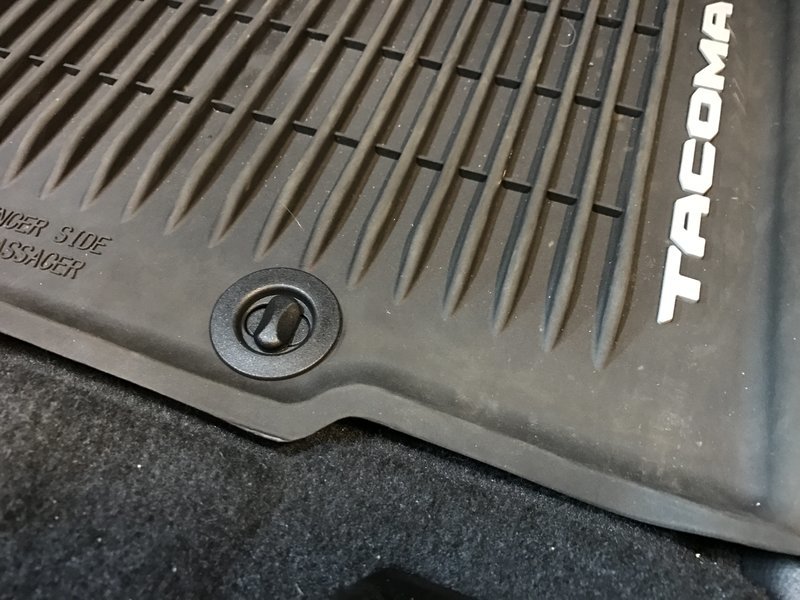

    Okay Done! Really easy mod. I ordered the parts off Amazon. Will report back how the work.

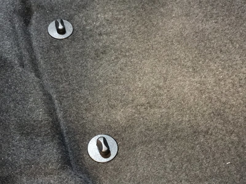

    How did you insert the carpet ones? Cut a slit like the mat?

    They have a sharp aggressive screw. I just marked the spot and screwed them in with no pre-drilling etc.

    Here are the links. I bought from the seller "Quickparts". Not Prime shipping but received in 4 days.
    Fixing Parts For Floor Mat Set VW Beetle Convertible Eos Golf 3D0061795B41 https://www.amazon.com/dp/B00AZZV79S/ref=cm_sw_r_cp_api_YP91ybHW1KSDY
    VW Volkswagen Floor Retention Posts Set of 4 GENUINE OEM BRAND NEW! 3D0-061-796-B41 https://www.amazon.com/dp/B00U0TKSZ8/ref=cm_sw_r_cp_api_8T91ybCX606JM
    Alternatively your local VW dealer can order them but I believe my quote was a tad higher than Amazon.

    These are the factory all weather mats from Toyota. Also, these are the newest version with the added suction cup things and they still move around despite what others have said.
