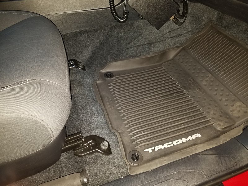

    Definitely the best mod i've done so far, cost me about $25 and took about an hour total but that floor mat being shoved up anytime rode shotgun was driving me nuts.

    How did you cut the hole in the mats?

    Myself I used an X-acto knife, it cut through it pretty easy.

    Same here. Used a razor knife and a cap as a template and cut around it. Was easy.

    and...here's the VW parts and links given by @tacopromatt in post #24 of where to purchase:
    Floormat Screws: https://www.ecstuning.com/ES348762/
    Floormat Securing Hardware: https://www.ecstuning.com/ES348755/

    Yeah definitely start a little smaller than you think with the holes in the mat, then trim as needed for a snug fit

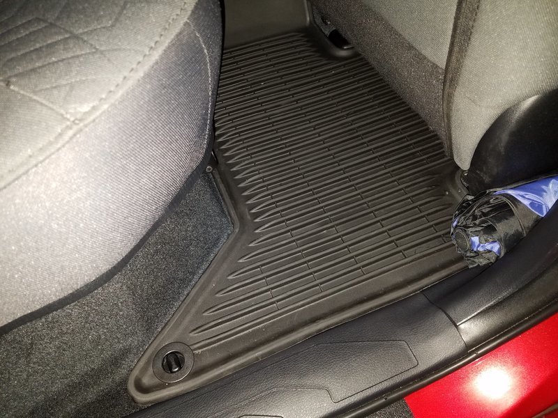

    I didn't think about putting the extra pair on the back mat, might have to steal this.
