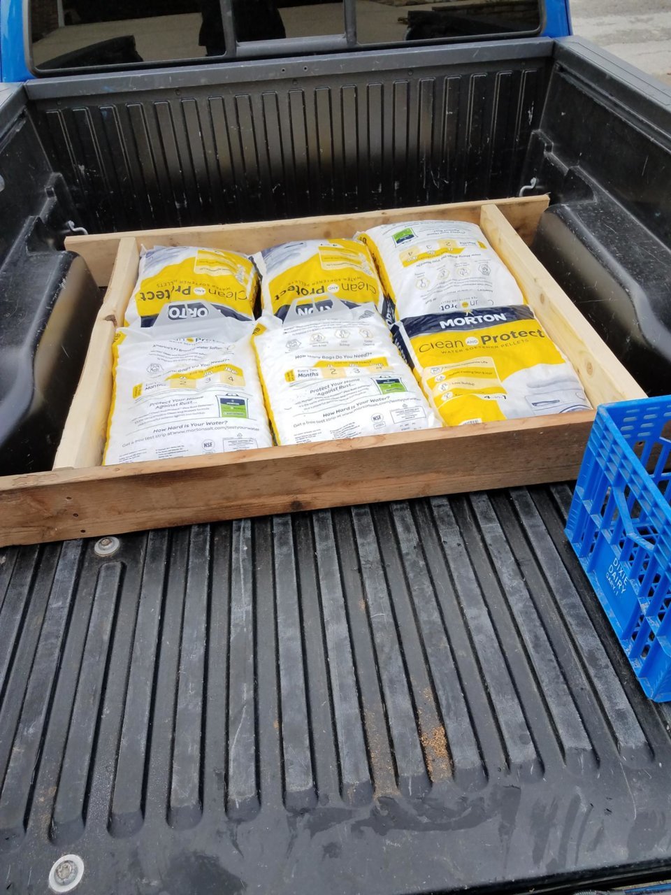

    That "ballast box" pictured above, is the most common way that I see people put sand or salt in the back of their truck and it's easily removable and works great.

    If you do use ballast make sure it is well strapped down, even the ballast rack, if you use sand or salt bags cut a slit in the top so the contents don't come out easily but that the bag WON'T hold together if it became a projectile during an accident.
