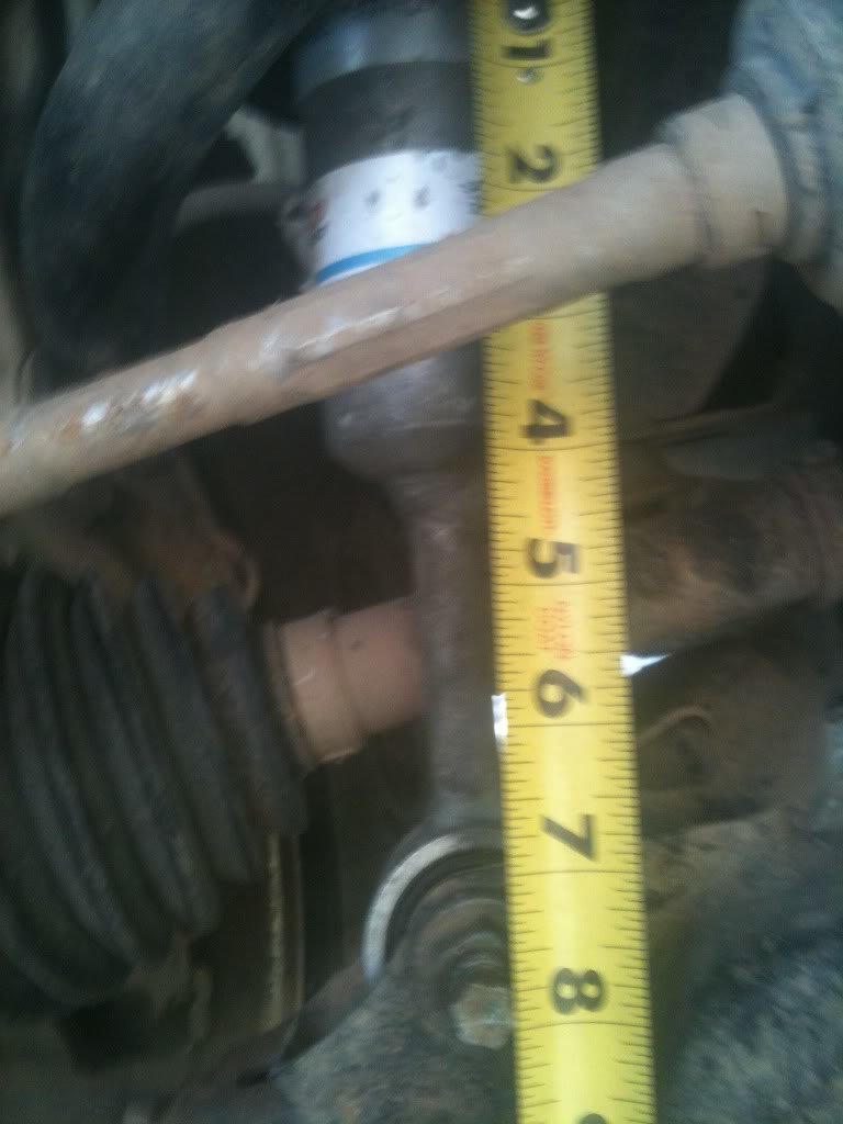

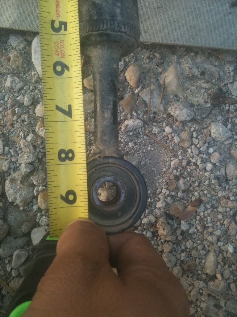

    so i just measured again and
    the stock shocks are 8.75" from the top of the spring perch to center of the shock eye.
    the 5100s set at 0 are 8" from center of spring to shock eye
    so i should be getting at least 3.25" of lift without the top 1/4" spacer.
    Anyone have the measurement of the ome shocks?

    check out stock vs 5100 set at 0
    how can they call 0 as the stock height. .85 should be the "stock setting"
    Can someone measure their OME shocks?
