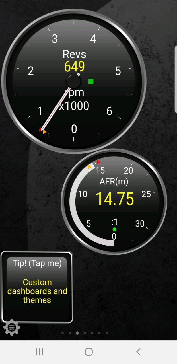

    Obd2 at idle

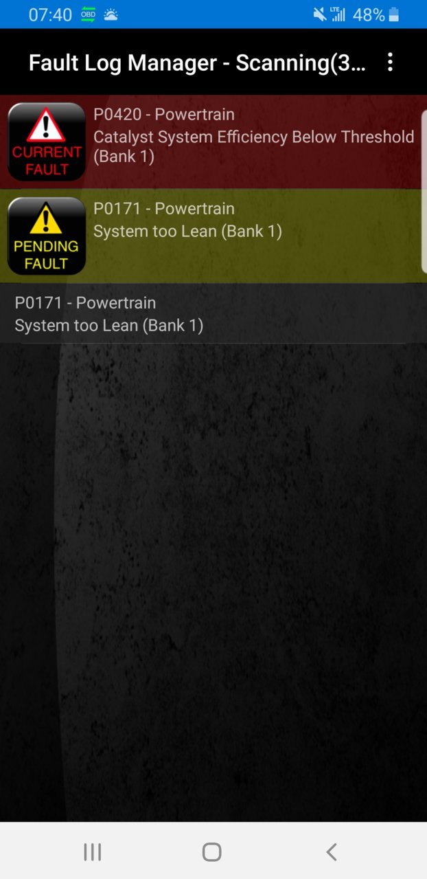

    T4 I'll post another here are the fault codes

    Following as I have a similar noise and just got the same code (lean) twice. My noise isn’t as bad, but I have not been able to isolate it yet.

    do NOT trust the Torque code definitions - look up the codes in Haynes/Chilton manual - I had a P0140 that Torque said was a MAF sensor that was really an O2 sensor according to the Chilton book.
