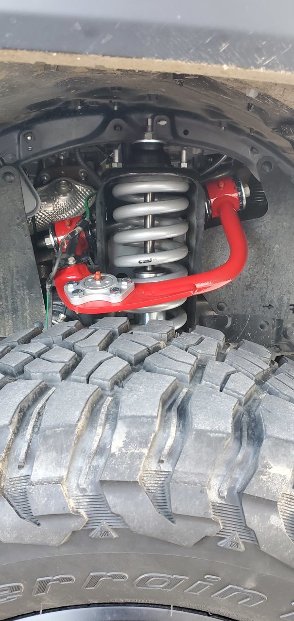

    Yeah IVD joint noise makers bad choice for the desert you can try CRC PTFE dry lube but it won’t last. If it were me I’d go SPC or JBA won’t look as cool but nice, quiet and just as strong...Good luck
