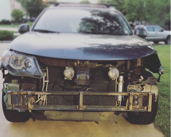

    Yeah, exactly. I'll get a picture of some of the welds up close when I get home. I know they're getting through on the stock vehicle metal because they were burning/cooking the paint on the other side. As for the barstock and the angle iron that I bought, I can see the heat marks on most of it. When I shake the bumper the whole car moves. I can even wail on it with a hammer to knock the slag off and join some seems closer for future welds, but some of these welds are ugly as sin. haha

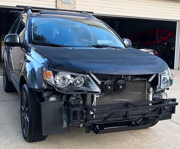

    FAILED!
    I've gotta make the "bumper" slightly taller. That's what I get for not measuring!

    Those welds did not penetrate. Smack it with a hammer and see if it cracks.

    I thought the same thing, but I beat the hell out of it and nothing cracked.
    As I've been going I've been getting a bit better. I also switched extension cords to a thicker gauge and I've had much better results as far as flow goes.
    I wouldn't exactly bolt a winch to it, but its serving my purpose of being much sturdier than the stock, flimsy, sheet metal bumper.
