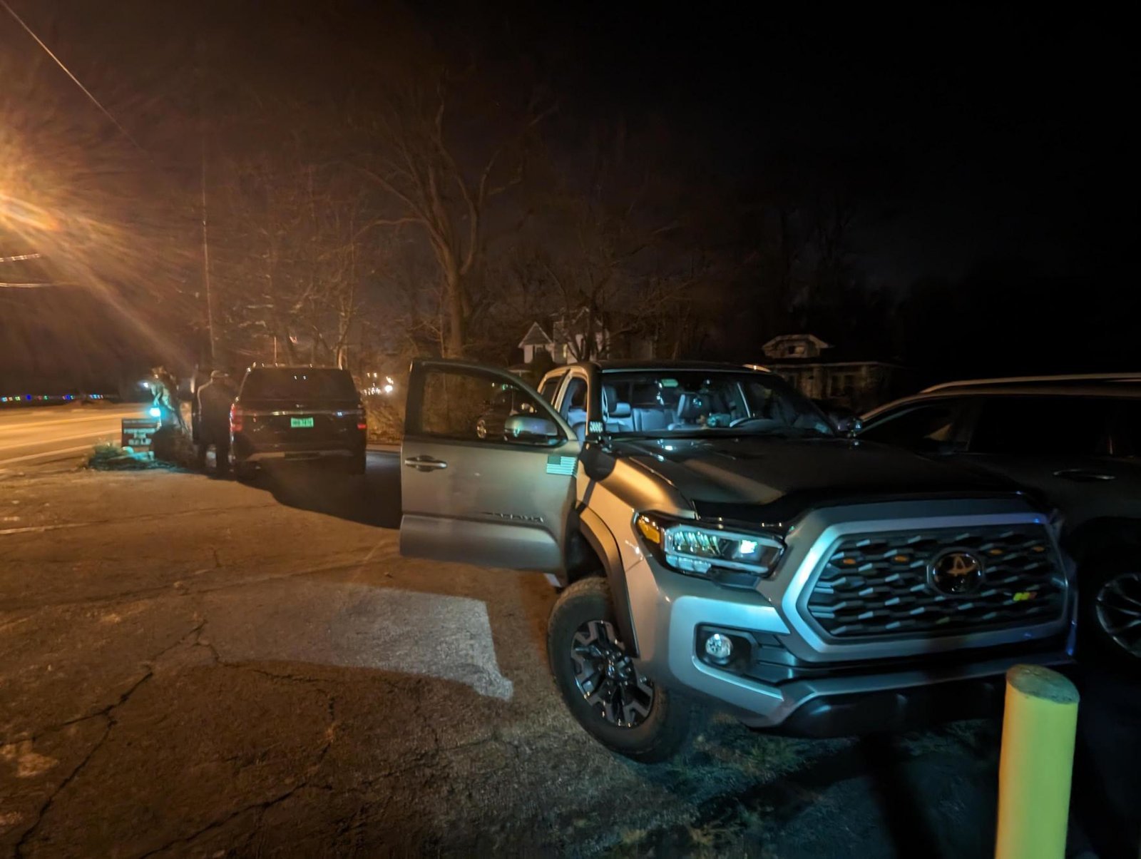

    So my 2023 Tacoma Offroad with 1800 miles got hit.
    Went to Cabellas with a buddy and he wanted to go to his bar. I didnt want to go. I dont drink but I havent seen the guy in a while so I went. Well Im sitting in the car and this woman with 3 friends walks out of the bar.. get in her 1990 Ford expedition.. and backs RIGHT into me. (To be fair she has no sensors cameras and it was a blind turn. You still should know where your bumpers are. (but I digress)
    So yea.. hit me pretty good. I have front and back dashcam. She said she will pay cash for all the repairs.

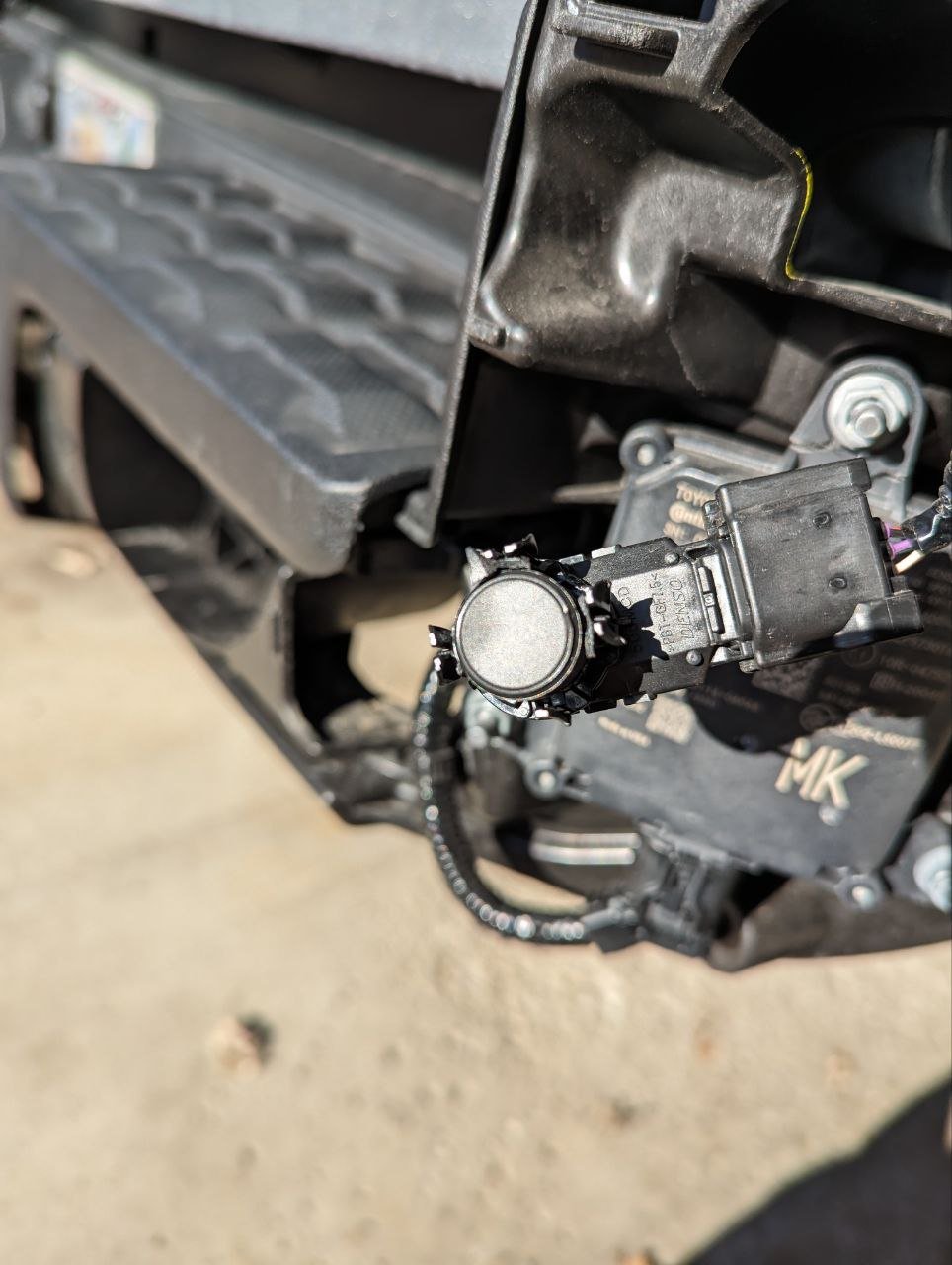

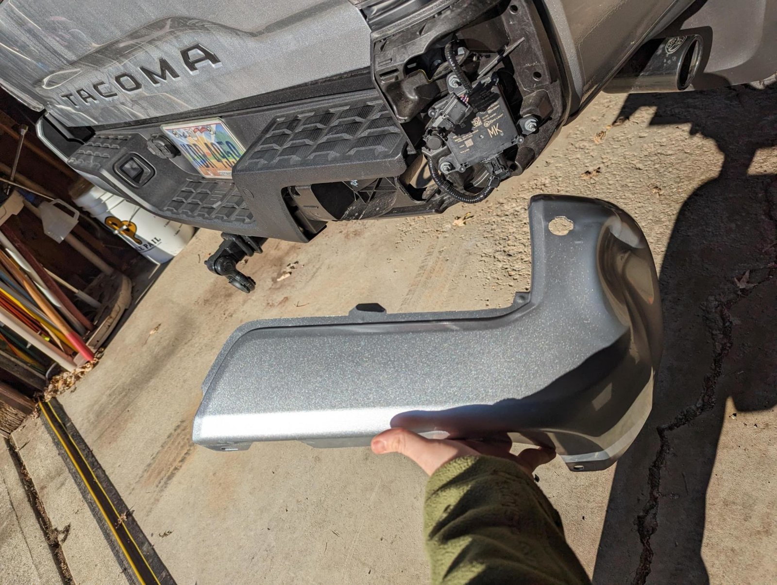

    So anyhow.. filed police report. (it wont be official unless I have a problem) I went and tore it apart. This is my first Toyota. I was NOT expecting that section of bumper to come off like that.
    5 clips.. and boom it came off.

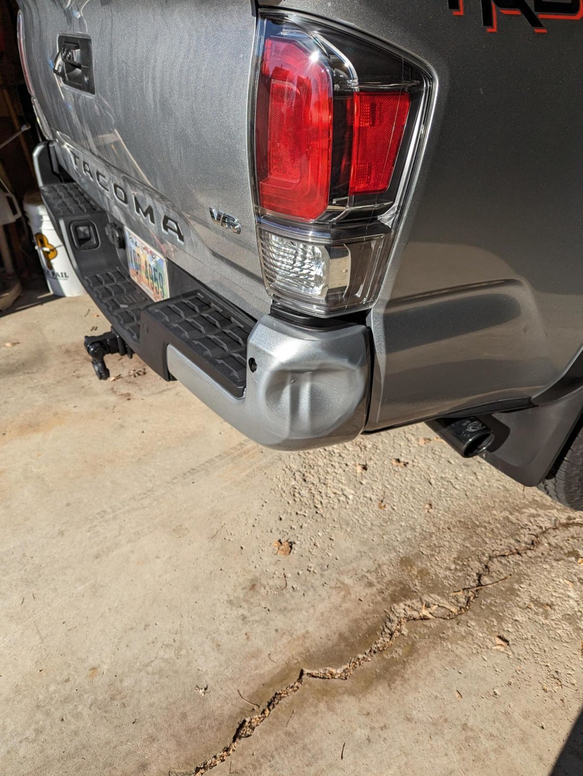

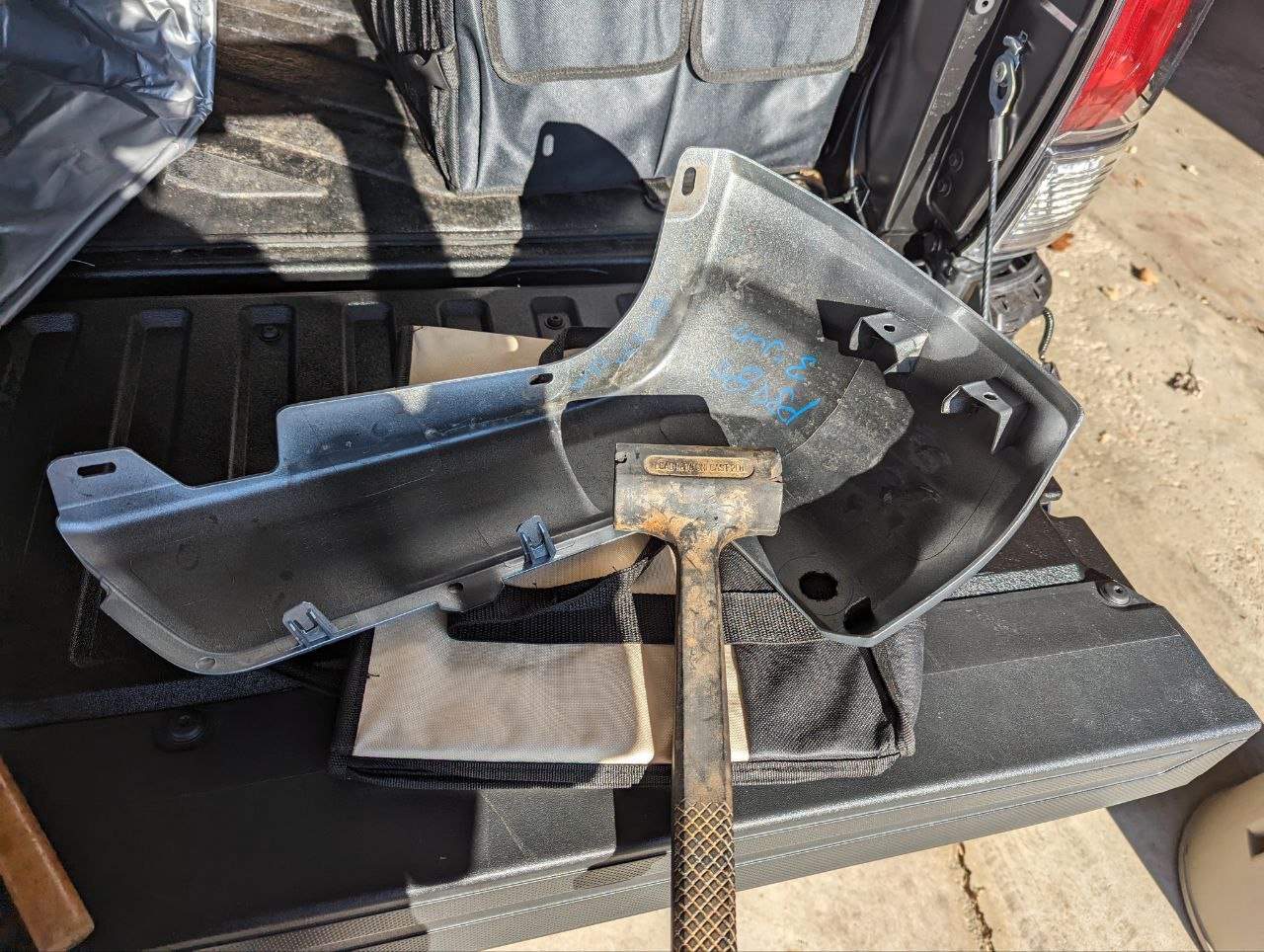

    flipped it upside down and hit it with a dead blow 3 lb mallet.
    Fixed it up pretty good.. almost perfect..
    If I did this and the truck was 10 years old.. I would have been done.. since it has 1800 miles and is 4 months old.. and someone else hit me it is getting fixed with OEM parts.
    Sensor clip also broke.. it is $223 for the damn sensor
    However any of the ebay clones you can take the clip off the sensor and replace that for 10-15 dollars. I checked it.. it works. I now have 3 extra clips.

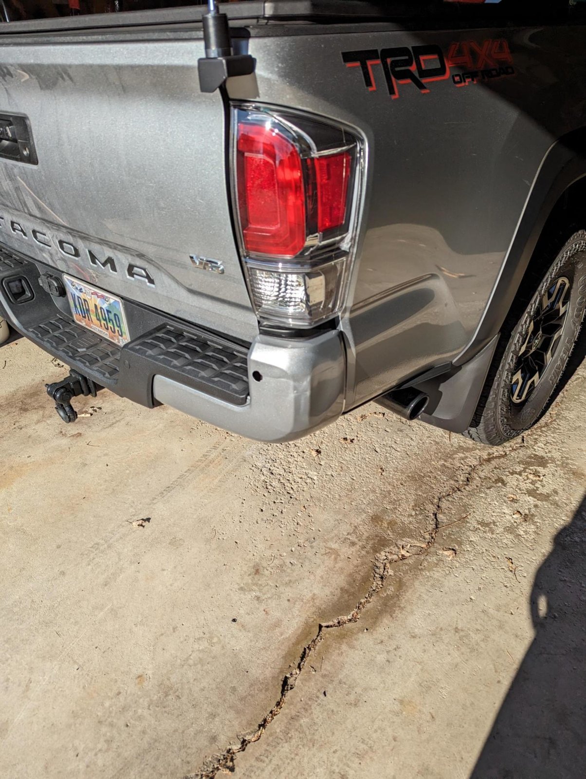

    Pounded out.. This pic looks worse than it does in person.. but it looks almost good.
    So yeah.. more to come.. I ordered a already painted OEM Toyota Bumper cap from Painted OEM parts out of Colorado. The OEM fender cap is ~150 and to paint it was another 90 dollars. So we will see how closely that matches. It should be here the end of this week and I get to put my baby back together.
