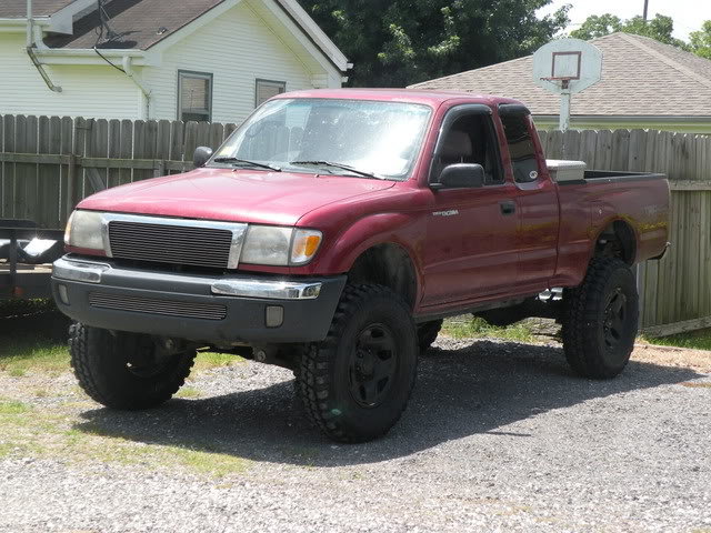

    Go 285/75/16's they fit on stock 16x7 wheels I promise, b/c I have mine on stock 16x7. And that size won't rub since you have wheel spacers already. Mine rub a small bit at full lock. You personally will notice a difference in driving, it will feel that you have extra weight which you do, but you should still get around 21-22 mpg's. It was different for me driving with them, but I got use to it quickly and they ride great.
    Just some advice, wider tires will pull hard when you hit bumps or ruts. Stick to skinny ones, 285/75's are 11.5 wide. I like them and I think they look great.
    My junk (note that this is also with a 1" body lift so the tire doesn't rub to much when it's stuffed in the wheel well):
