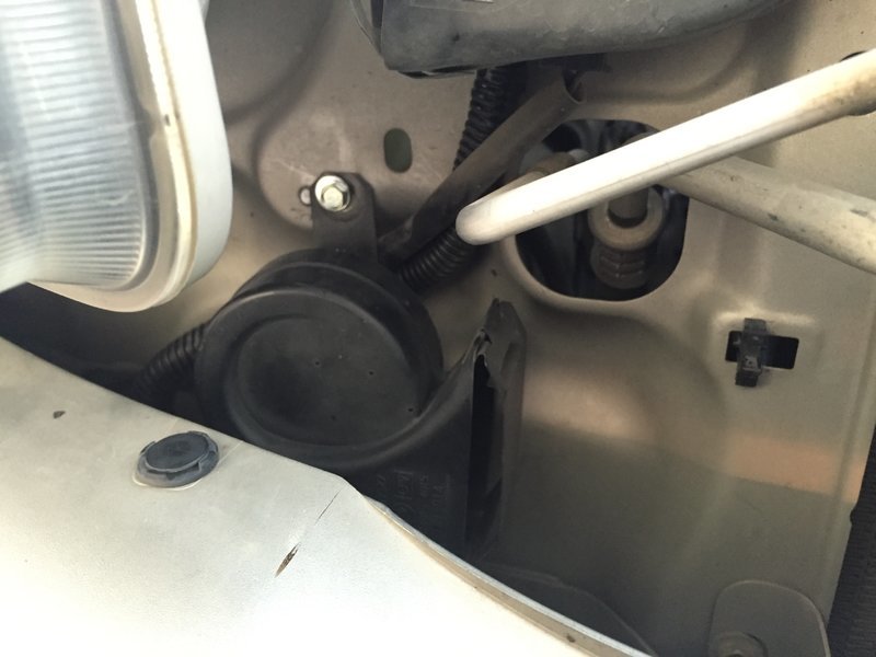

    Install was easy. I had to remove 1 of 2 horns.

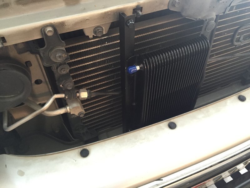

    Well it is installed, and I have to say the difference is very clear. I was not towing so I cannot compare the temps there (don't own a trailer, when needed u-haul it is) but from what I can see it is easily 20-30 degrees lower depending on where/how it is driven. I pretty much copied Zero4's install since I liked the way it looked and bought more hose from AutoZone (at $1 per foot it was a no brainer) and instead of using a coupler on the return line I ran a new line from the trans cooler to where the old hose terminated so there are no couples at all. Had to add one quart of fluid on the dot (used the Toyota Type IV stuff) and she runs like a champ. I am thinking I am going to go rent a 6x12 from u-haul just for the heck of it to haul it behind and see what the temps do plus (and I may be in the minority here) towing a big trailer is manly :). Pics attached, forgot to take pics of the installed with the hoses but they have been ran like Zero4 did through the AC condenser hole. Horn was relocated to the behind the passenger headlight with some wire extensions.
    --Dan

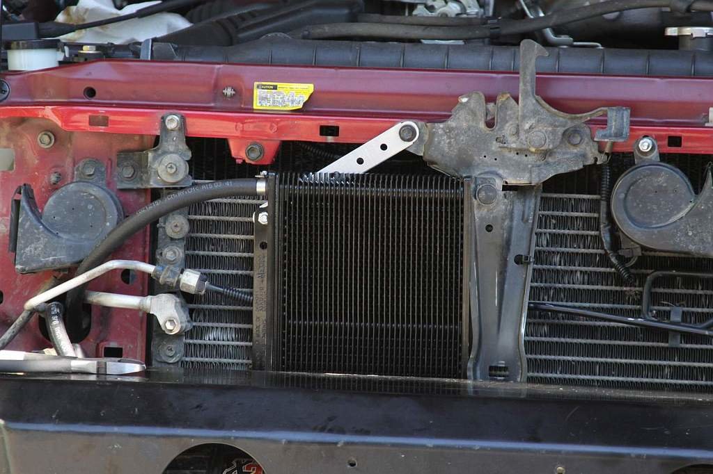

    So our Toyotas have a Trans cooler but it's not as good as an aftermarket one? In the last picture above that @DestroyerLite posted, my truck has the smaller cooler w/ a hose coming out of the bottom of it that says trans fluid on the hose. Then behind that is the radiator. Probably a stupid question. But you guys are putting aftermarket coolers on cause you're towing and the stock one isn't good enough?

    From what I have read the trans cooler that is built into the radiator is just good enough for the truck itself, and I can confirm this as in Texas (where a cold front is in the 90s) my trans temps would get close to 200 even without towing anything, and if I hitched up a trailer 230 or so was pretty common. That just seemed pretty high to me, plus with home improvement a trailer gets hitched to my truck quite often. I am not sure I would still tow long distances with this truck but for the semi short trips here and there a trans cooler is a nice safety net in my opinion.
